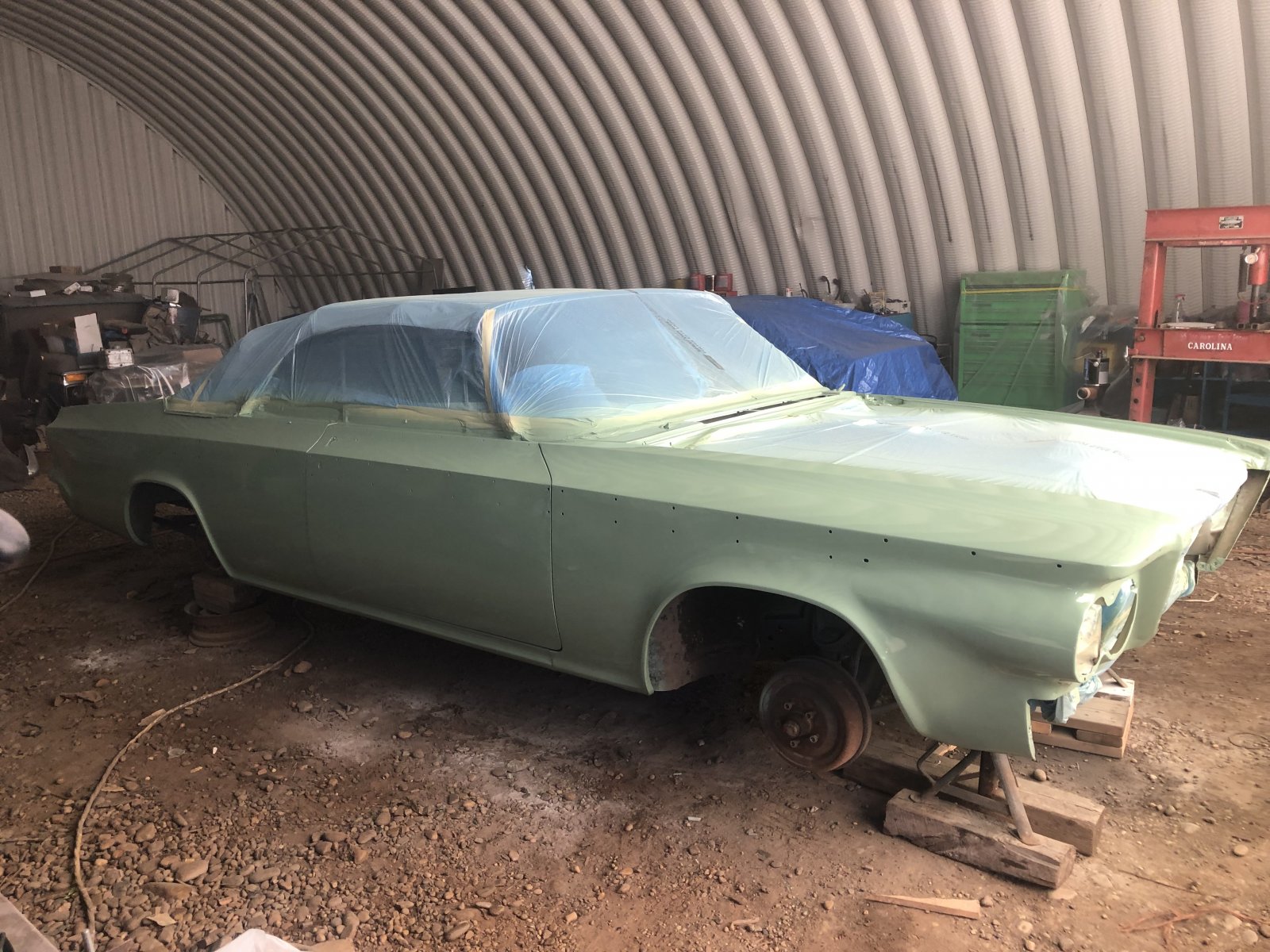

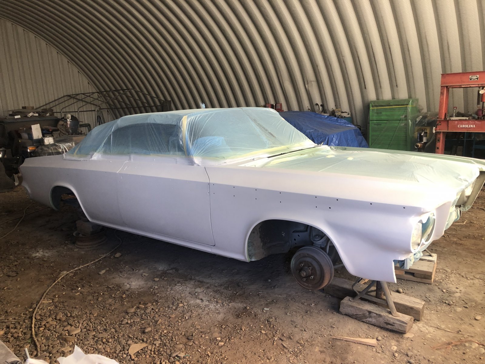

    F57E9839-583E-465B-9771-6A1786AB97FB.jpeg 983D6D3B-B2CB-428B-A2CE-0A90F90DE442.jpeg F57E9839-583E-465B-9771-6A1786AB97FB.jpeg

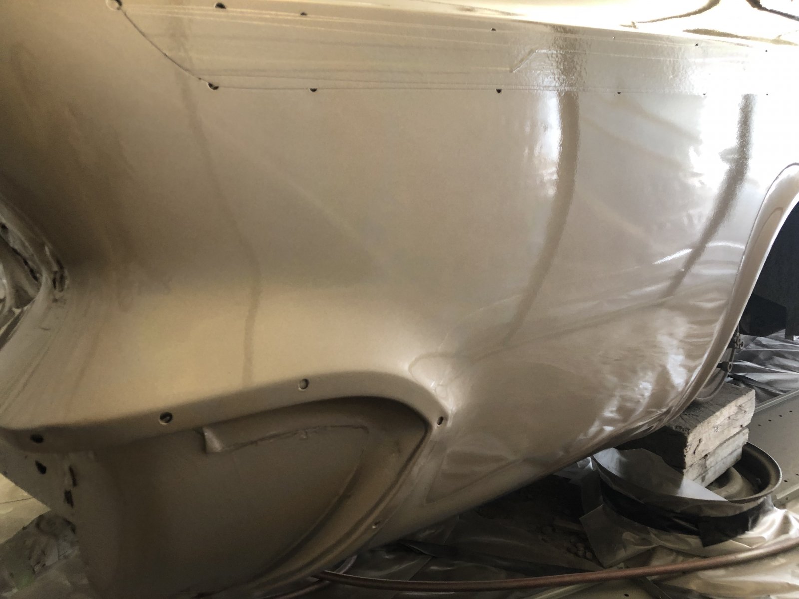

    Epoxy sealer, high solids primer in an hour…

  7. What type of primer ya using.
    Brand and urethane? Polly? Other?
  8. 57 Fargo
    Joined: Jan 22, 2012
    Posts: 6,194
    57 Fargo
    It’s Endura, mainly used for industrial equipment, since the bulk of my painting experience is industrial, I’m comfortable spraying it. The sealer and primer are urethane and their top coat is polyurethane. It’s reasonable in price and tougher then hell. Wouldn’t use it for a show car but for a driver it’s fine, it’s what I put on everything.

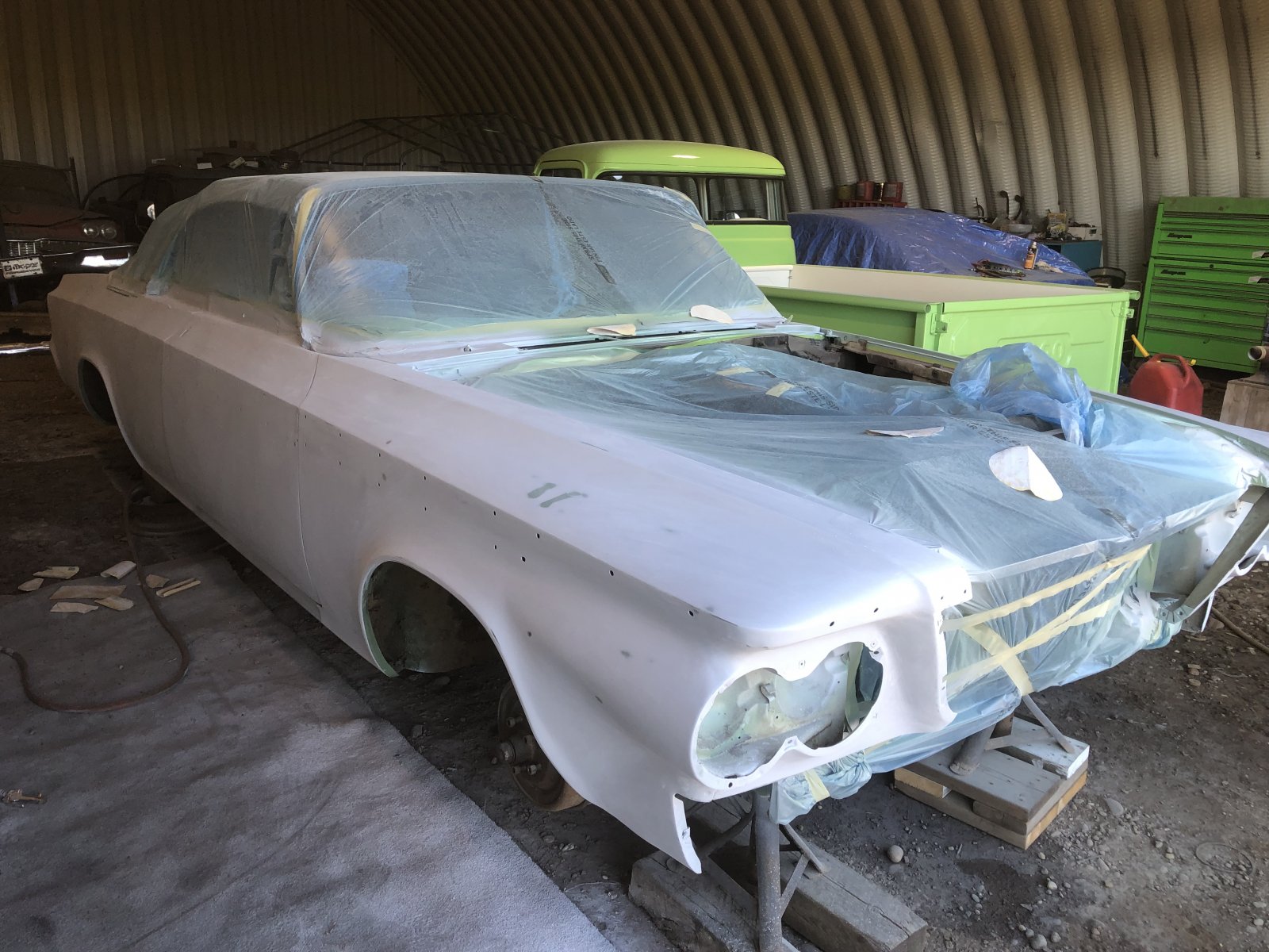

    Primer.
    the dumb schmuck get ready to spray it. So far I only see one spot that may not block out…

    57 Fargo
    car is blocked, as straight as it’s getting…
    1FBD5129-BC63-414C-81EE-8032747DA4BE.jpeg 452C2A75-D05E-4725-A2F2-694233380E42.jpeg

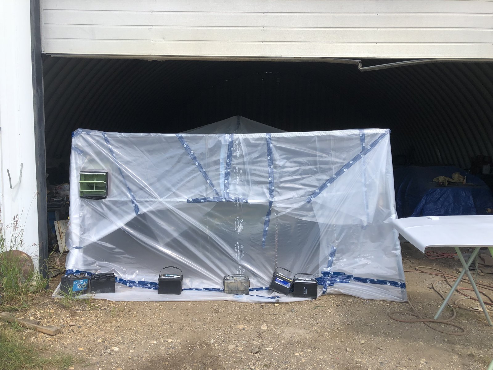

    Built an epic paint shanty!! Since when is tuck tape blue? Must be the taillight company’s complaining…anyways, painting has begun, gold base is on for the stripe, more to come, depending on outcome…

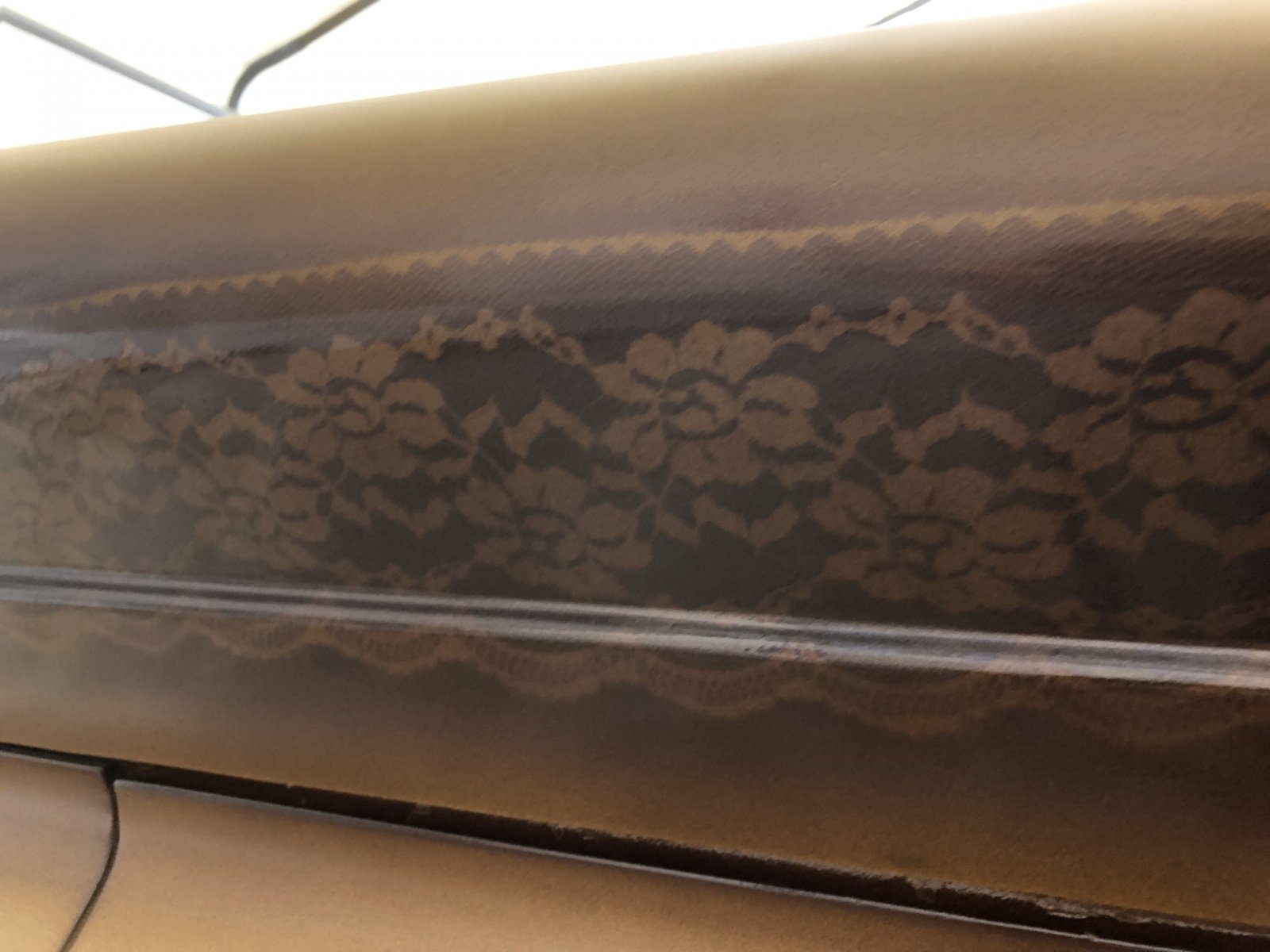

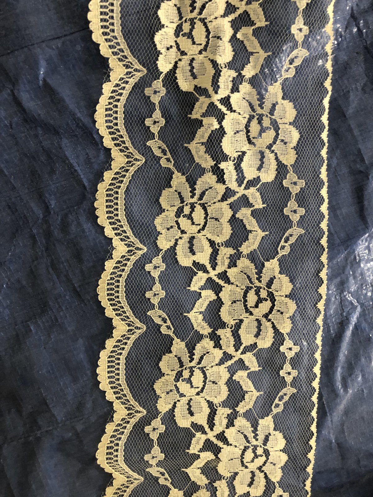

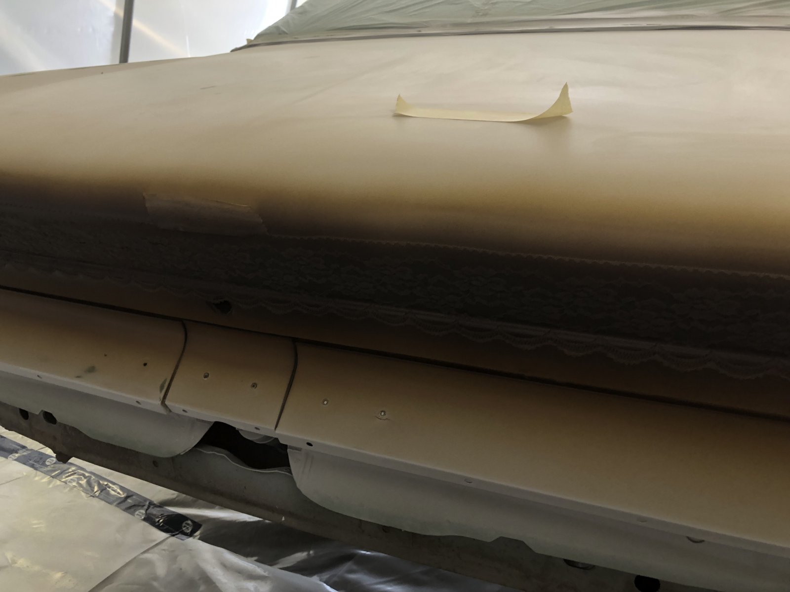

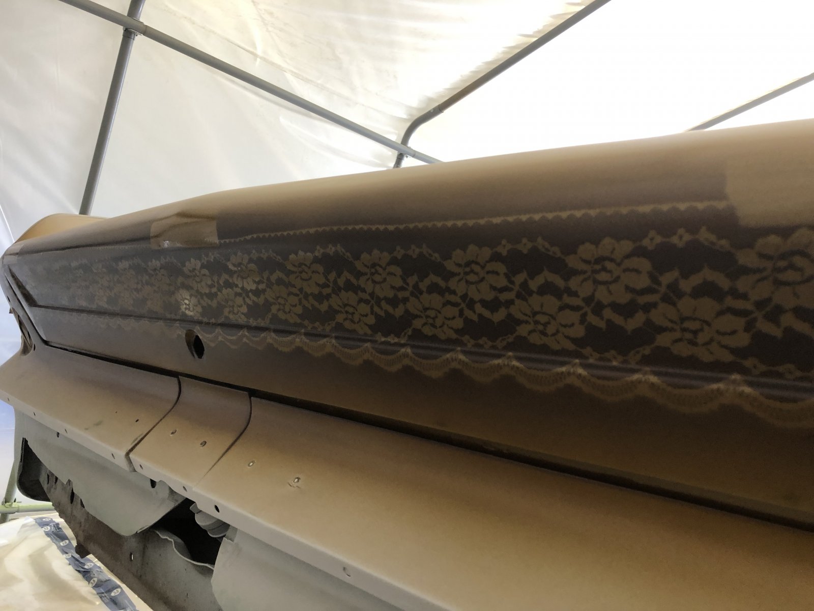

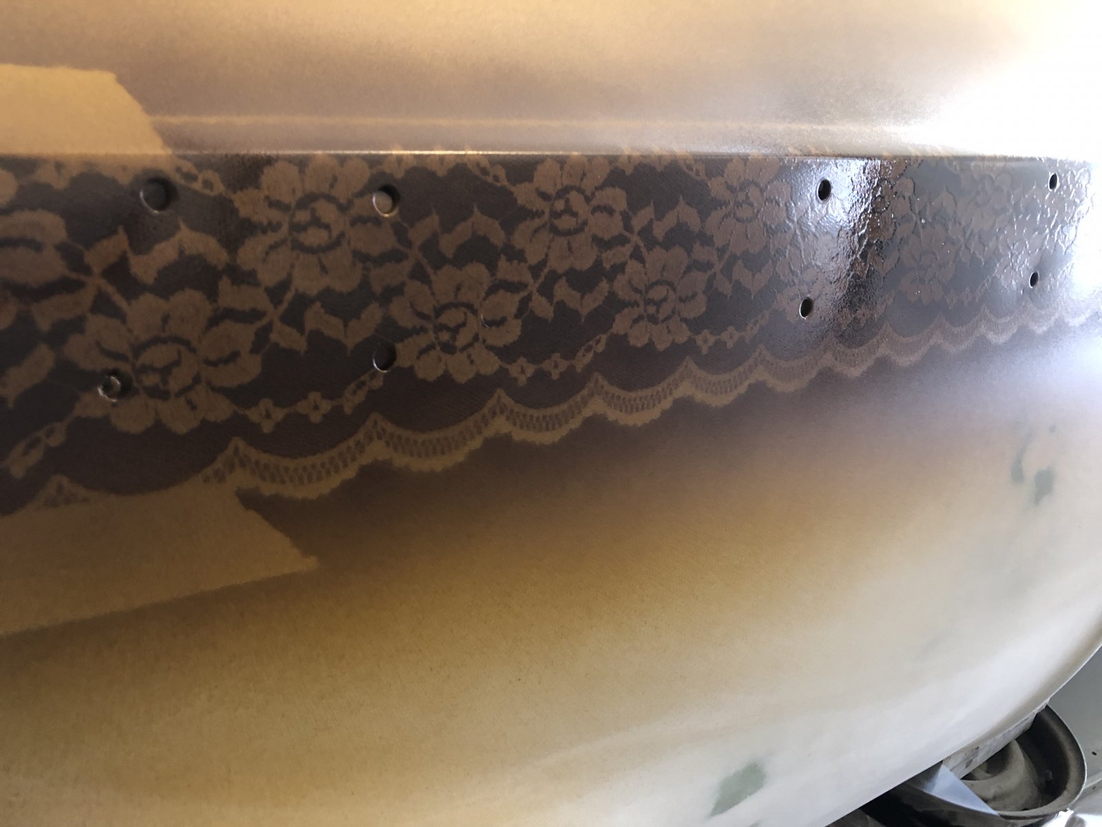

    So for once something actually worked….I think…since I left the trim I thought I would do something fun for the stripe, the interior has brown so I brought that into the stripe. Decided to try something I have never tried before.
    Found this. Put a gold base down. Let it dry until it was tacky and stuck some lace to it.
    Did a panel on the trunk as well.
  18. 57 Fargo
    Posts: 6,194
    57 Fargo
    Peeled the lace off after the brown set up a little.
    mixed up some poor man’s kandy, clear tinted with the brown, took the bite out of the gold.
    88CB9B7E-5DC8-449A-BF40-86C33BE24491.jpeg 4CA89CA5-2C5C-4D30-936F-25D436058216.jpeg D2414942-D236-485B-8FB3-725645A7F275.jpeg
    Now mask the stripe hopefully tomorrow and spray the rest.

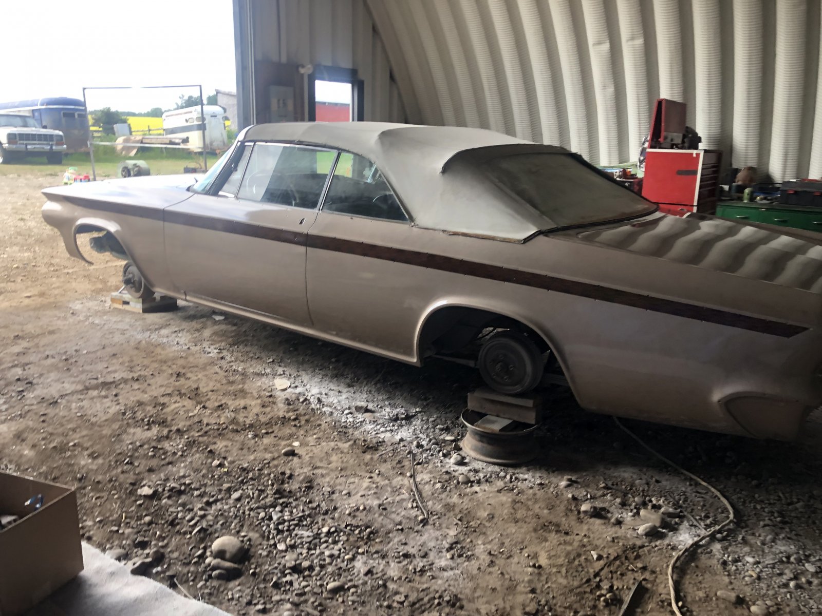

    Three coats of paint on it. Hard to get a decent picture… 4E4BC603-27E0-437F-B408-089EB953EF4D.jpeg
