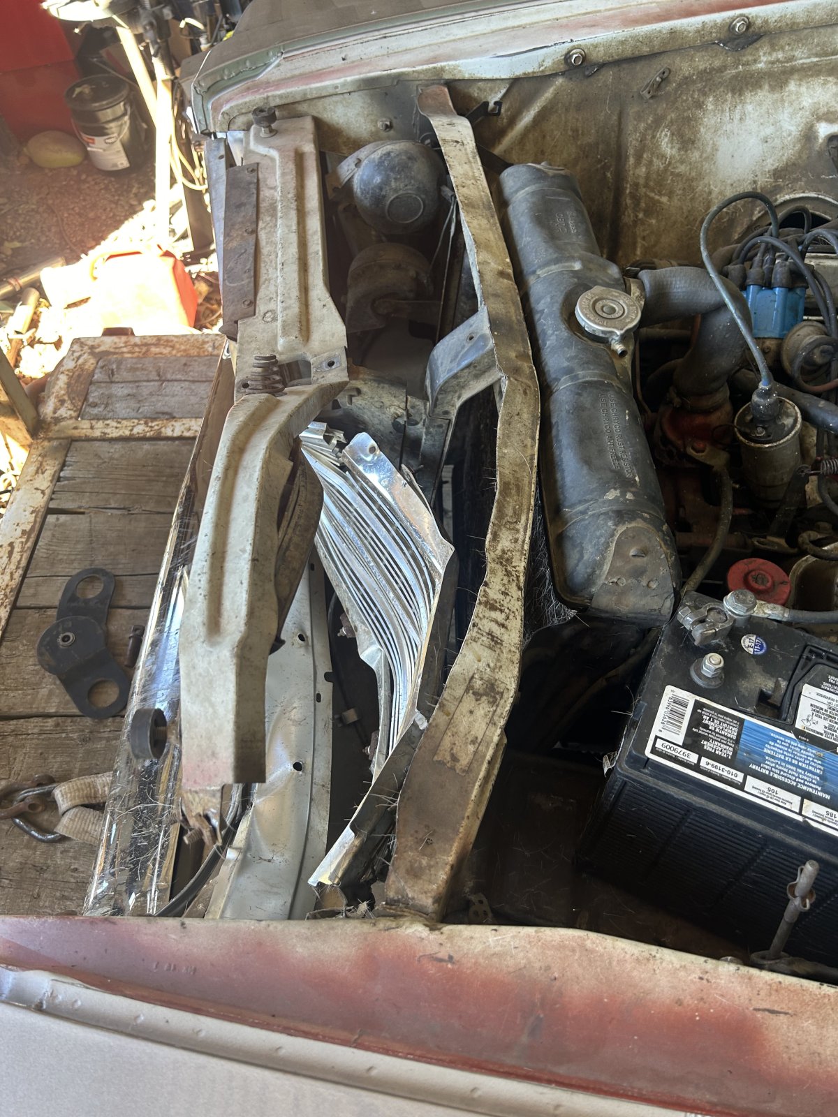

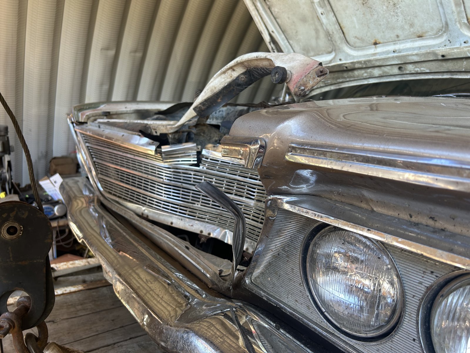

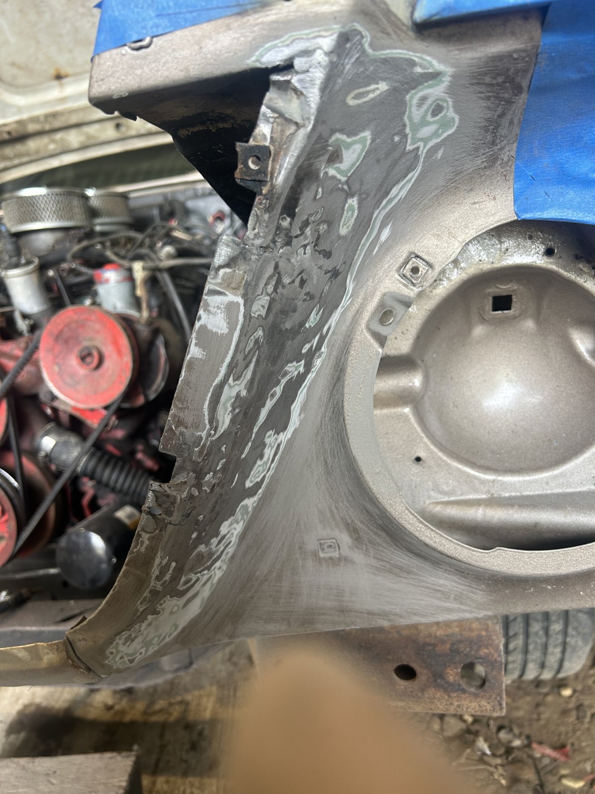

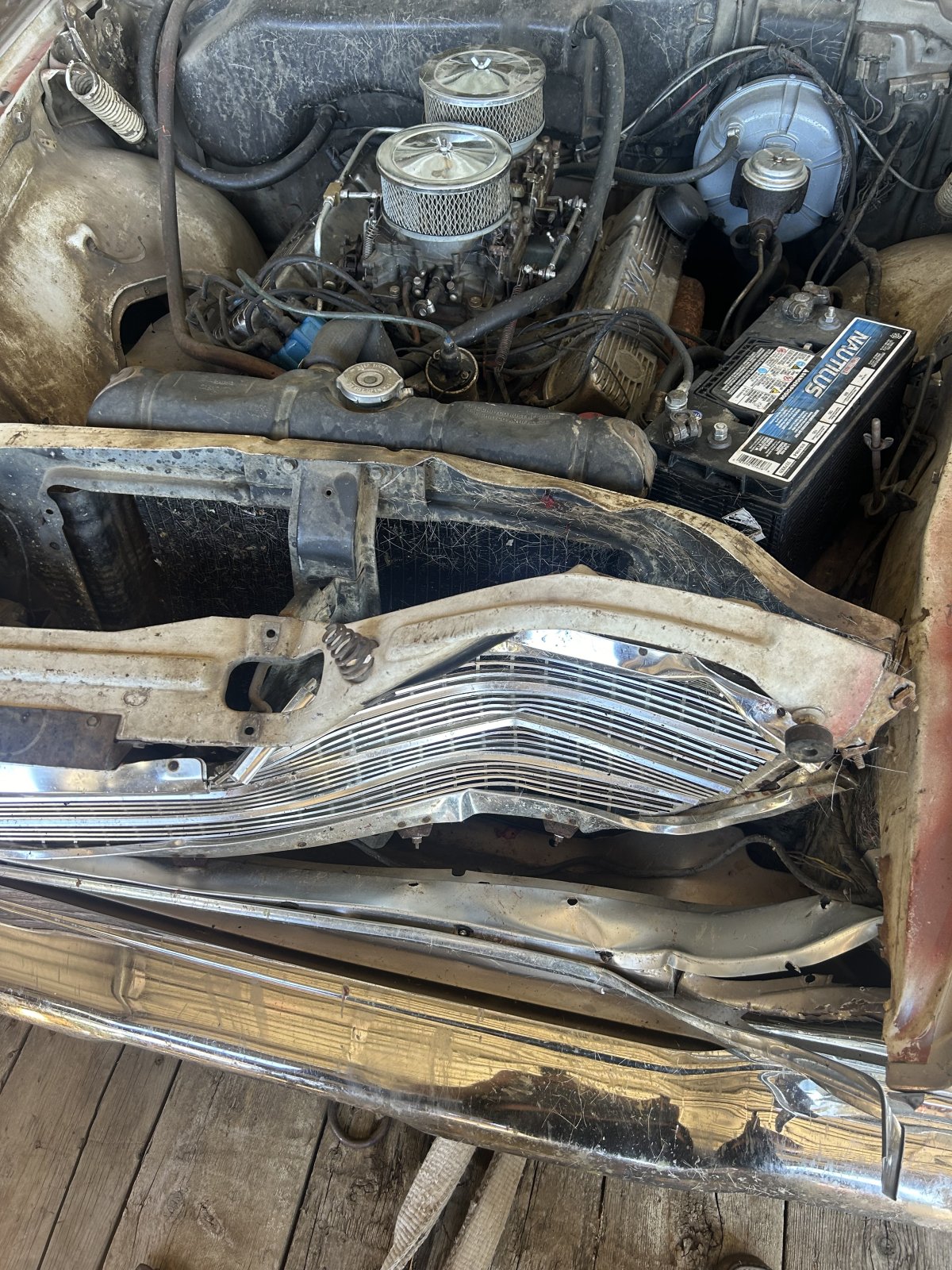

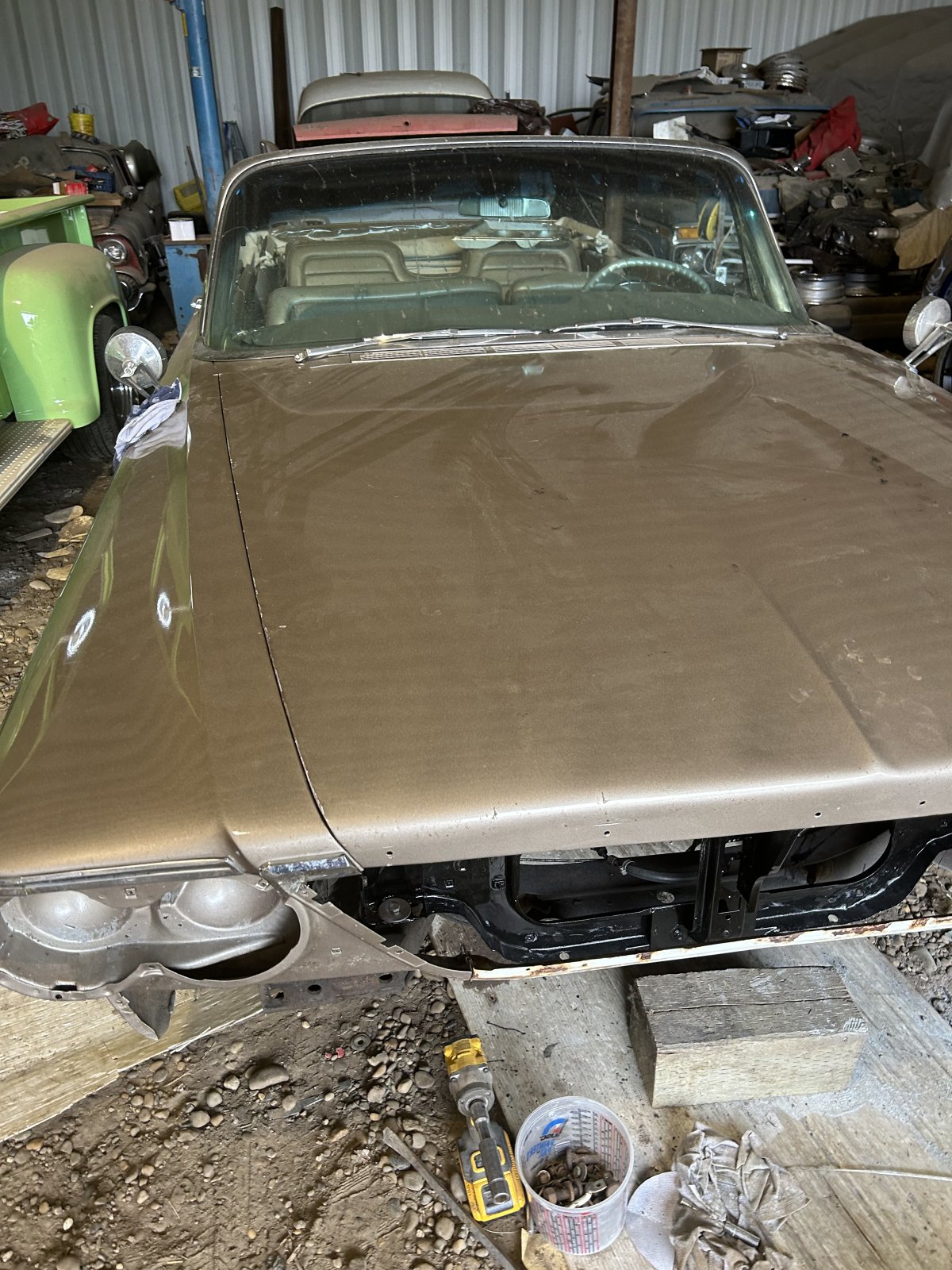

    Well here’s an update I suppose, so far if you are keeping track I hit a deer with my Fargo last fall, I’ve been knee deep in a Barracuda project which is mostly finished. So I finally had some time to drive the big Chrysler to work.
    Yup you guessed it…another deer….
  9. 57 Fargo
    Joined: Jan 22, 2012
    Posts: 6,181
    57 Fargo

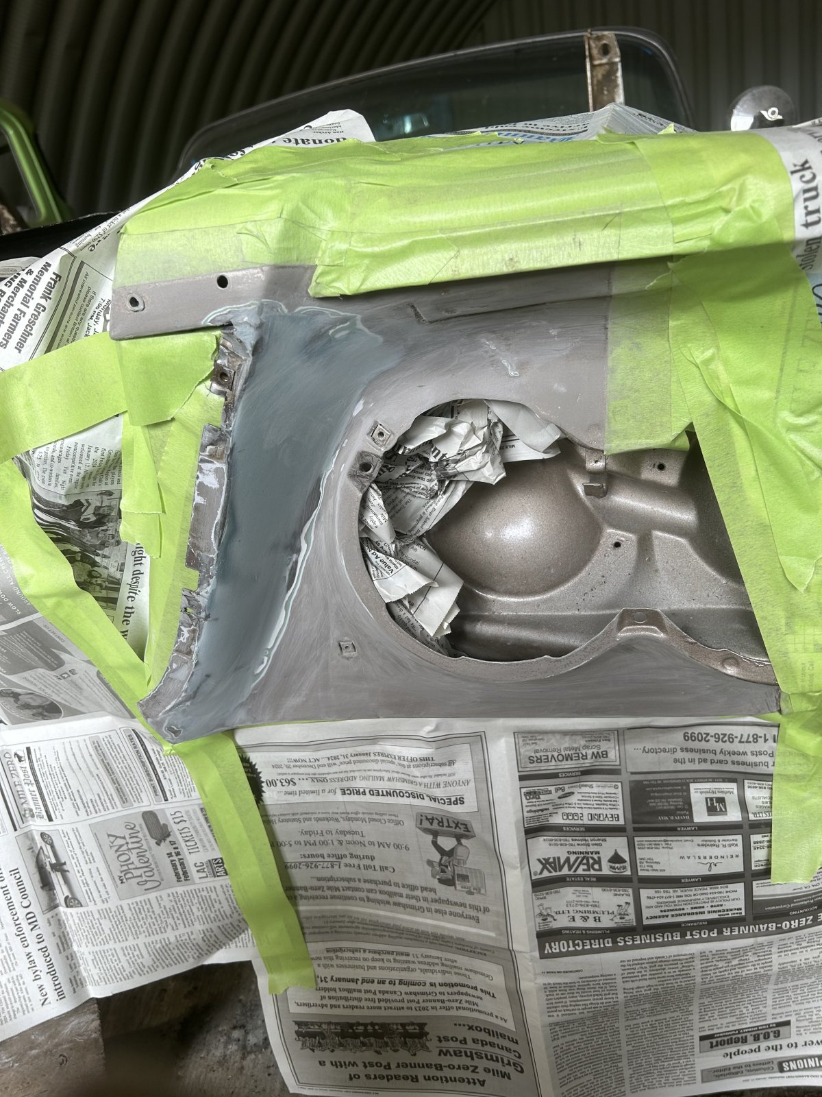

    That was last Wednesday on the way home from work. Got to work this weekend after pouting for a couple days.

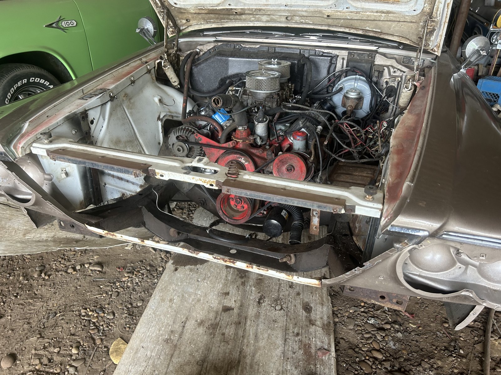

    IMG_5605.jpeg IMG_5606.jpeg Starting pulling it apart. Luckily I got a four door parts car with it when I bought it.
    Straightened out the front fender and mocked up some parts.

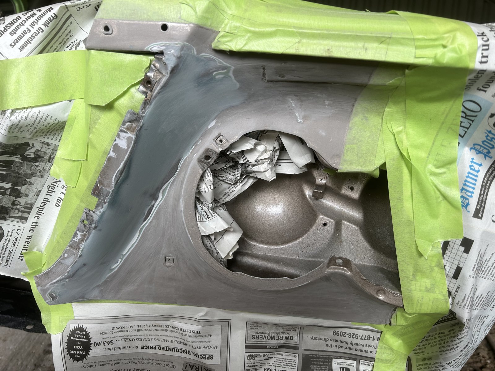

    ready for bodywork, I can hide the tape line between the chrome, I’m not painting the whole
    fender.
    The hood took the brunt of it.

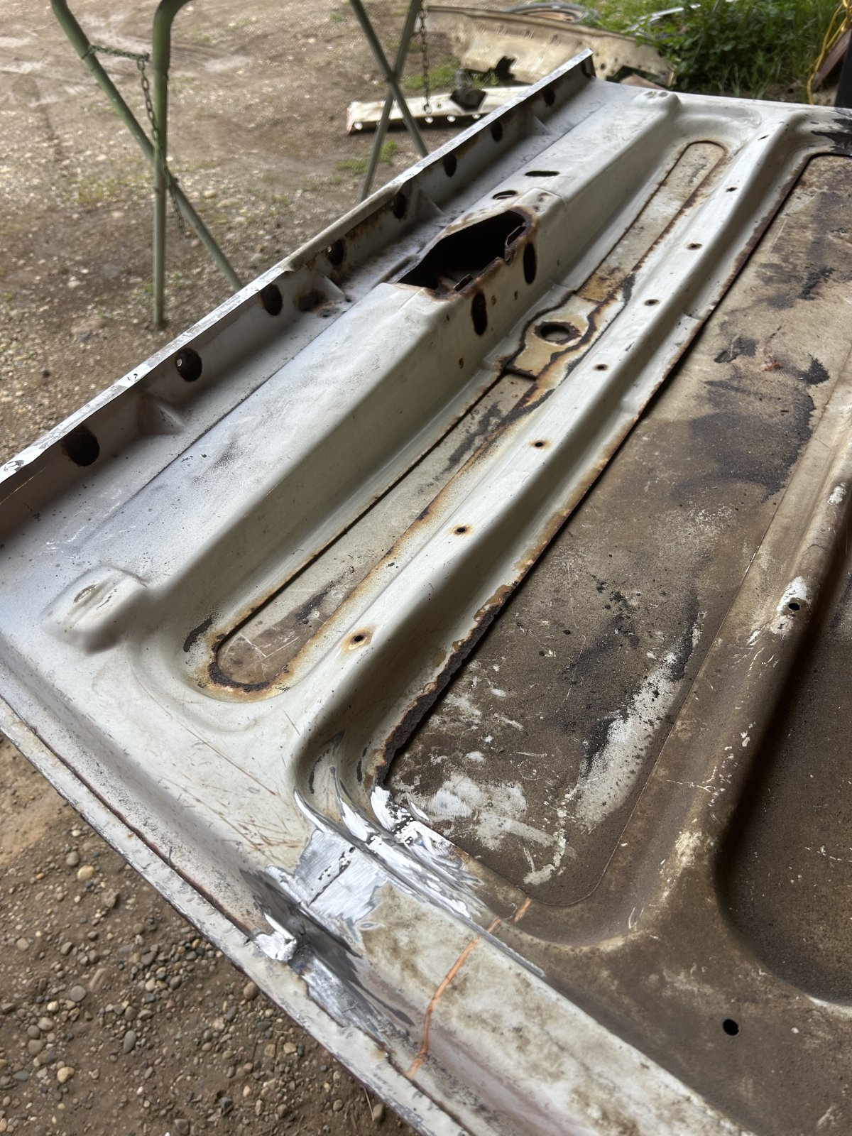

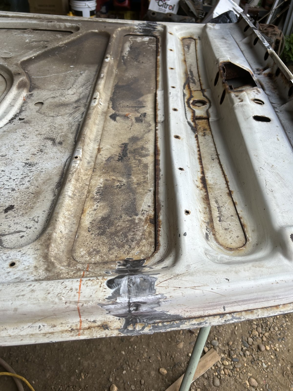

    After evaluating the two hoods I had I came up with a plan.
  11. 57 Fargo
    Posts: 6,181
    57 Fargo

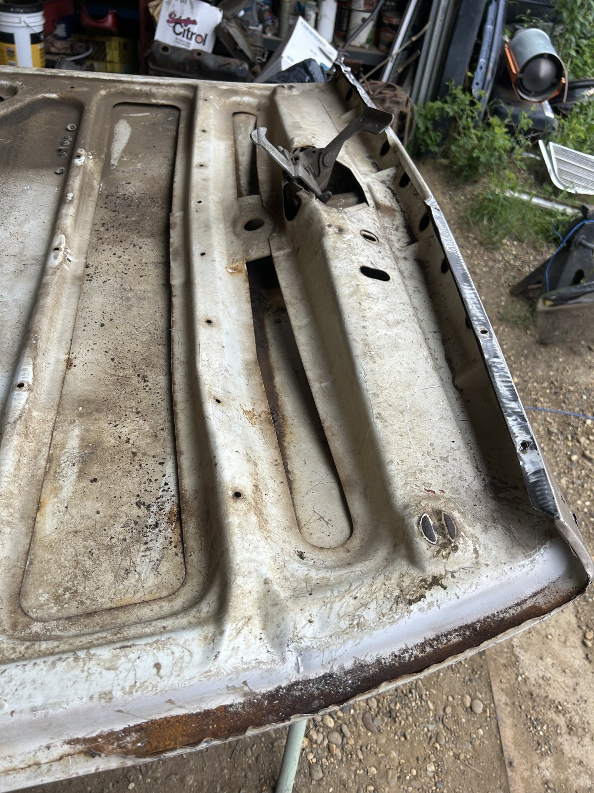

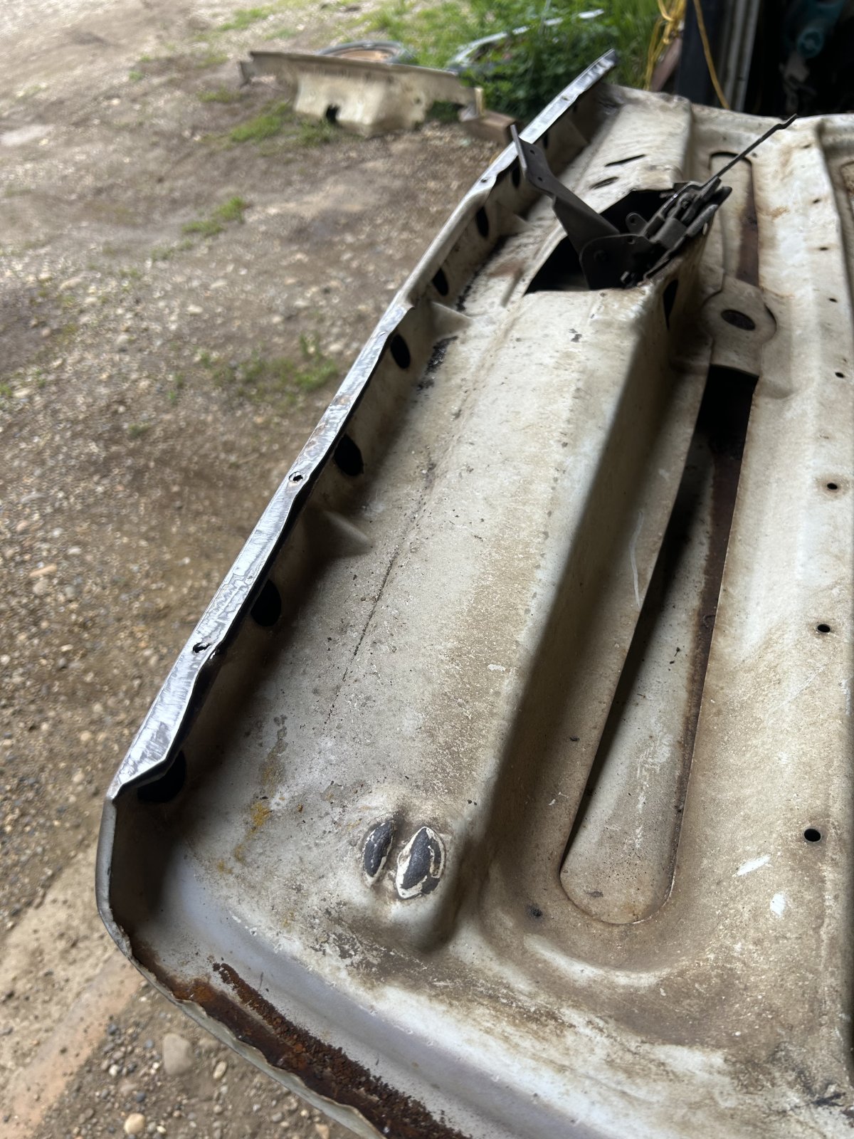

    Cut the front part of the inner support out of the parts car hood, it was rusty around the hinges. This seemed easier… IMG_5620.jpeg IMG_5618.jpeg Welded it with my flux core 110 welder just to prove you could…nope, ran out of mig gas and was too lazy to go to town.
    Put the hood back on the car and it actually fits. IMG_5621.jpeg IMG_5622.jpeg The bodywork on the fender is done, I’ll pull the hood back off and touch up some bodywork on it then prime it and the front of the fender, paint them and back on the road it goes…

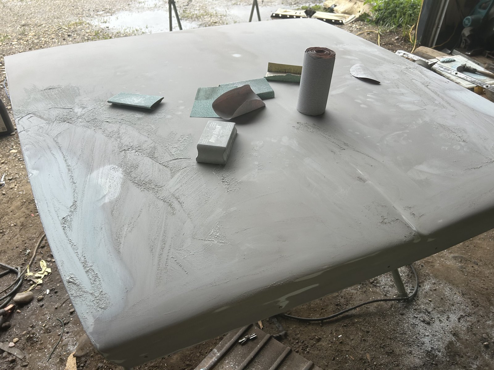

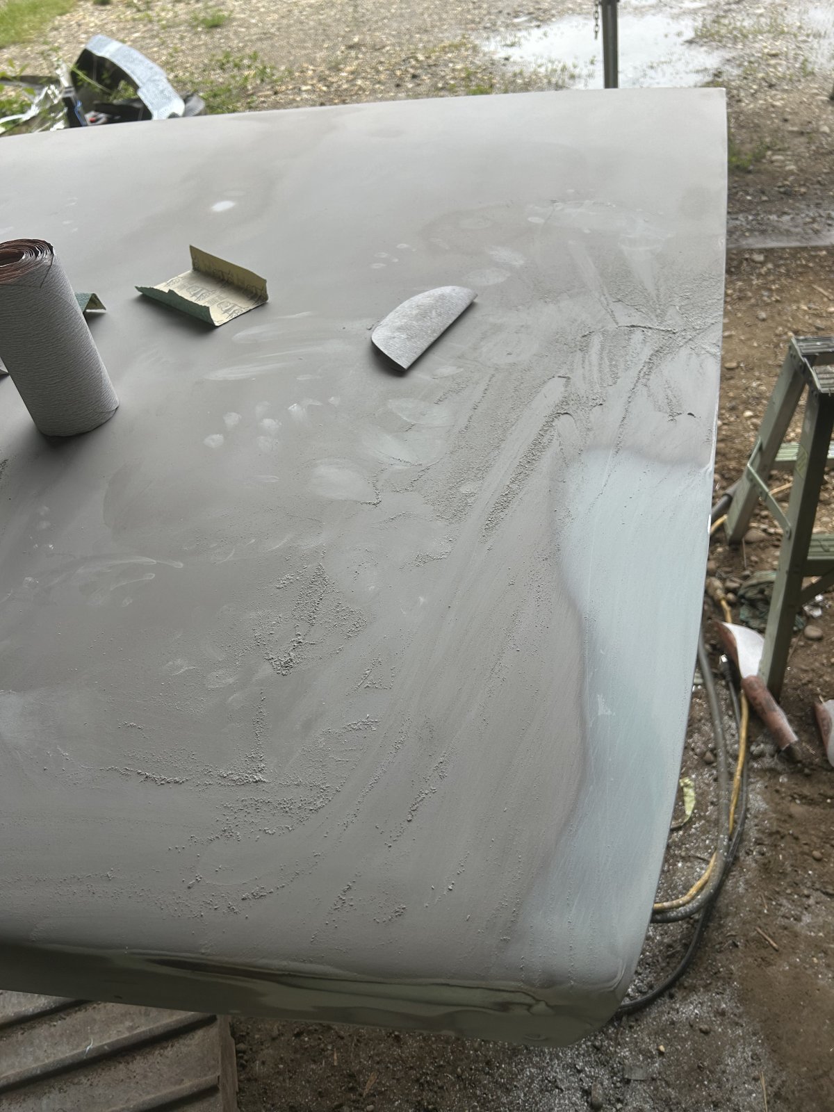

    Body work is done, it’s in primer now. Forgot to take pictures, I’ll have paint on it this week sometime, should be back together next weekend.
