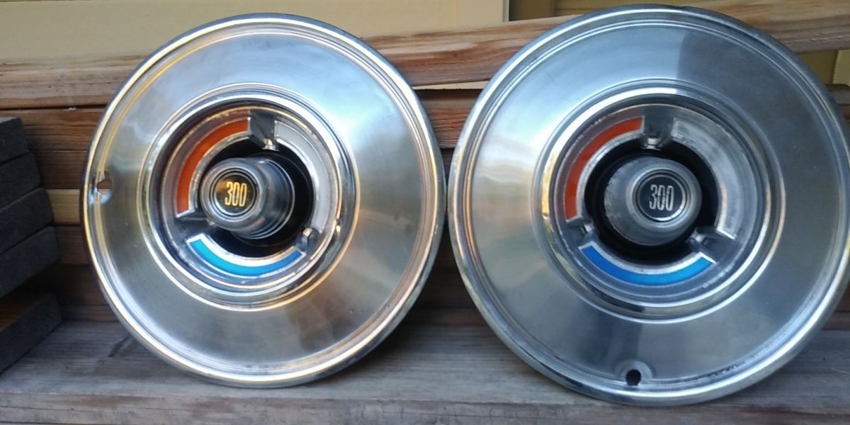

  8. I have a pair of these 1966 300 wheel covers. Would you be interested?
    chryslerfan55, Thor1 and loudbang like this.
  9. 57 Fargo
    Joined: Jan 22, 2012
    Posts: 6,119
    57 Fargo
    I may be...send me a pm with the info!
