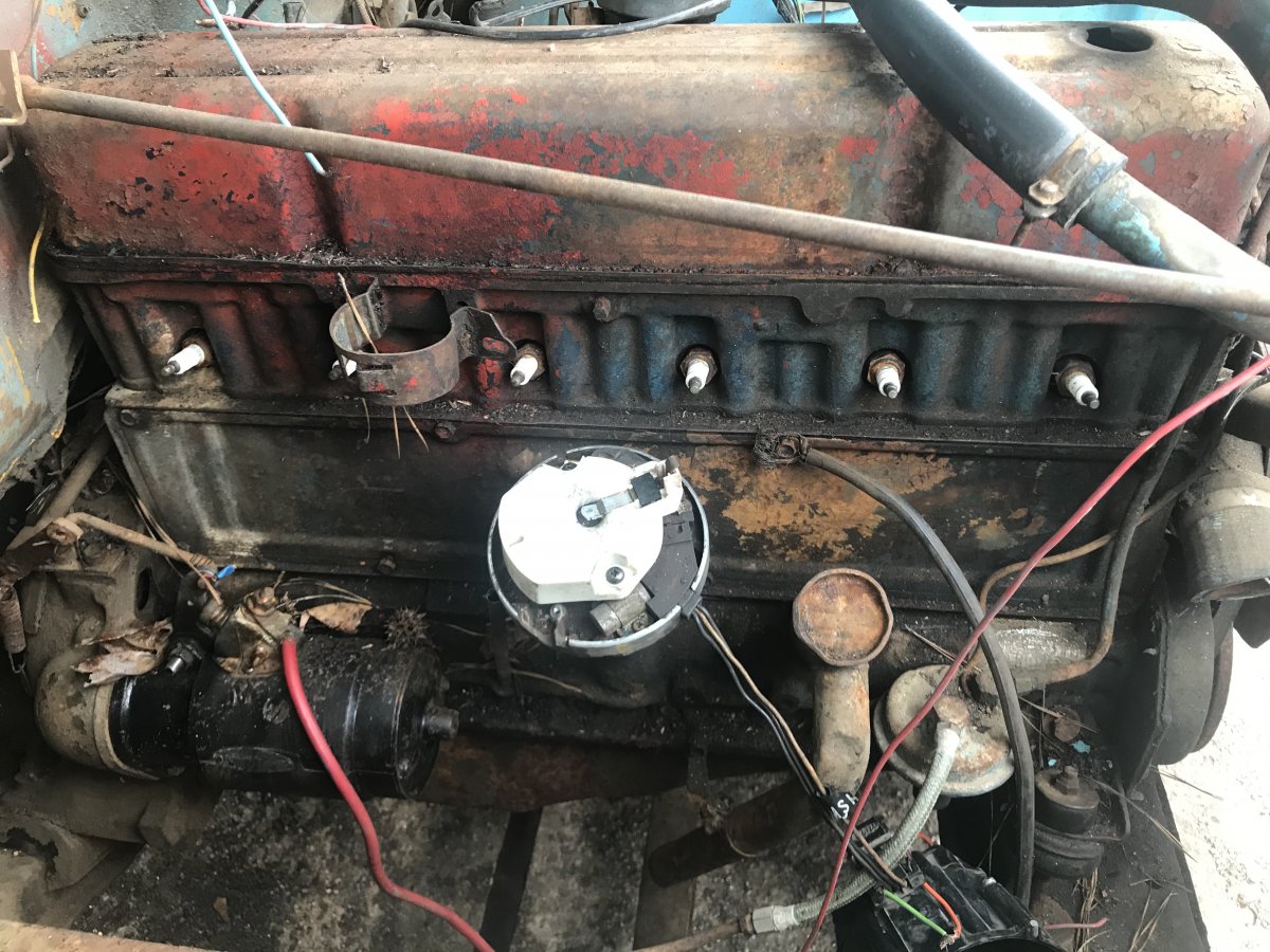

  1. 3DDDC52D-B454-421D-8418-373A04759FDD.jpeg 421BA1A4-8DFD-4976-B448-C8E808C7F33C.jpeg F2E9ED58-2FD1-4D54-BAED-84C6B3047DCA.jpeg
    been looking for one and the s**** yard came through. It even has an HEI. Going to look up the numbers on the distributor.
    looks like the starter has been rebuilt. I needed another foot pedal gm starter. This one should be 12 volt. The engine was in a 58/9 bus

    That's cool, they're hard to find. Is the deck height higher on a 261? Or are the outside dimensions identical?

    This was/is a common/cheap upgrade that was/is used by racers, especially land speed.
    They fit and work great, the other electrical is the small cap HEI found on V-6 small Chevy trucks

    I used a Delco HEI on my AMC six-cylinder....ugly but damn they work well!

    Deck's the same. Good score, let's see the code behind dist. & head casting #.

  12. A later distributer like from a 250 is easily modified to fit the early motors. Like grinder easy.

    I’ve seen the 4.3 distributors used with some slight machining
    Patrick’s or Langdons makes an hei kit for these
