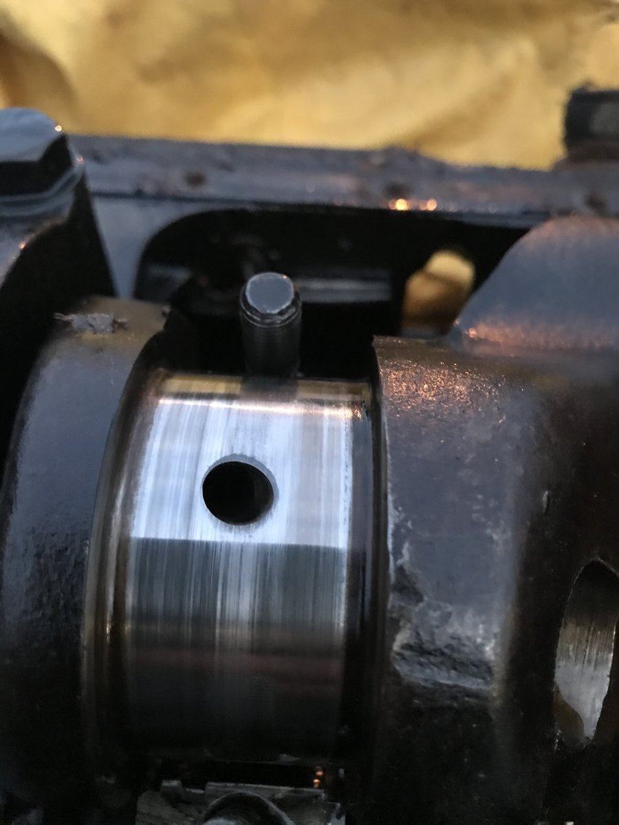

  3. 9F00EE68-944B-4B79-B315-3B7E6C66B5E6.jpeg 624F506F-D5C1-43DC-AB11-C267CF2E46D4.jpeg F702E288-CBFE-4395-8F3A-95C220370DCD.jpeg
    Pulled one main and rod cap off

  12. The incorrect oiling filtration could possibly be the reason for this
    bearings have even wear but lots of imbedded bits of metal.

  14. showed the youngest what pastigauge was tonight. We checked the mains, .003 for the first 3. Slightly more on number 4.
    the crank has some fine scratches that would probably polish out. I have a standard crank that plastigauged at .002 and no scratches. Might use this one.
