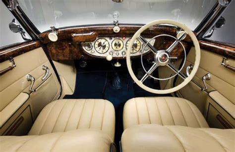

    th68BQFMG8.jpg See the door pull handles just below the window trim? They were missing on a 540K Mercedes ( not the one in the photo), had to make them from scratch. ACE Hardware sells a toilet seat hinge that you can use as a mold to cast them in bronze. Once fitted and chromed they looked fine, I still laugh about it now and then. Bob

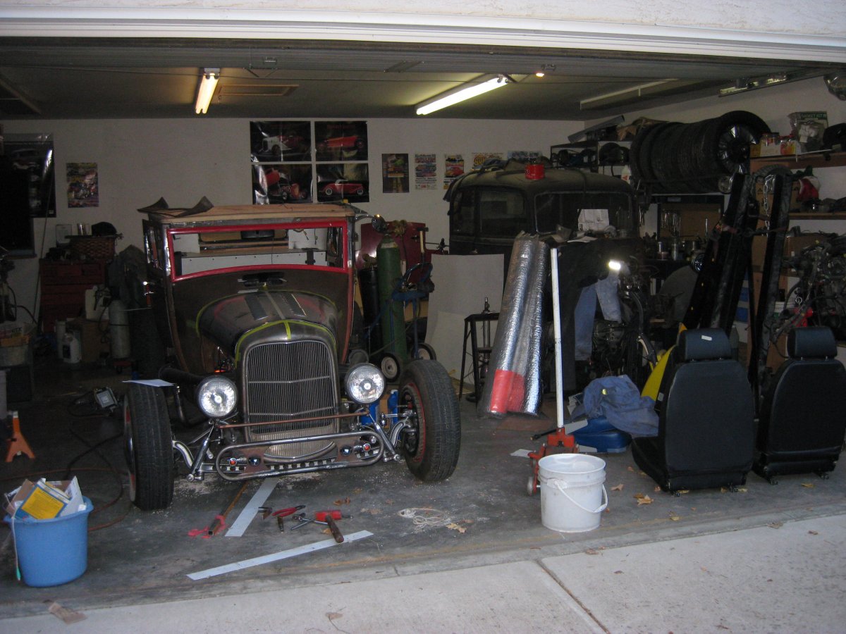

    My headlight bar is 1/2" copper pipe from the plumbing store. The ends where it hooks to the headlight mounting posts are copper tees sweated on with solder. Should take chrome nicely if I ever have the money. IMG_1000.JPG

    That's one of those things that if you didn't people no one would know, it looks pretty much like a original piece. HRP

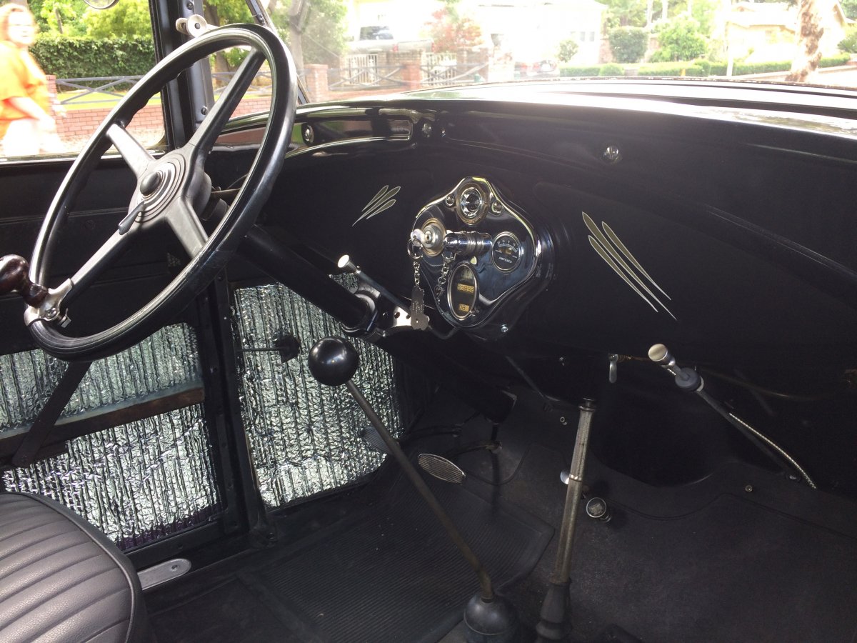

    simple drawer pull knobs from Ace Hardware 53924204-B5EC-4A92-98EC-2AF3584B5D90.jpeg for choke and starter lever in the sedan

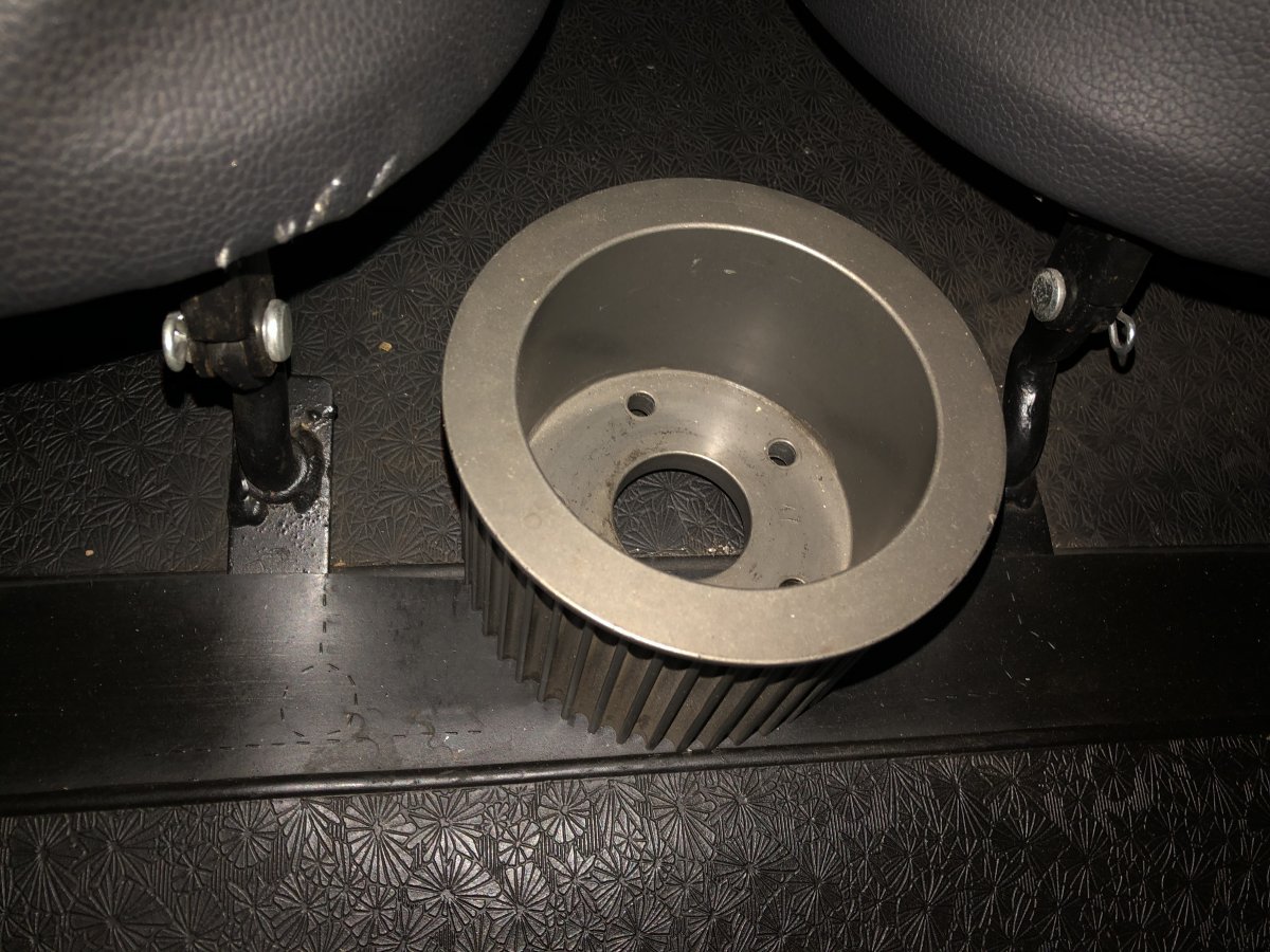

    an old 3" belt drive pulley off my old panhead makes a nifty cup holder. E23D315F-77BA-43CF-88AF-3EE9745D1A1E.jpeg
