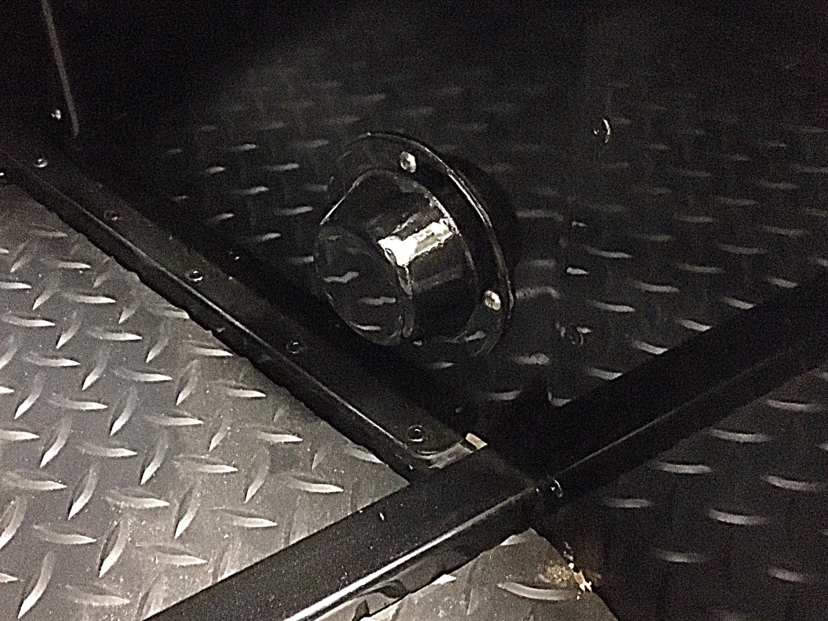

    The trans tunnel in my roadster is very narrow. While making the aluminum panel to cover the trans tunnel I found the clutch slave cylinder and a fitting would interfere with the flat panel. After thinking about what I could use went into the kitchen and grabbed a muffin plan. Sawed off one of the holes and added a flange around the top with a handle. Smoothed up the edge with some bondo where the flange met the muffin pan. I then used it as a mold for for laying up a fibergl*** cover. The diamond plate in the picture is a reflection of the diamond plate rubber floor mats on the gloss black aluminum panel. Quietly replaced muffin pan with a better Teflon coated one to keep wife happy.

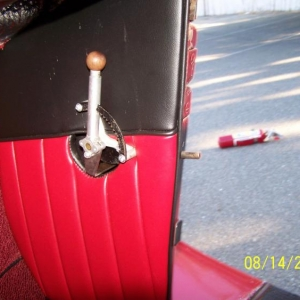

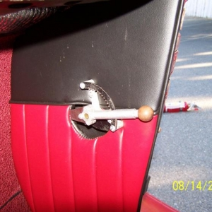

    Here is another one. The suicide door locks on my 34 are from an airplane, a Texan T6 WWII trainer. These were used for the choke setting on the carburetors. They were also used for tail wheel locks. Not my idea but saw them on another car in a magazine article.

    3WLARRY did that on his coupe. HRP

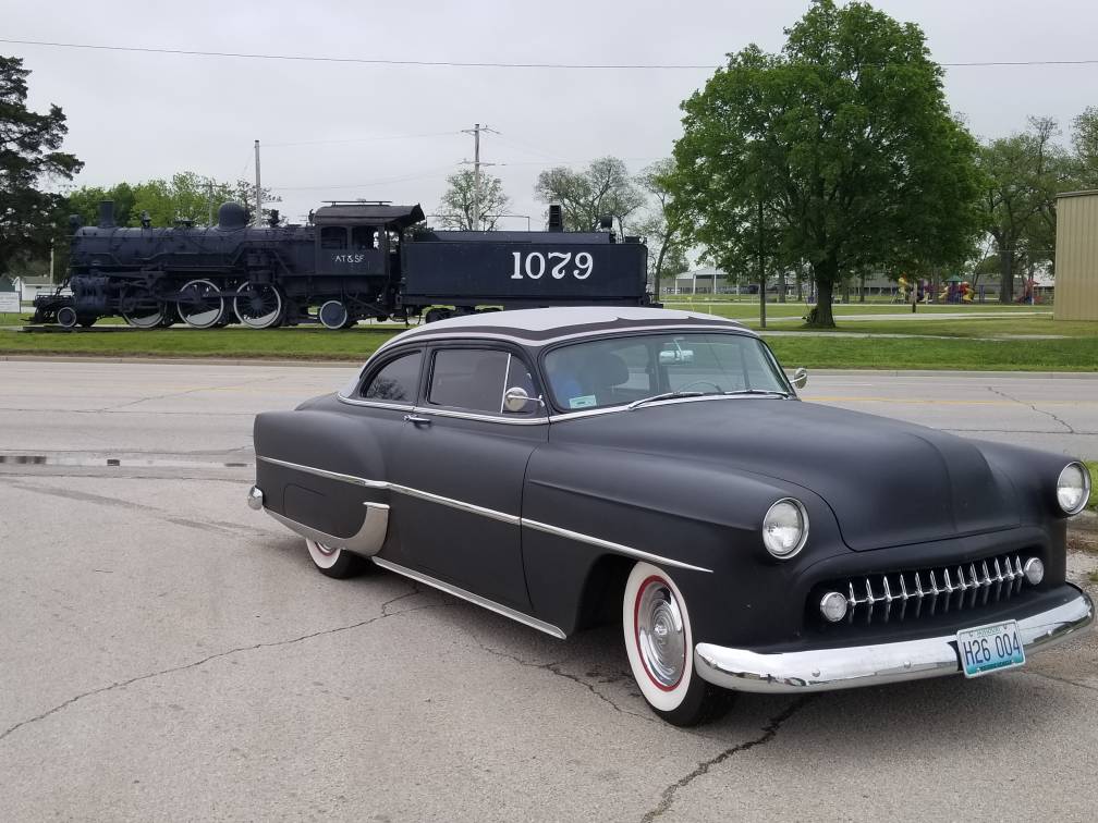

    The parking lights on my '53 are mounted into polished stainless steel measuring cups. I used the handles as mounting brackets. 20190504_093800.jpeg

    That's what I'm talking about, it looks as though it's actually a automotive part. HRP

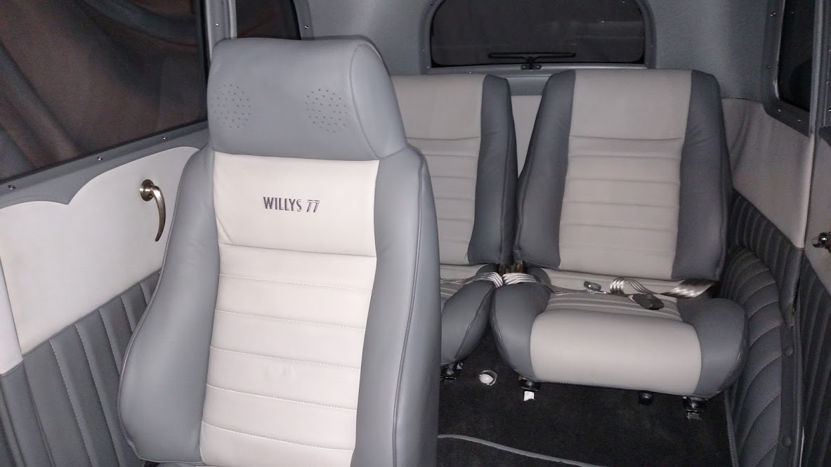

  16. Hard to find, but very comfortable...84-86 Fiero buckets, are also quite narrow, as seen here in my '36 4-door.
    I ended up putting 4 in my sedan 4 door, because they fit so well..had to cut off the headrest speakers however fot the back seat to see out the rear window...g-willys IMG_20160126_152023924 (5).jpg

    I had a set in my '57 PU. I found that while they were great in a car like the Fiero where you sit on the floor, they tend to pinch your thighs together in a vehicle where your legs need to reach down to the pedals.
