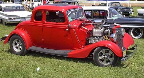

    Here is a pic of Flatdogs car at the Showdown. Thats a nice car and when I build my flathead I'll give you a call.

    Here the pic:
    I think everybody would like to hear more about the combo, it's not everyday you see a flathead knocking on the 12 second door, much less in a 3200lb car, it's very impressive.
