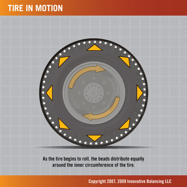

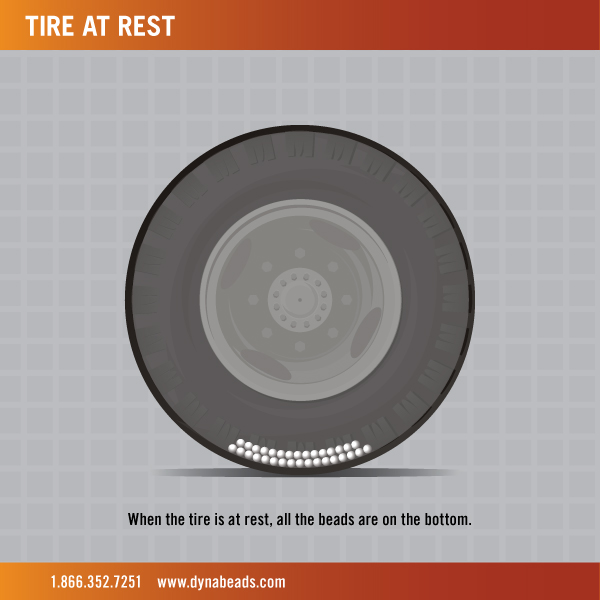

  1. Don't the BBs move out of balance when the brakes are applied? Do they have to be driven a while to rebalance?

    Yep but i bet it doesn't take more than a few blocks at the most, faster you go quicker they re-balance.

    Thanks, Ill use the ceramic dynabeads.
    For those that missed the link to how it works...

    Check out Dyna Beads web site for how it works. There are a few good video's
    on youtube also.

    ..........and the balls come out badabadabadabadabadabadadadada like a machine gun?? :D
  29. I pull the valve cores out of my tires when I air down for off-roading. I have never had the dynabeads come out. Dynabeads recommends the filtered valve cores be used with their product as well. The actual beads aren't that big but much smaller than a BB or airsoft pellet. Kind of like the pelletized ant poison. The stuff makes no noise when driving. It all works off centrifical force. The stuff "seeks out" the unbalanced area and rotational/centrifical force keeps it there. This unbalanced area changes as your tire wears which is why some tires need rebalancing throughout their lifespan. Since the Dynabeads or other brand equivilant (Equal, Airsoft pellets, BBs, Golf Balls....) are not attached/fixed to any one point it rebalances the tire every time it is in motion.
