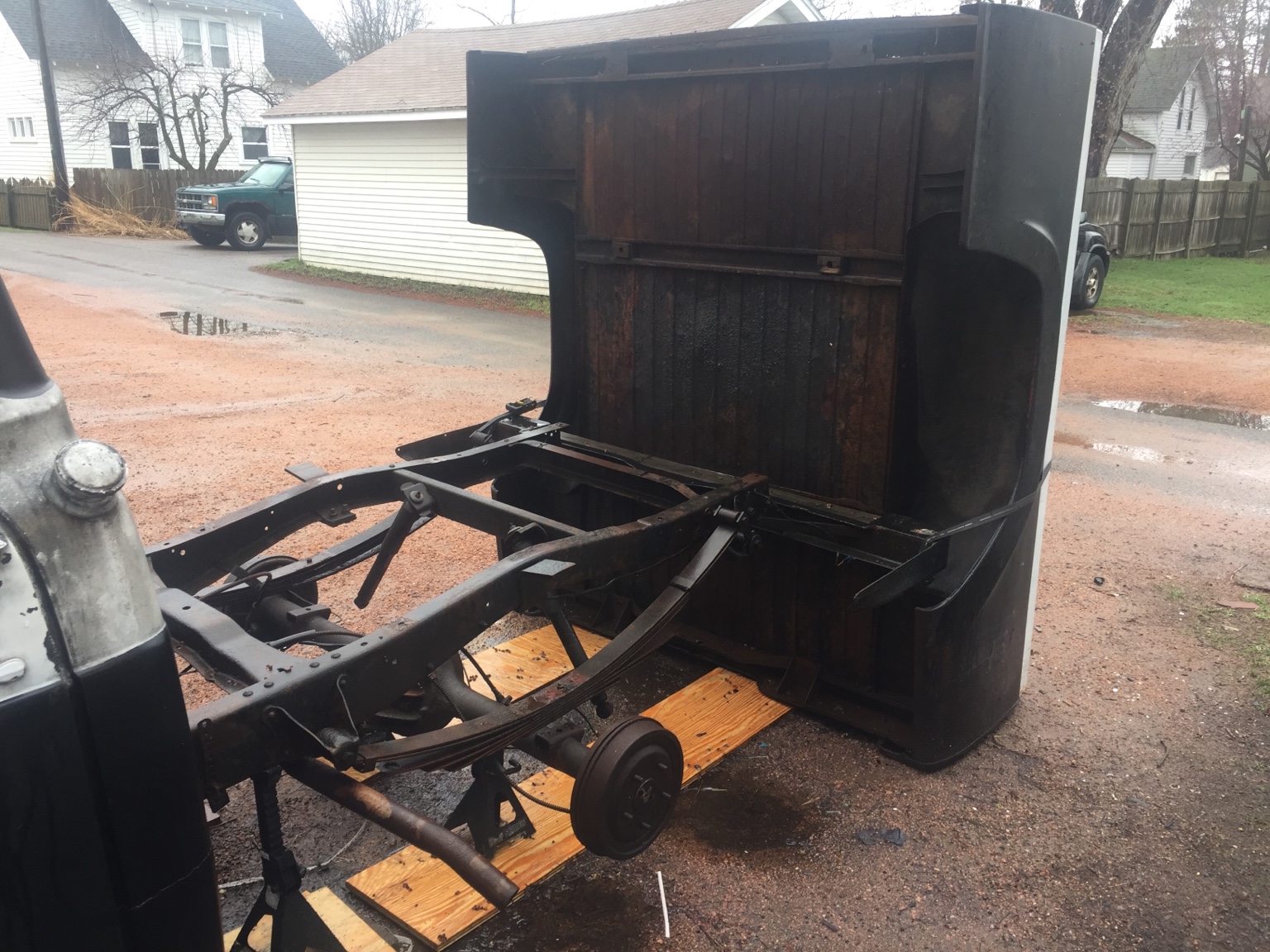

    So I recently took my old 1959 F-100 to an alignment shop as the front tires had gone bald on the outside and looked factory new on the inside. I'm told that they can do it but the leaf springs are going to need to be replaced first as they're worn out. Fair enough, so I bought the springs and proceeded to start replacing them. The fronts went in easily enough but when I got to the backs I saw the axle and mounts looking to be in a sad state. Pulled the bed, cut out the old springs, and found a mangled spring hanger. Sand blasted the frame and found some damage to repair, and now the whole rear of the pickup is down to frame rails.
    My front springs were living on the bump stops

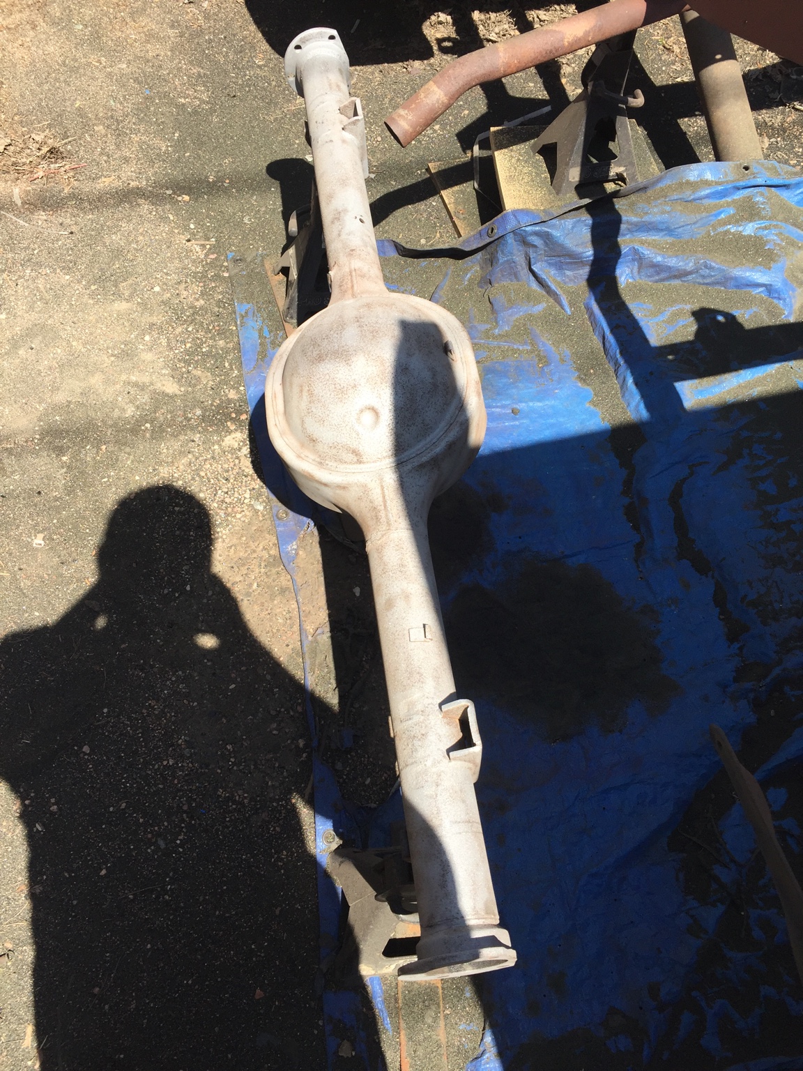

    This was the best shackle i removed from the front.
    The rear p***enger spring pack fell to pieces when I dropped the axle.

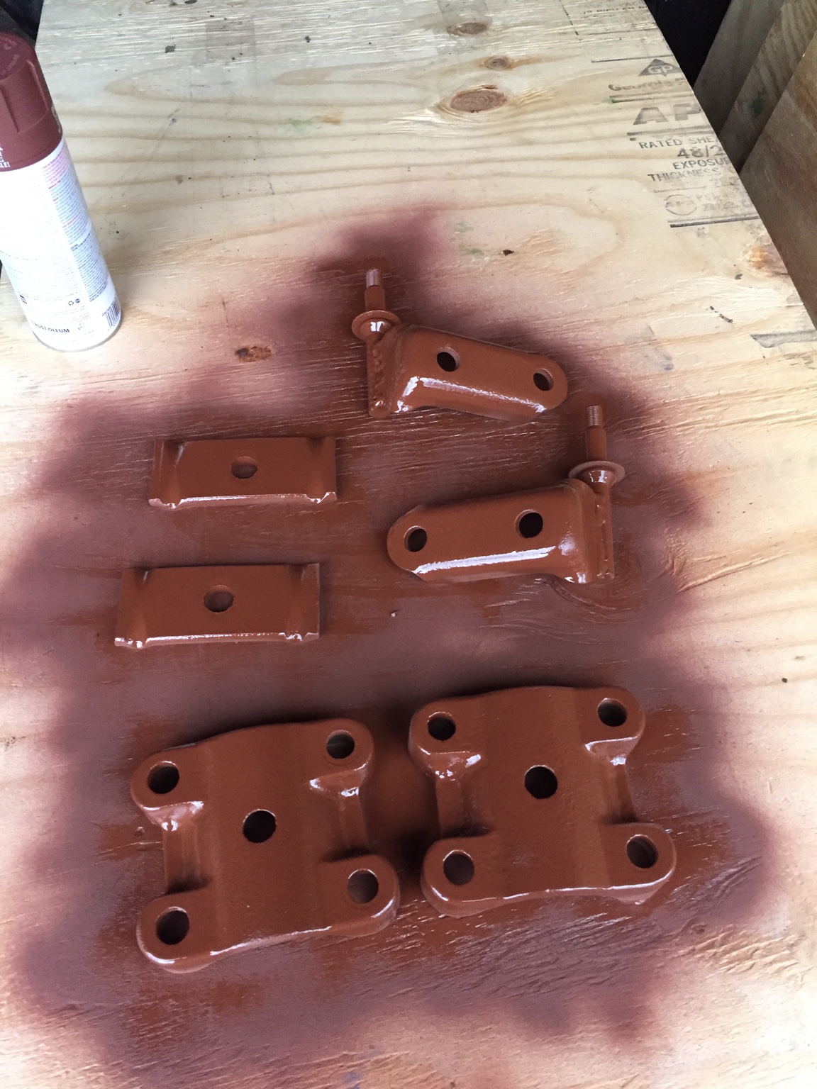

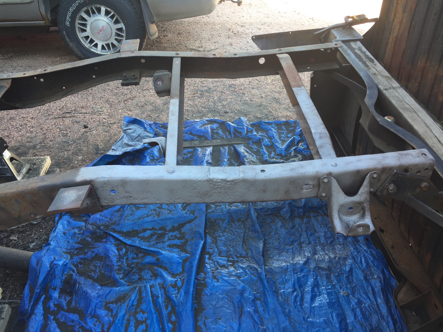

    Axle mounting brackets cleaned, primed, and painted.
    Ugly duckling that leaks from just about every seam.

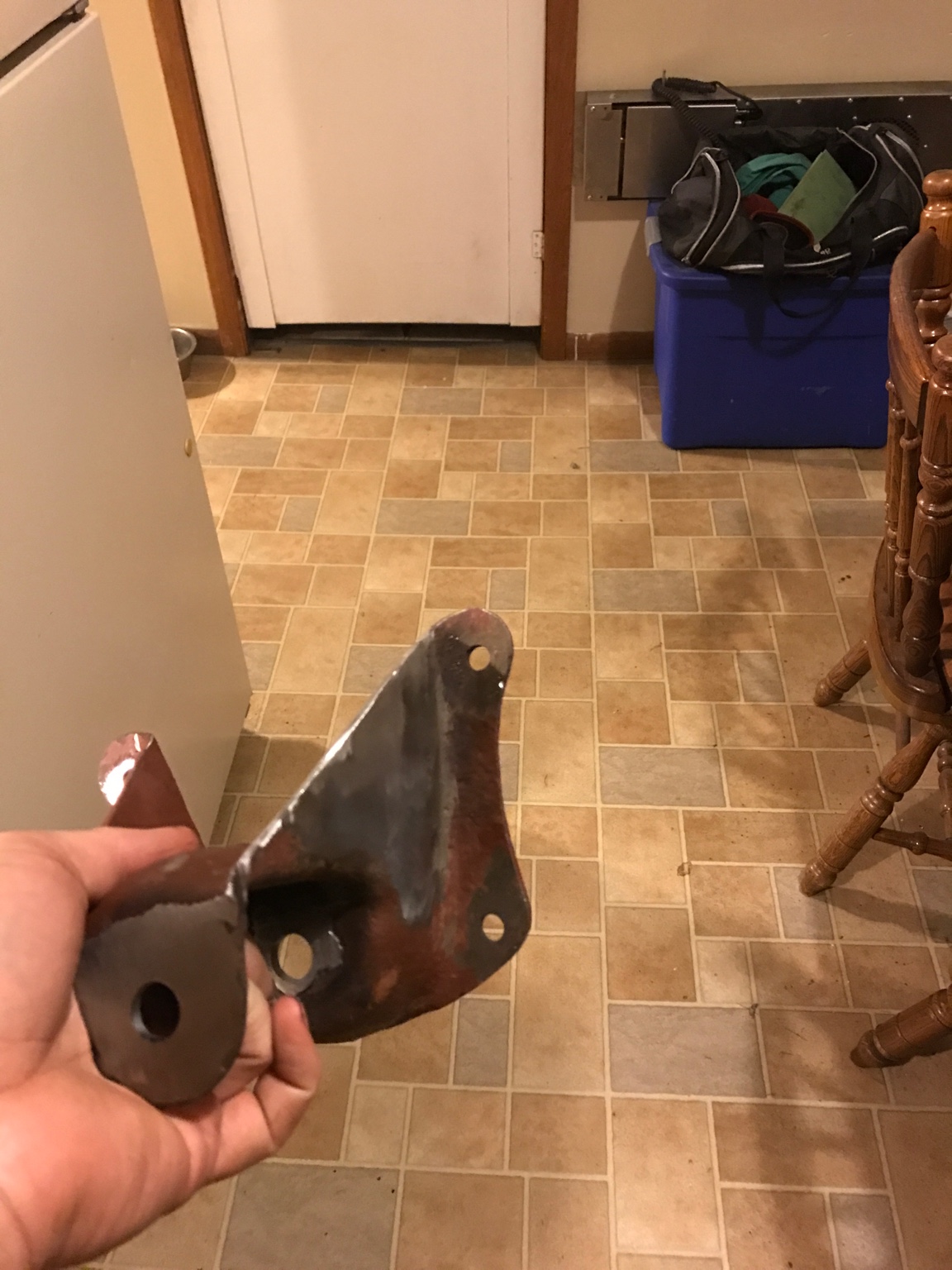

    Previous owner couldn't get to a nut without pulling the bed so they did this hack job to the rear p***enger front hanger.
    This needs to be patched up yet, its only painted to keep it from rusting.
    This is the hacked up hanger, going to fabricate some new ones as they don't seem to be worth repairing.

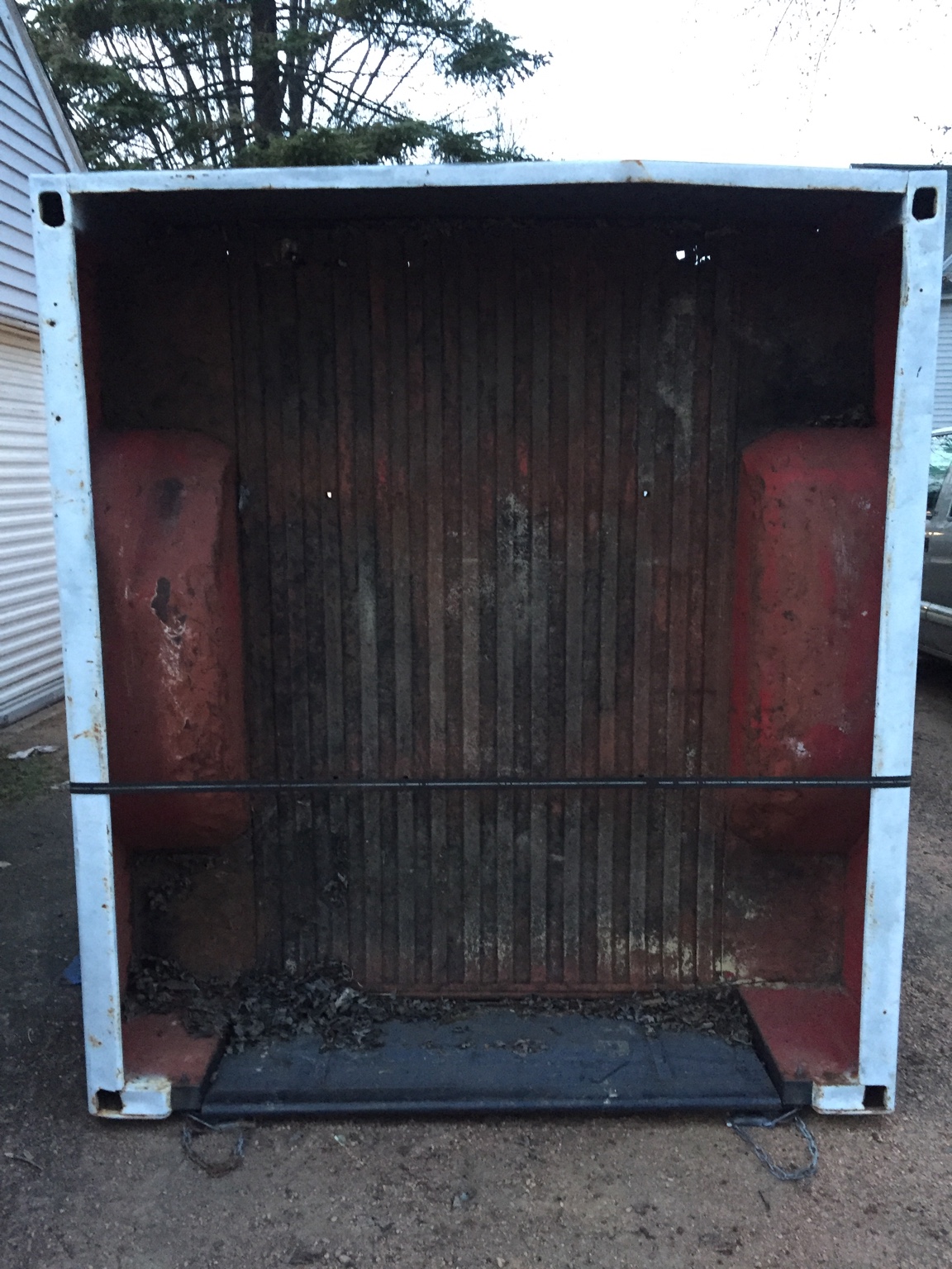

    I'm going to build a custom wood floored box since only the step sides came with wood. Funny how all this started with just wanting an alignment.

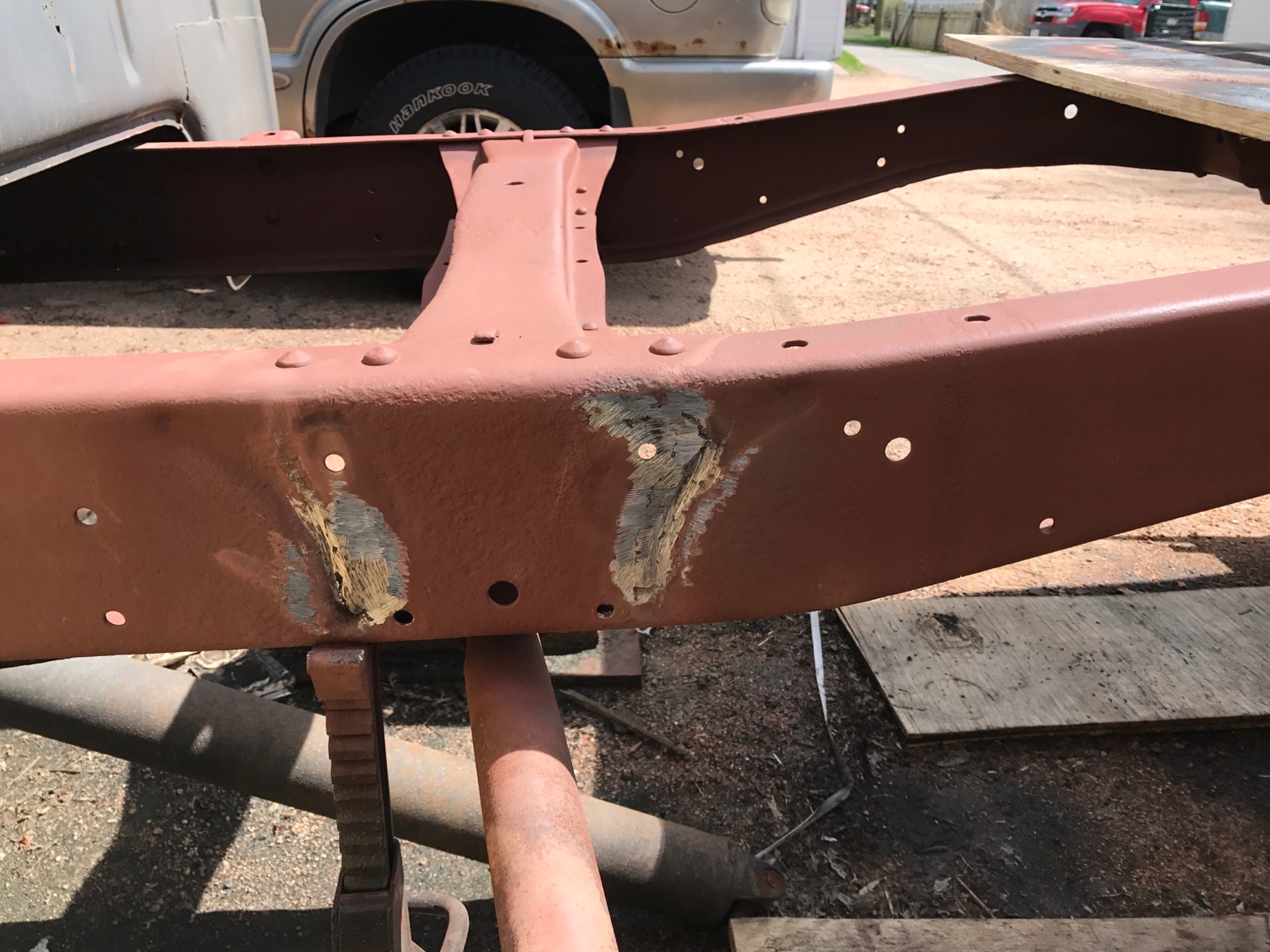

    Thanks. I'm happy I caught it before it needed to be completely chopped up and pieced back together. Now I can do some welding and grinding and bring it back to its original thickness.

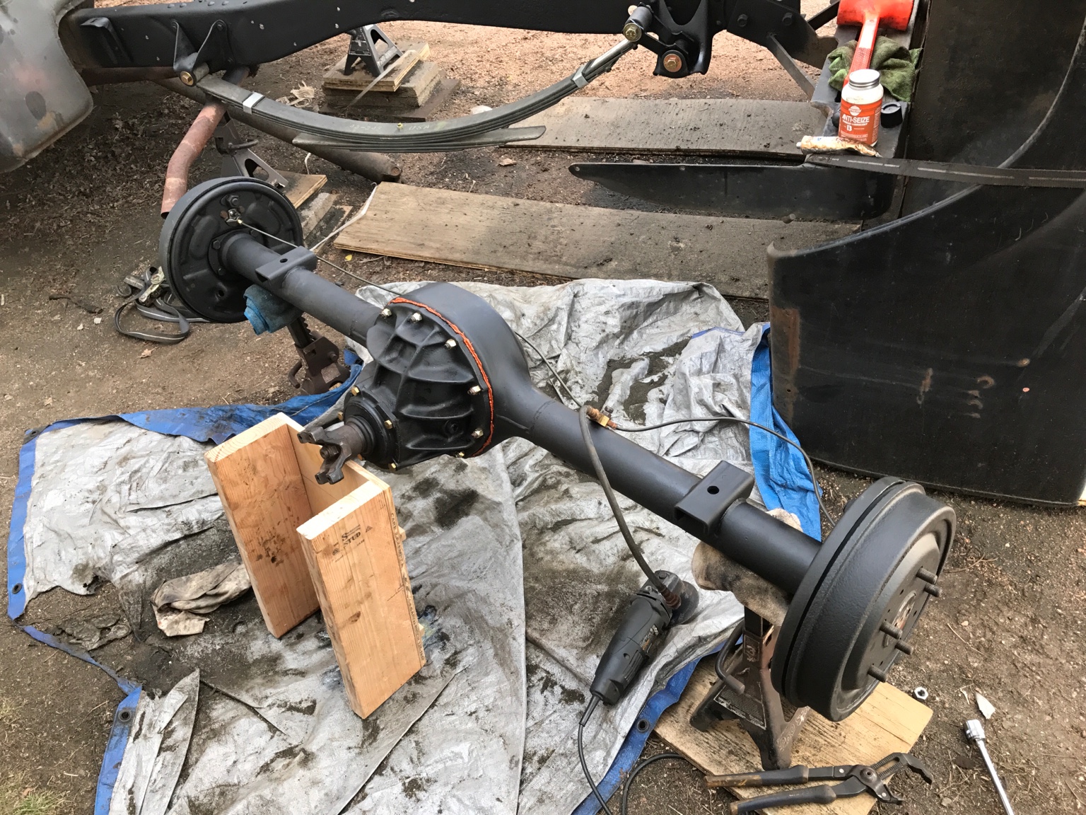

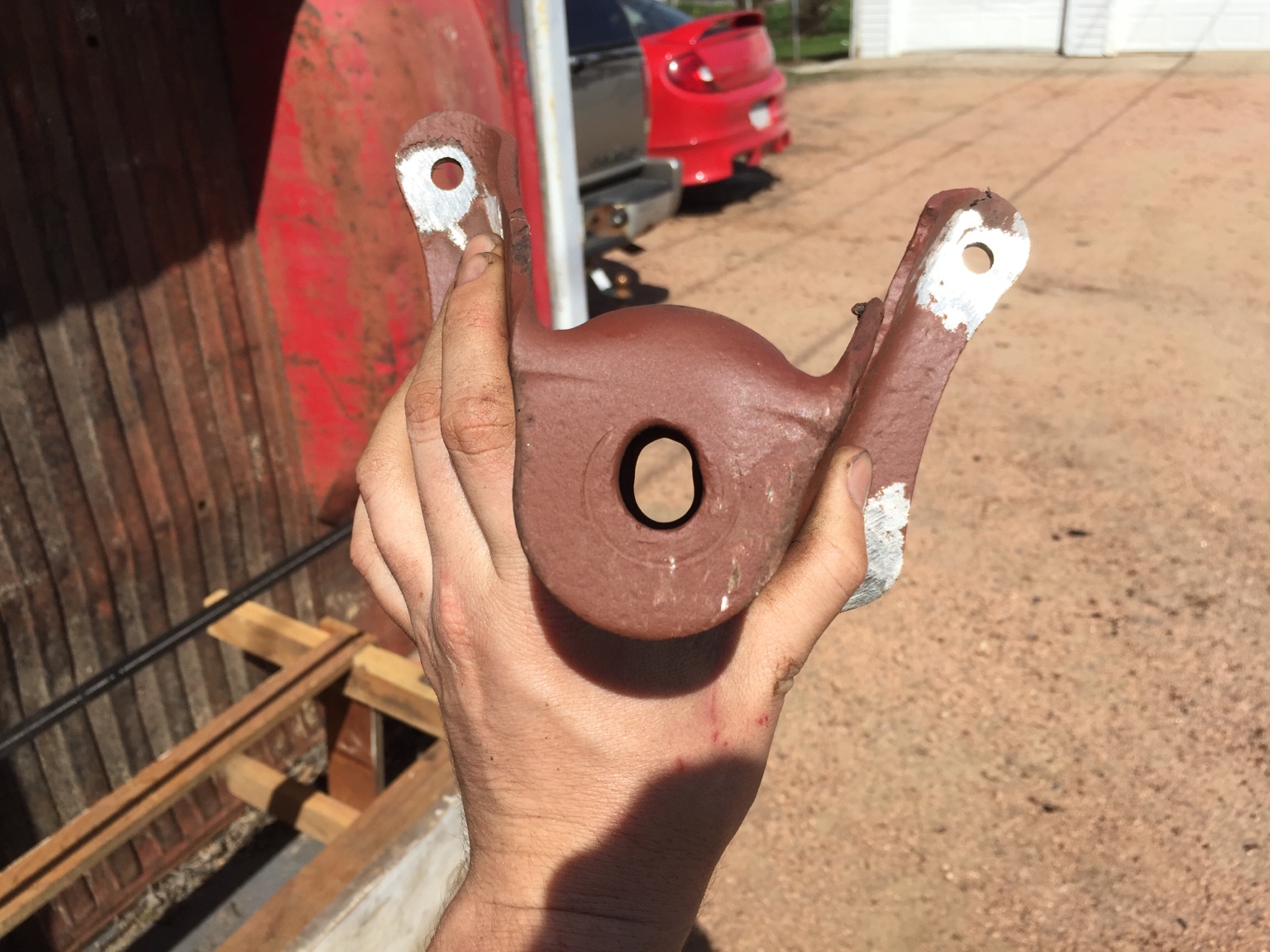

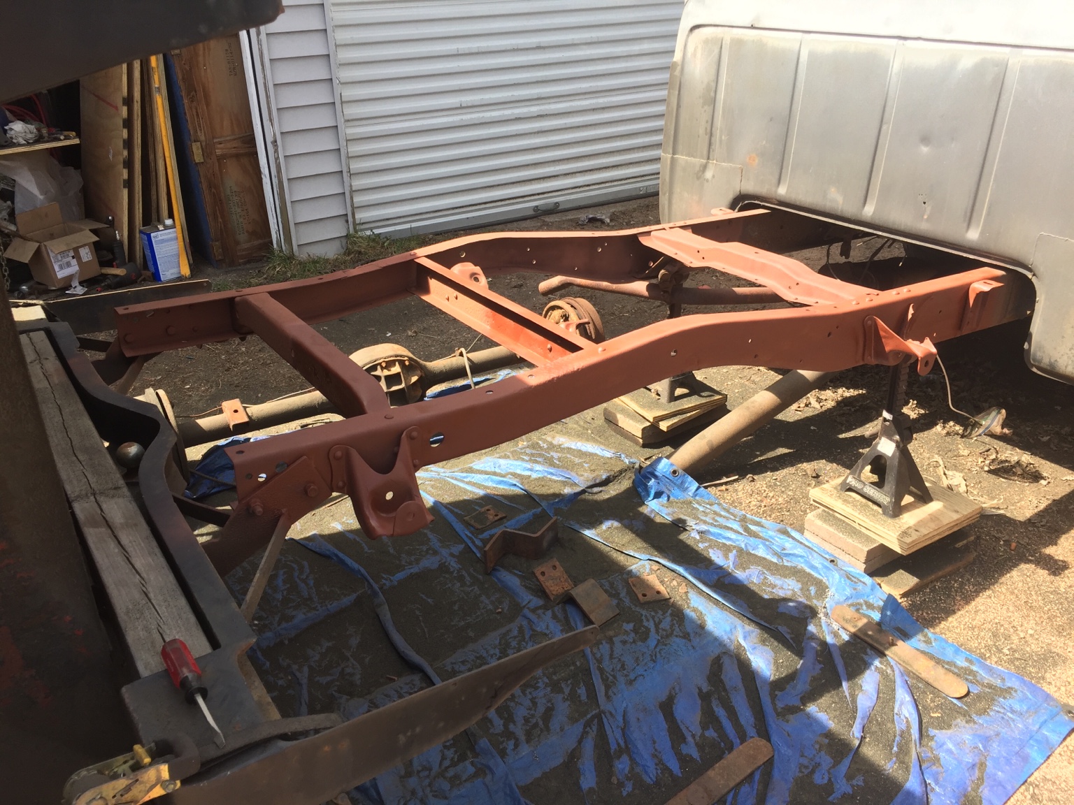

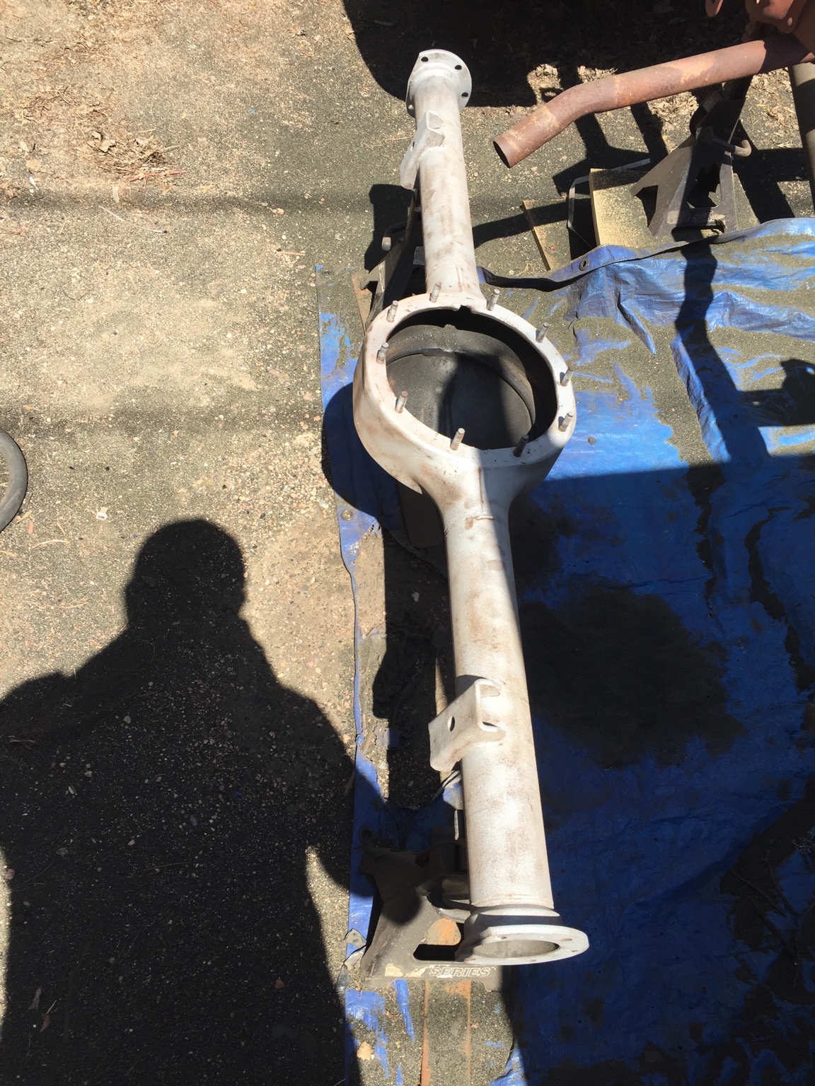

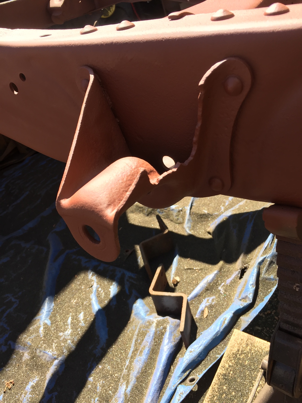

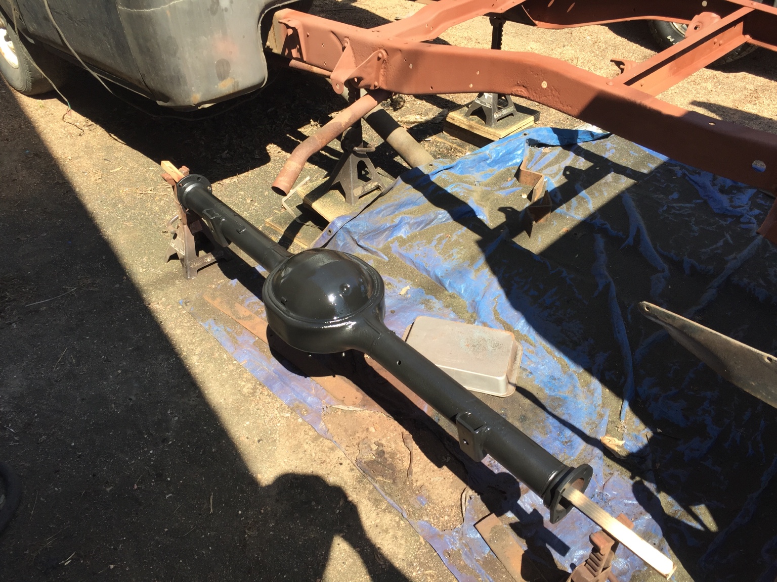

    Good news, got the hangers all patched up and got further into cleaning up the axle components. I have a new pinion oil seal, two axle shaft bearings, and two axle shaft seals. This shouldn't leak a drop after this if I do it all right.
    Cleaned out the jagged torch cut edges
    Got the patch all welded in and filled/re drilled the slopped out mounting holes.
    A huge pile of nope
    No more nope, they've been beautified.
    Soon as the rain stops around here I'll be back to work on it.

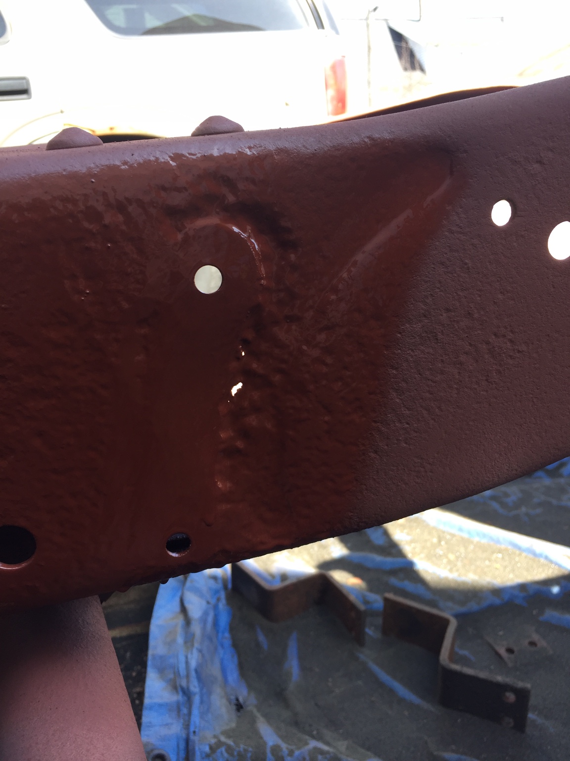

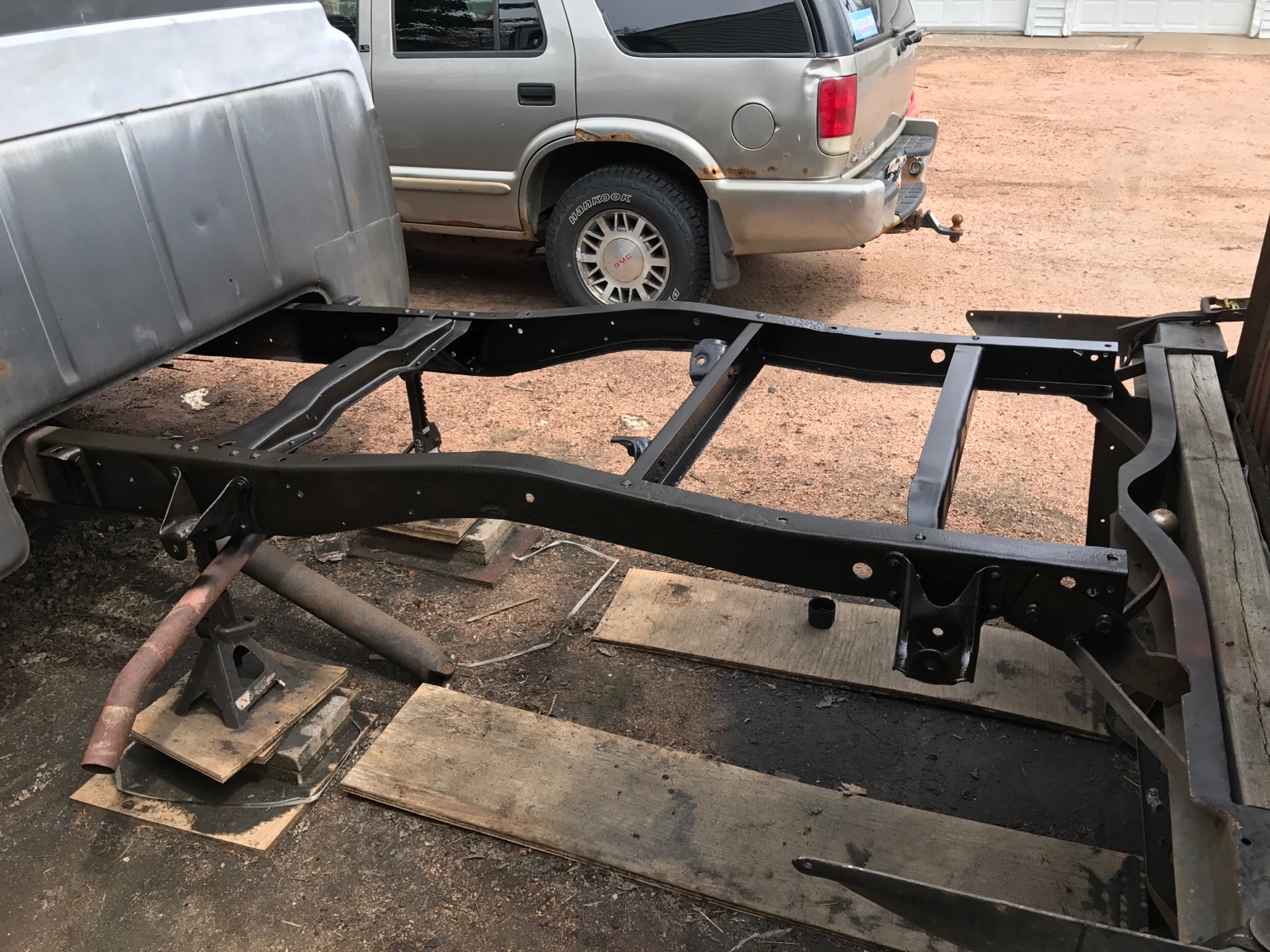

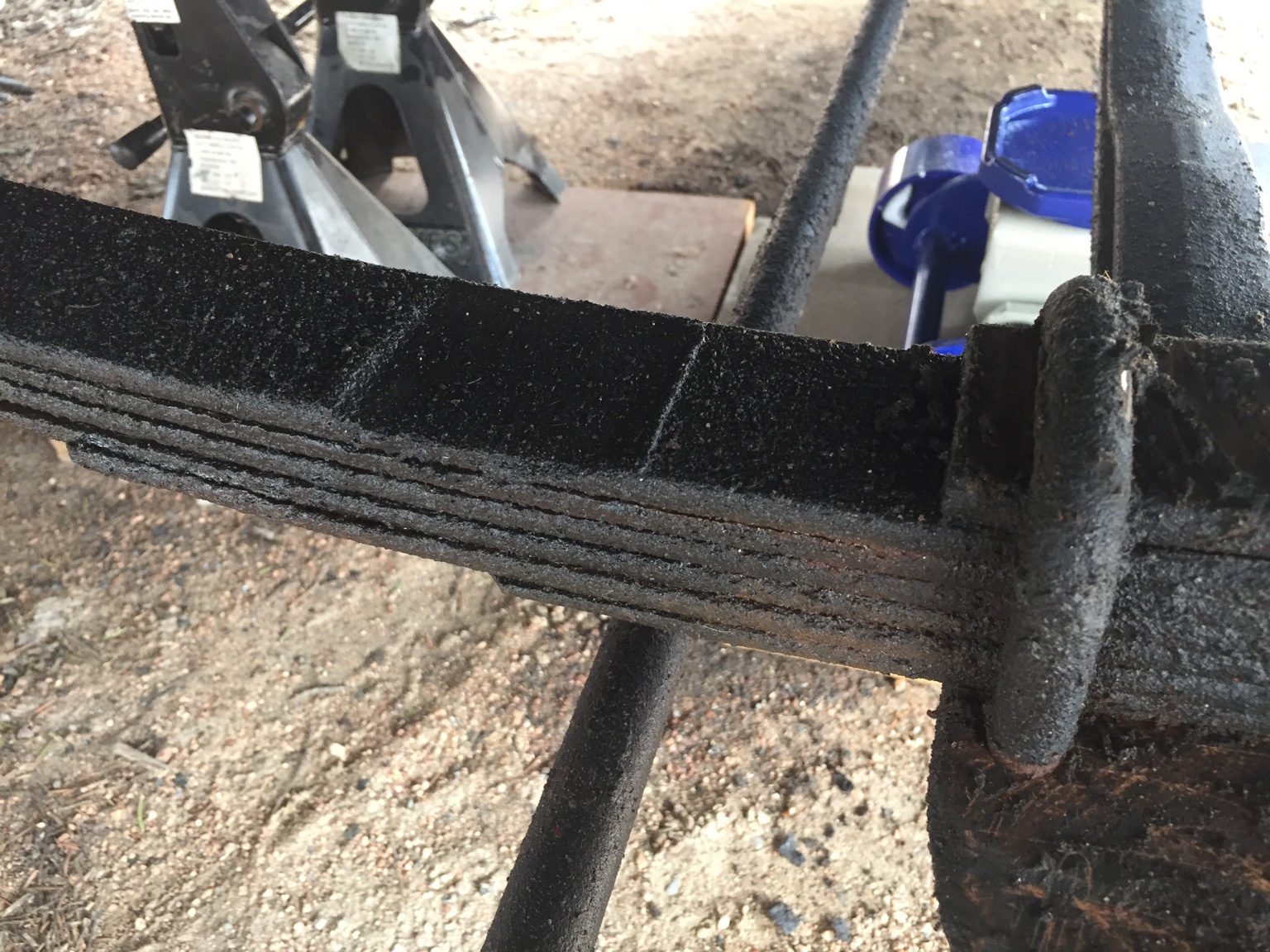

    Made some more progress, in between the rain and snow there hasn't been much though. Got the repaired spring hangers bolted up, the holes in the frame welded in, and got a rubberized top coat over the primer on the frame.
    I should be able to start hanging springs soon. And after that it's on to axle re***embly.

    Looks good, what undercoating are you using?
  25. '51 Norm
    Joined: Dec 6, 2010
    Posts: 872
    '51 Norm
    from colorado
    Umm, it looks like you painted your jack stands.
  26. Clint86
    Joined: Mar 15, 2014
    Posts: 93
    Clint86
    Sure did! I also media blasted them so, the paint is probably a good thing to have on there.
    I'm just using rustoleum rubberized underbody spray. I know it's not ideal but it's what's in the budget at the moment. I don't know when, but I do plan on doing a proper frame off at some point.

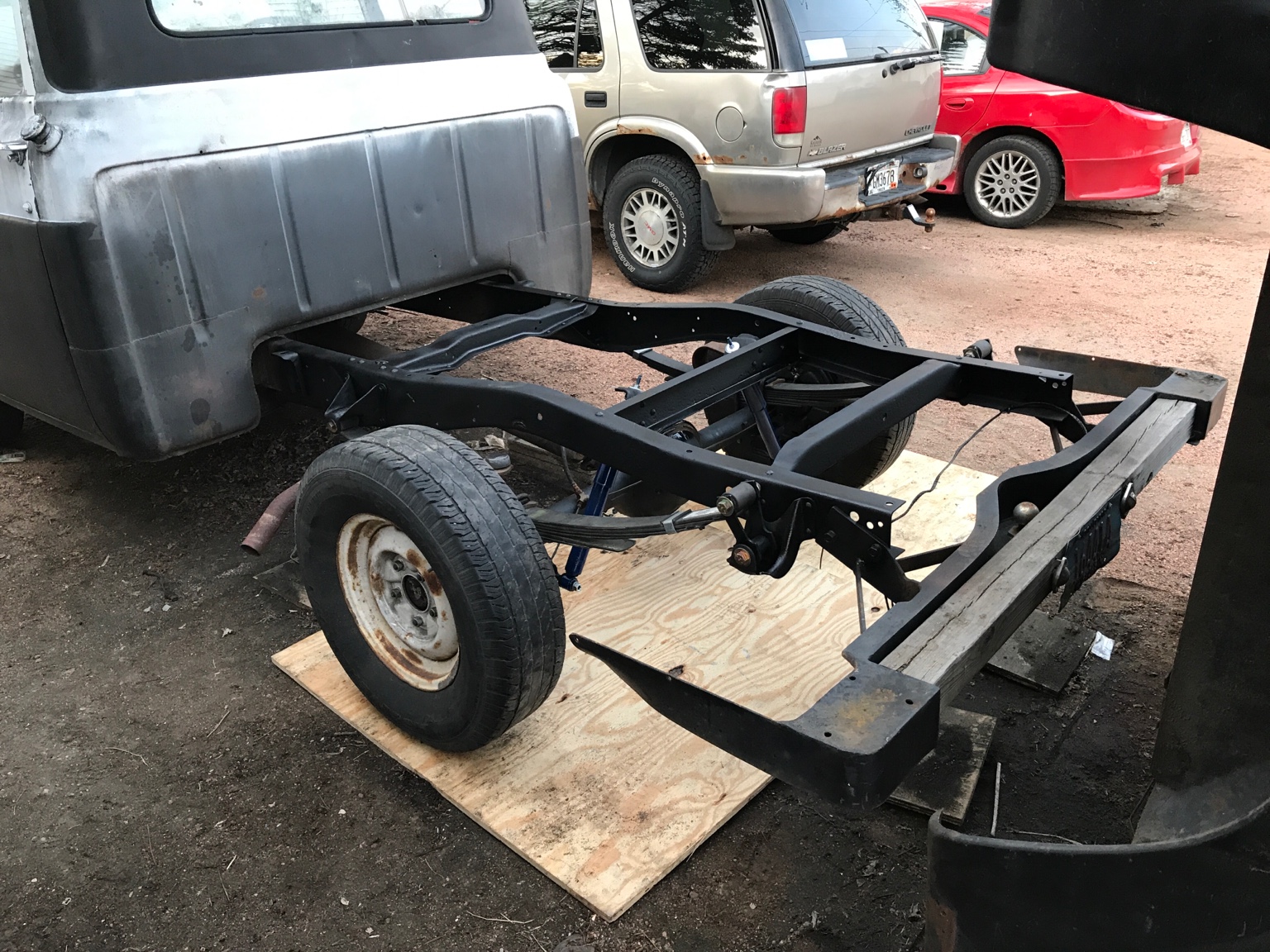

    Well, got it back on all fours again finally. Looks better than what I thought myself capable of to be honest.
    David Gersic likes this.
  28. Clint86
    Posts: 93
    Clint86
    So now that the springs and everything have been taken care of I can say that I gained 3" in the front and about 6" in the rear. The truck doesn't ride like a horse cart anymore either. Leaf springs and solid axles still don't ride like Cadillacs but at least my kidneys aren't being beat to mush every time I go over a bump now.
