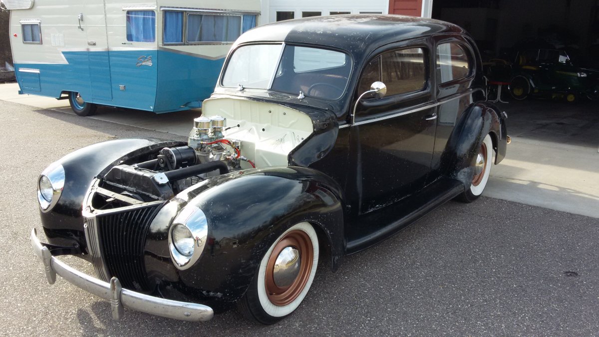

    I've always converted my cars. I pull a trailer and camper with my cars, I like having a radio (at least in my vehicles that you could hear a radio over the exhaust and wind noise). I have found that repairs while traveling are easier when looking for 12v parts. Also headlights and other lights are brighter with the 12V. I don't care if my hot rods aren't hot rods 'cause they run 12v.

    Good looking car and the old Shasta looks nice also. HRP
