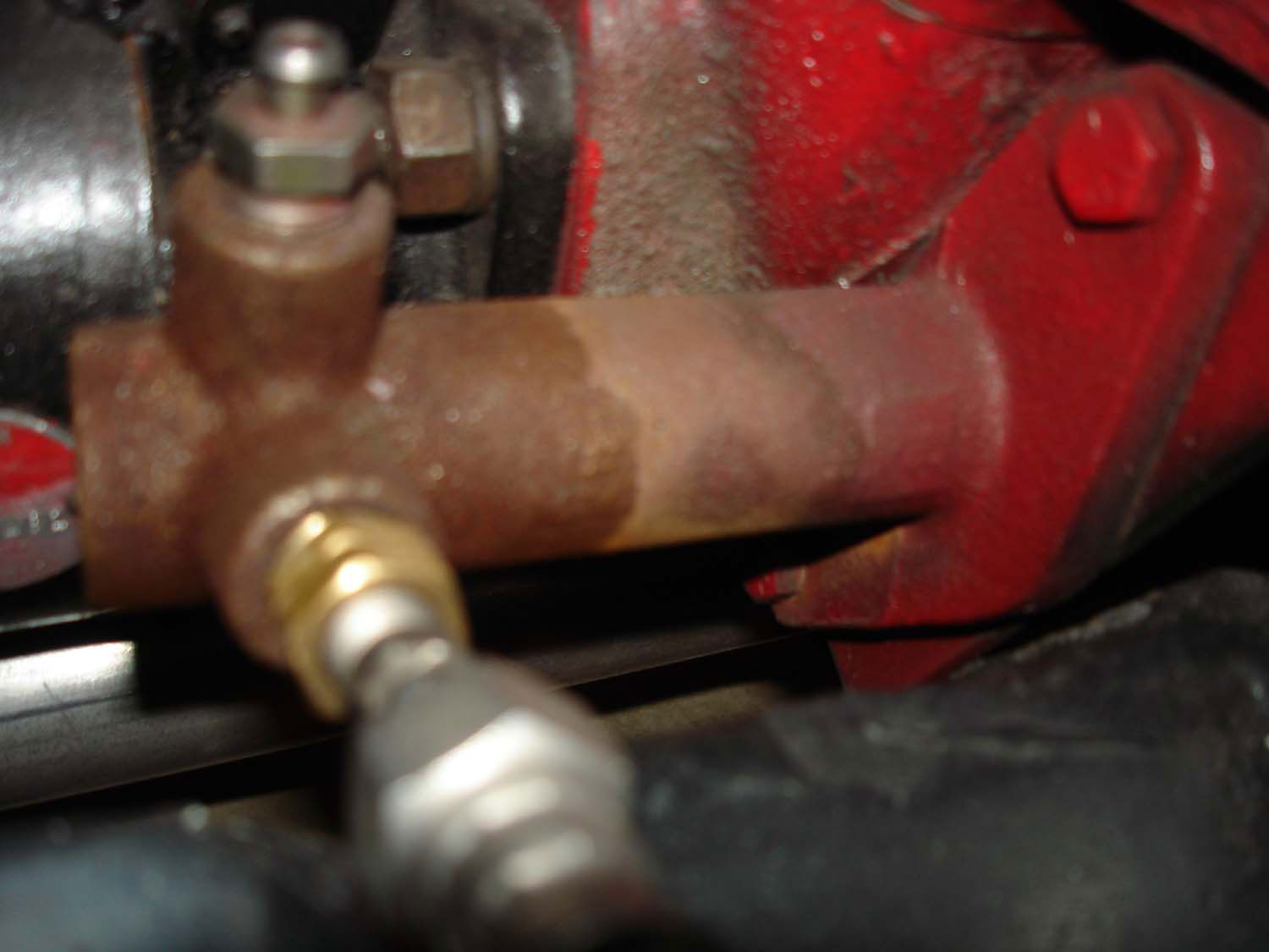

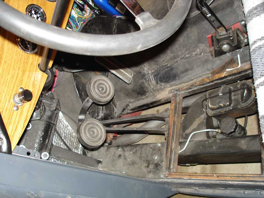

    Looking for some help with this setup. I'm on the second clutch already (first one was from the junkyard so it may have been bad to start with). I've got a 1953 331 chrysler motor in a T coupe (I'll get new pictures up here someday soon). It's connected up to a 4 speed saginaw out of an 81 olds with an adapter from Hot Heads. I got an aluminum flywheel from a boat that was machined for an 11 inch chevy clutch. The problem comes in with the hydraulic setup I think. It's got one of those Pete and Jake setups with brake and clutch master cylinders, pedals, and all the linkage. The clutch master is 3/4 bore. Since there wasn't room for the the included slave cylinder (it's a puller), we substituted a piece that I believe is from a 90s ford truck. It's also 3/4 bore but is a push style. The problem we had when we hooked it up with the brand new clutch is that it couldn't push the clutch fork far enough to disengage it. Easy I thought, I'll just make a longer rod to go in between the slave cylinder and the clutch fork. Thinking back, this was a bad idea but it didn't *feel* like it was slipping at all. Maybe 70 miles and a couple days later, the clutch isn't engaging at all anymore and I'm stuck on the road. Called my dad to have him bring me the original rod to go in between the slave and clutch fork. Got it in and it won't fully disengage the clutch again but we got it limped home by starting in 3rd. It actually feels like it has more power too (probably cuz the clutch must have been slipping a tiny bit almost the whole time). I'm pretty sure I'm going to need to redo one or both ends of the hydraulics on this car but I don't know where to start. I took some measurements and this is what I came up with. The clutch fork fully relaxed is 2.5 inches from the bracket the slave is bolted to. The longer rod I made is 5 inches from the bracket when fully extended (pedal pushed in). I think that means I need 2.5 inches of travel in the clutch system. With the current setup, I only have about 1.25 inches of travel. I probably need to move to something GM made or maybe even just something that has an 11 inch clutch but I don't know what that would be out of or where to get the parts. Wondering if someone has a hydraulic clutch set up similar to this where they could take some measurements and help me figure out what parts I should try. I'll post pictures of the offending parts in case my overly long description doesn't make sense. Please let me know if I'm going down the wrong track with this- this is our first attempt at building a hot rod so I'm sure there are multiple things we may have botched up.
