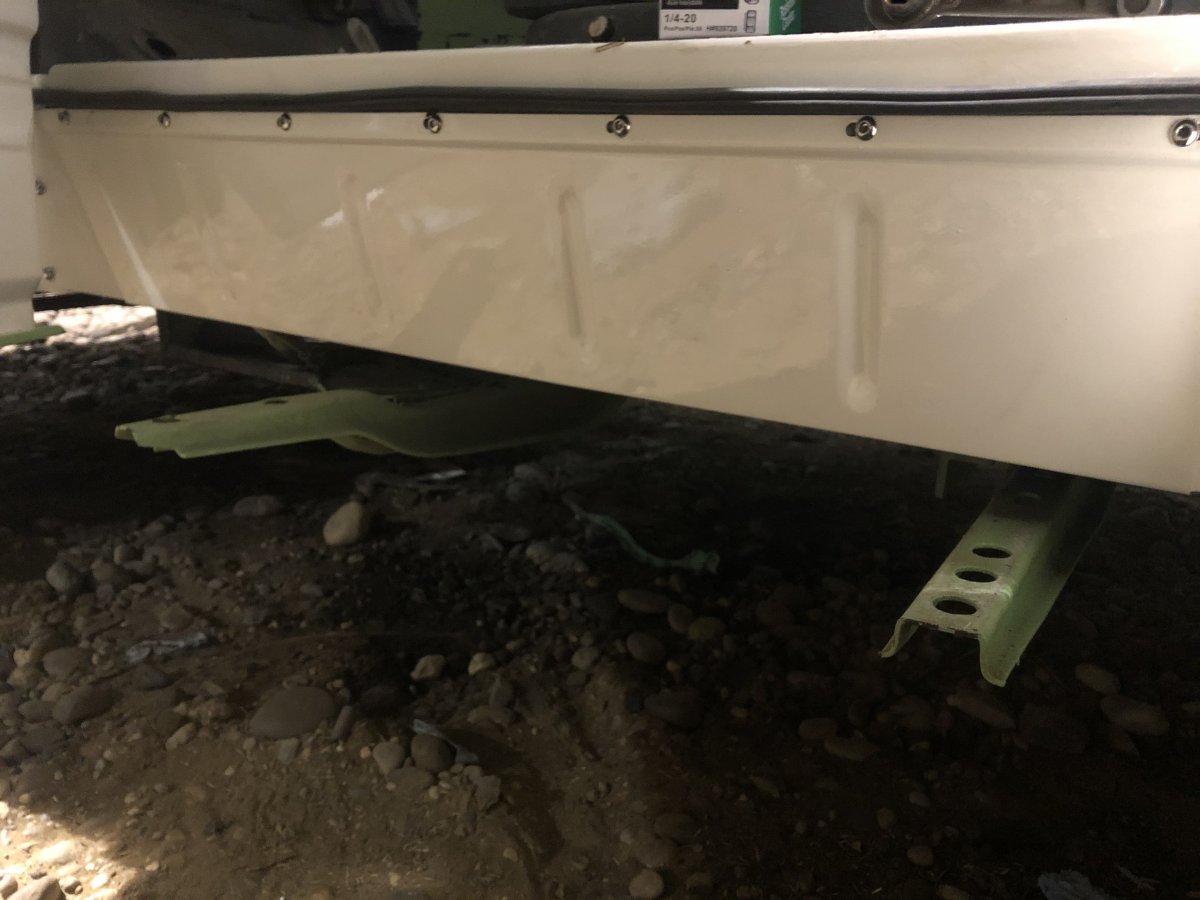

    F5C89F53-F69F-4A4E-86E6-56FB55CB5473.jpeg A few minor things done the last couple days, polished stainless bolts for the mirrors, I use my small belt sander to put a slight dome in the heads then polish. IMG_2359.JPG
    Then put the piece under the drivers door on, with stainless ****on head bolts, more polishing to make them shiny. Small details.

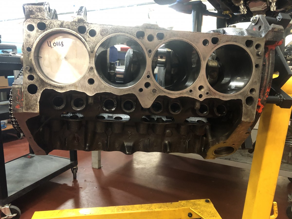

    Not much happening over the winter as I have a lack of heat in my shop, I did pick up a 360 to freshen up to put in the Fargo. As students are currently doing engines in our cl***, I decided it was a good time to have them work on it. Ended up going 0.020” over on the cylinders so new flat top pistons. We polished the crank and are installing new bearings. The heads had been done in the recent past so after measuring and cleaning they are getting new valve seals and going together. IMG_2537.JPG IMG_2538.JPG
    Picked up a cast iron 4 barrel intake, a factory 340 piece. Has a mild camshaft in it, should be a decent driver, nothing crazy. Should be a hair over 9:1 compression.
    As soon as the weather improves it will get painted and put in the truck.
    I forgot to take pictures of the block in the sunnen ck10 getting oversized, since it had a lot of wear and it was only going 0.020” over we didn’t set up the boring bar we just used co**** stones on the ck10 to get to within about 0.004”-0.005” and then switched to finer stones to get to within 0.0005” then the plateau stones for the final finish, all done by a student. He is now working on re***embly, gapped all the rings today and is in the process of confirming crank measurements and on Tuesday when we are back in the shop, he should have the short lock ***embled.

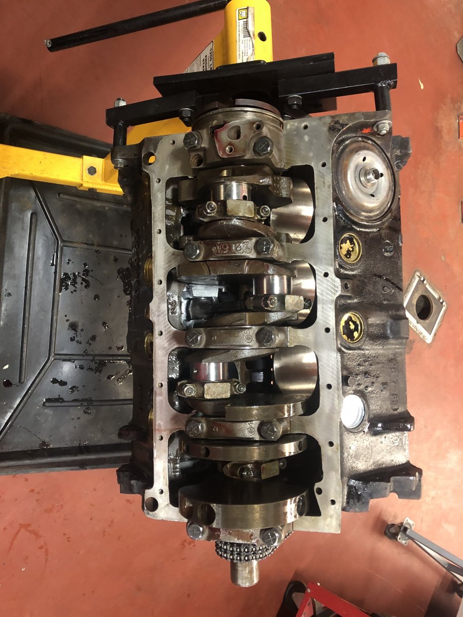

    1099F411-010F-4D8D-884E-5B39E84194DB.jpeg 2C871F50-286F-4522-8EF1-2CCD2407C696.jpeg
    Piston and rods going in, so far so good, another shop day tomorrow. Should be ***embled by the end of the day. Picked up a factory ‘71 340 intake for it.

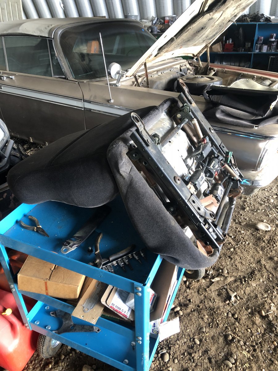

    2D58C5E4-84E9-4274-B1F6-DFDF1AA5C34E.jpeg 5DB8195B-36F4-4FB4-BEA0-8106B76B09DA.jpeg Had a water main break at the campus this morning so got the day off! Peeled the covers off the seats to send to Ashley at wicked s***ch upholstery care of @Lloyd’s paint & gl***.
