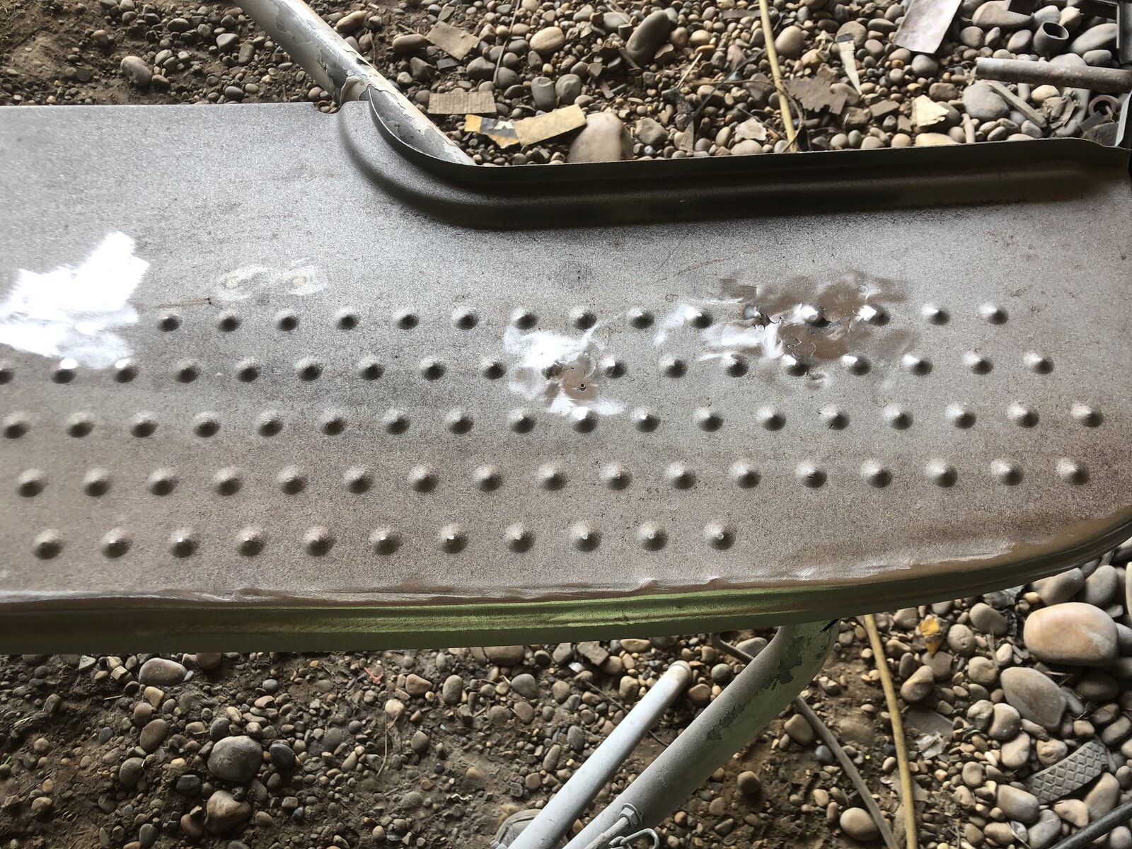

    Started on the right rear fender, spent some time with a hammer and dolly, should need minor amounts of filler.

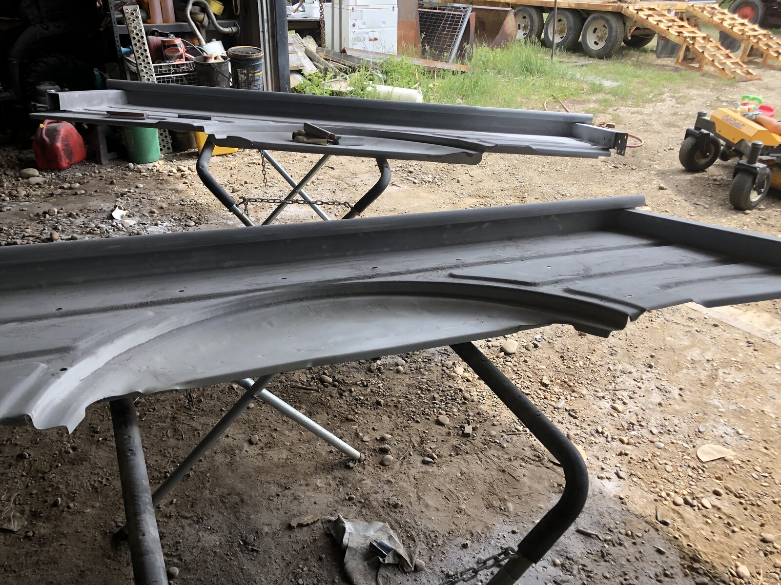

    Dent gone.

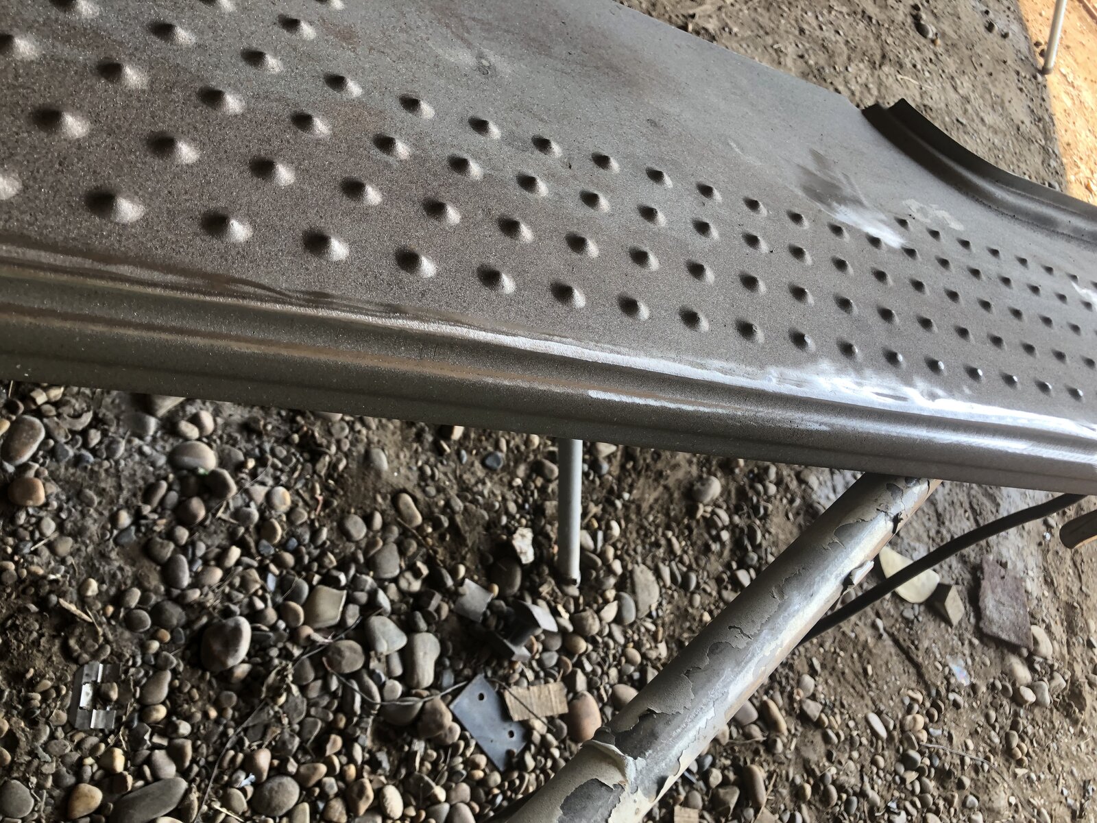

    Stripped the fender, welded a couple of cracks up, then on to body work...

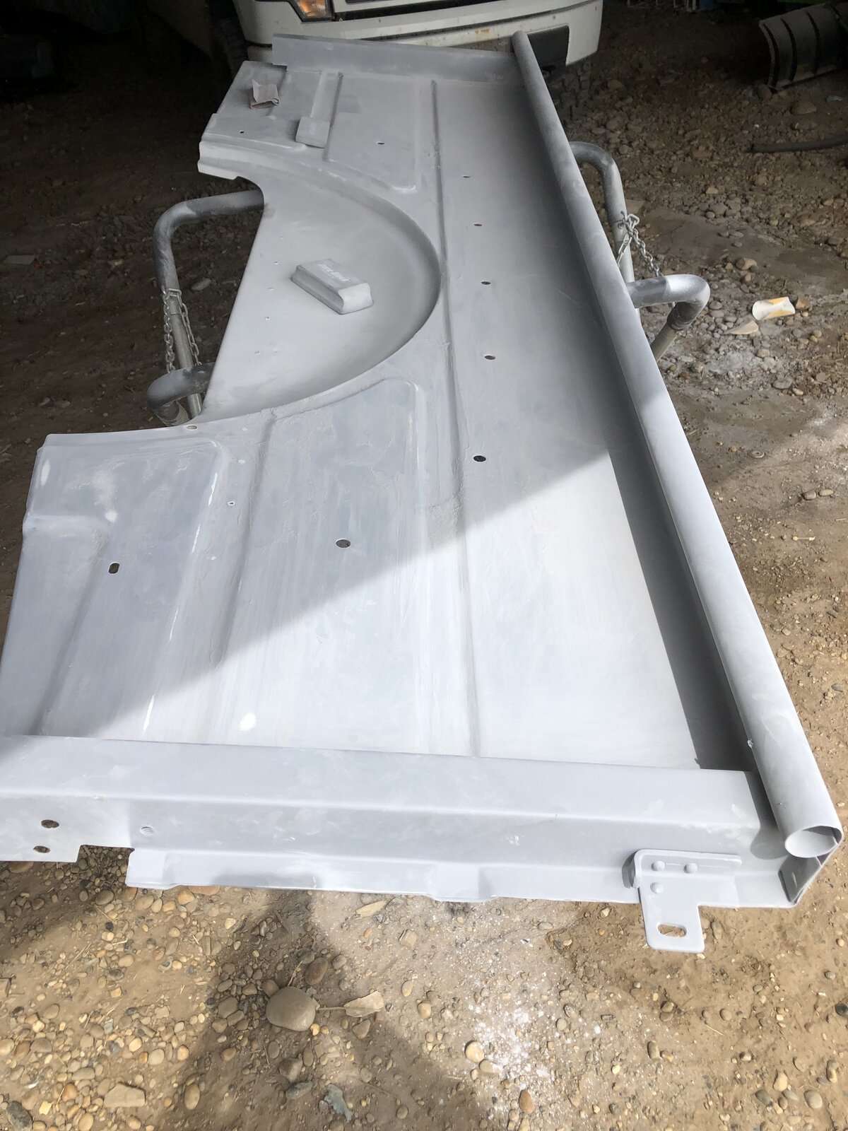

    28643C97-967E-4EDA-AFDC-750B62DB6960.jpeg 6293BBAA-EBA4-4422-AEC4-781667C6466F.jpeg

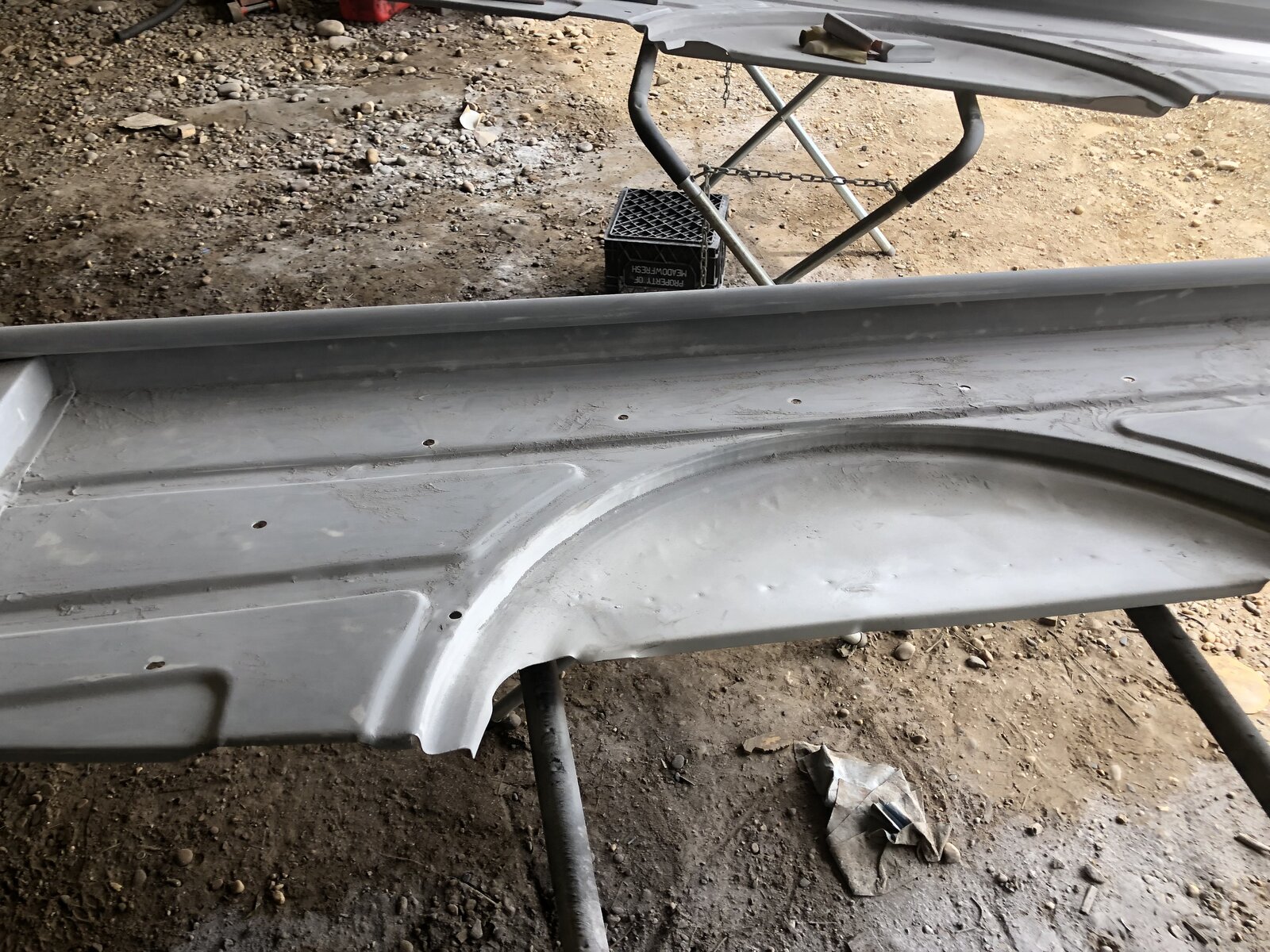

    Epoxy primer on the box parts that were mostly ready....then a couple coats of high solids ready for blocking. It’s supposed to rain for a week, nothing like primer to highlight how ****py your body work actually is!

    I only wish the box sides on my 49 were anywhere near as straight as your box sides are.
    Somewhere in my box history, someone drilled holes to mount 3 hooks onto the outside of box to secure a load. They must have had it tied down real tight, all 3 hook brackets on both sides have distorted the box sides where the hooks were bolted on. I've welded the holes closed and ground them flat, and hammered and dollied as much as possible. Still going to take a lot of filler on both sides to make them look somewhat smooth.
    Don't be mislead, the bed liner does not hide defects in the metal, if anything, it points them out even more. Gene

    Gene, mine are not terrible but not great either, both bed tops were bowed up in the middle and there was lots of hammering and dollying. Typical farm truck. I understand what you mean about the box liner but the reality is I’m not a talented enough metal worker to get both sides straight, filler is my friend, the texture does help distract from the waves! Plus it’ll likely get used as a truck a little. I really don’t care if it’s perfect it’s just an old farm truck from Saskatchewan! :)

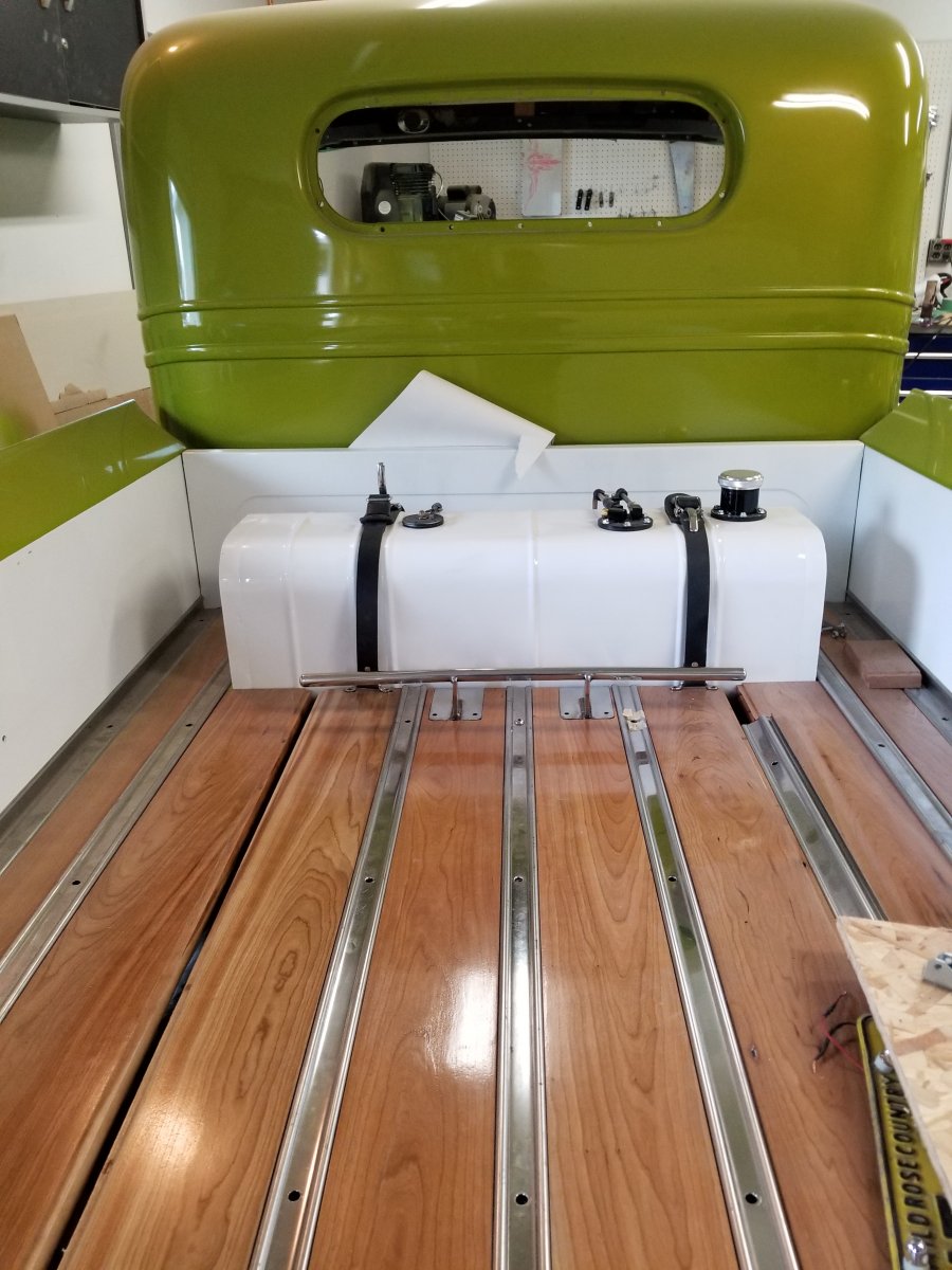

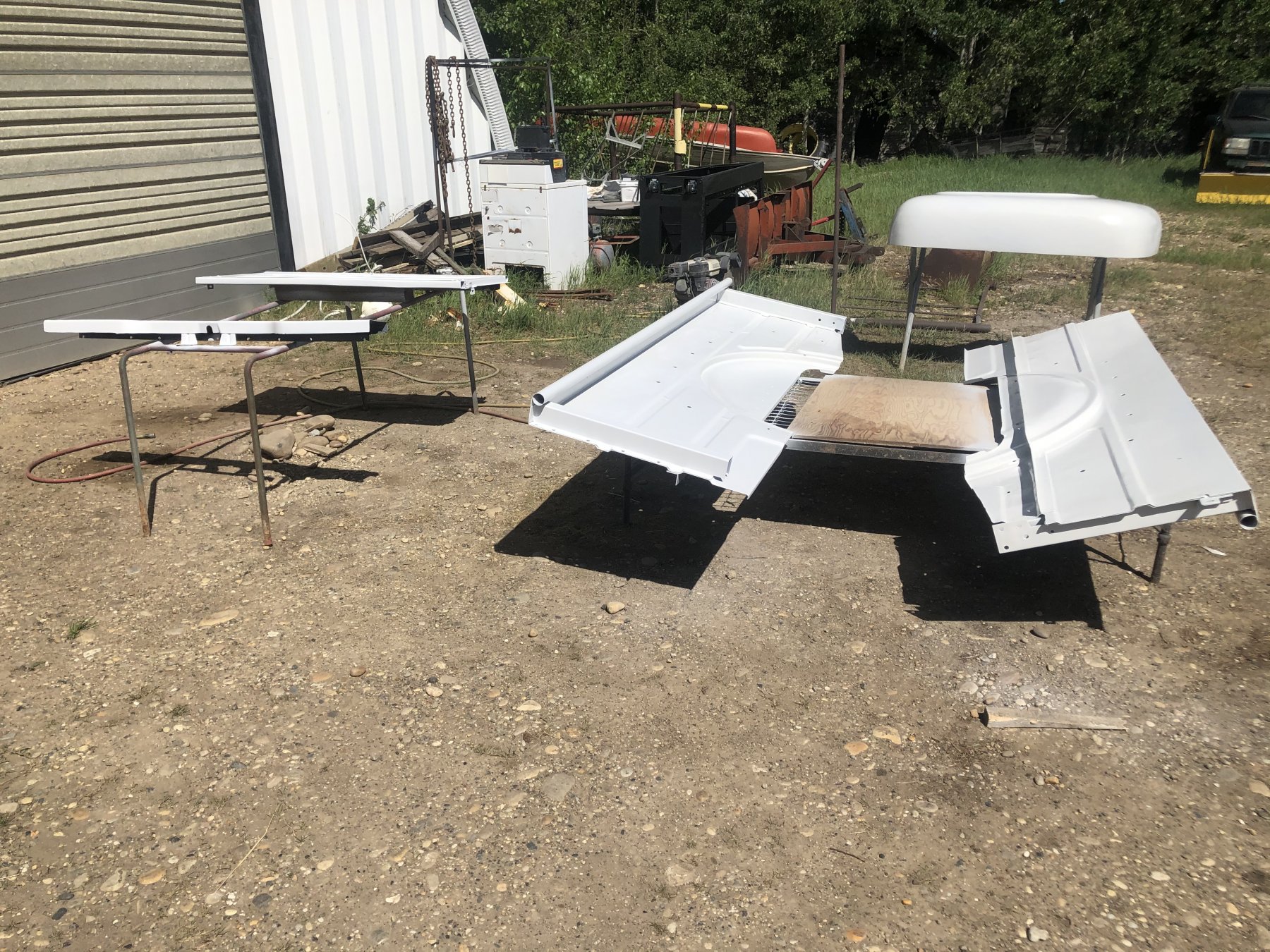

    Next thought, I’m considering doing the inside of the box white as well, opinions?
    Stogy and Lloyd's paint & glass like this.
  8. atch
    Joined: Sep 3, 2002
    Posts: 6,422
    atch
    You're talkin' white bed liner; right? Can you get that stuff clean again if you ever get it dirty? Note: I don't know. I've never had a pickup with bed liner in/on it. I think it would look good, but have this reservation.
    Stogy and loudbang like this.
  9. K13
    Joined: May 29, 2006
    Posts: 9,731
    K13
    Terrible idea.:rolleyes:

    Stogy and 57 Fargo like this.
  11. atch
    Joined: Sep 3, 2002
    Posts: 6,422
    atch
    Yes; that's beautiful. Also it's a slam dunk that no gravel or dirt gets hauled in it. I wouldn't even put suitcases in it if it were mine. Well; maybe if the suitcase was wrapped in a brand new moving blanket.

    Awe hell, I hadn’t noticed that’s how yours was. But thanks for making up my mind! ;)

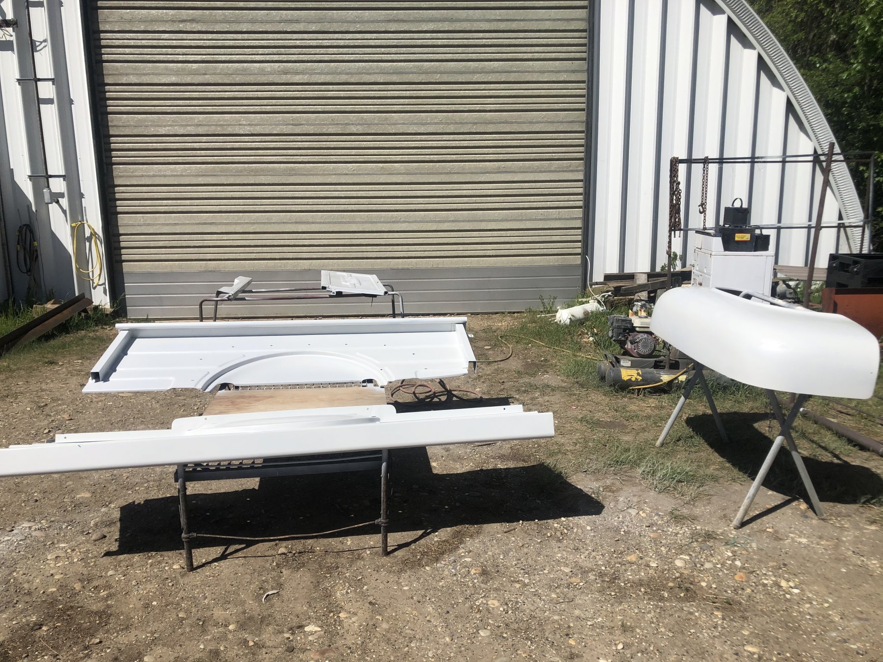

    A little slow here lately…when I put the high solids on my box parts apparently I mixed it with the epoxy activator. Not good. After many days of sanding and much ridicule from the paint tech guy (yes he laughed at me) I got it all off and laid down another coat of epoxy and high solids and now have both box sides blocked.
    Waiting for the running boards and front box panel to come back from the blasters then off to get the box liner done and the box painted.
    Then I can start ***embling the box on the truck for motivation while I strip the bad primer off the tailgate and finish up the bodywork on the fenders.

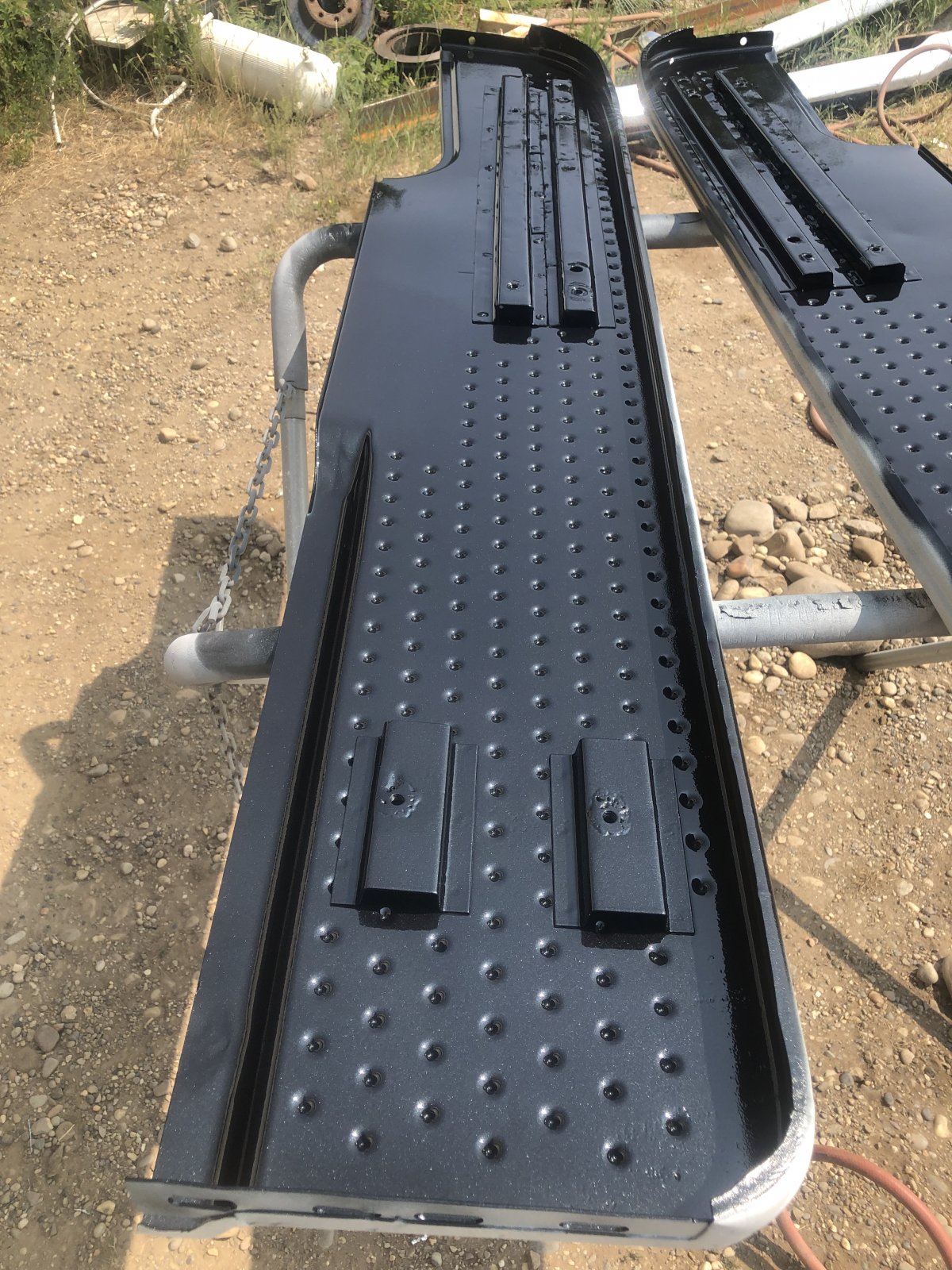

    37BF75F4-D02B-43B5-94FB-EBF6A445D226.jpeg 9253E669-0811-4F7B-A3D9-757B4176AD51.jpeg
    Picked up the running boards, and box front from the blasters this morning. Welded up a few pinholes in the running boards. Did a little bodywork on the box front. They will get some epoxy this afternoon then the box parts all go to get the spray box liner and paint, then ***embly begins on the box.
    I didn’t have intentions of making the running boards perfect, instead I just smoothed out the flaws. To me they are part of the character of the truck. It is just an old farm truck.

    I'd consider the bedliner coating on them running boards if it were mine.

    Oh they are getting it as well!

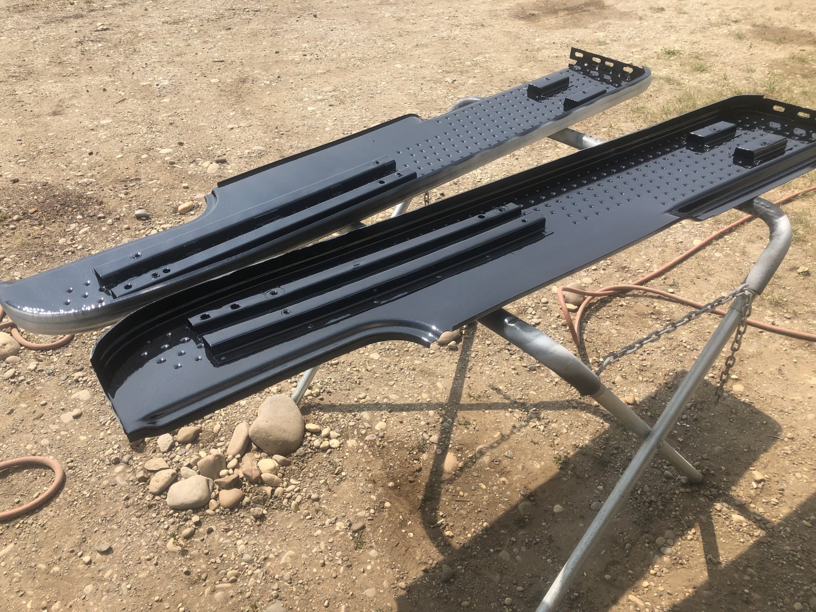

    19CEB780-7A2D-4996-A35C-F21F5B5CD48C.jpeg E491E044-30B1-470C-A4C6-9C2055DAF122.jpeg
    painted the bottom of the running boards. Hopefully box liner and paint will be done this week…

    Bedliner is great for the underside of the fenders and running boards if gravel is part of the future, it keeps the star chips in the topside from happening.

    not worried about box liner on the bottom of the running boards. The top side is getting some. The inside of the fenders is also getting some.
