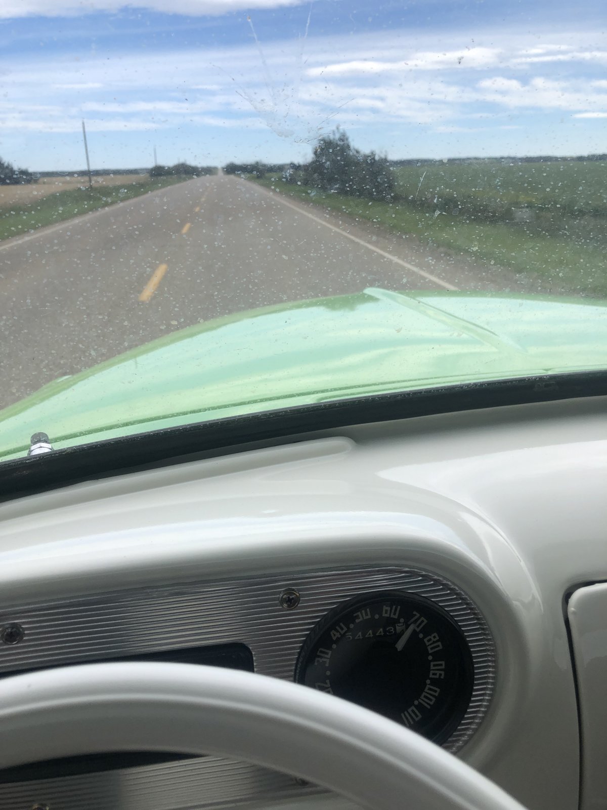

  1. Took the Fargo for a five mile test drive last night. Speedo doesn’t work, not sure why…temp gauge reads way high, going to try a different sending unit. And the linkage to the transmission needs adjusted, at full throttle it wants to shift at about 18,000 rpm! :eek: Overall it runs and drives decent aside from being really loud inside…ordered sound deadening this morning.

  3. Yea, it’s not overheating. Something is up with the guage

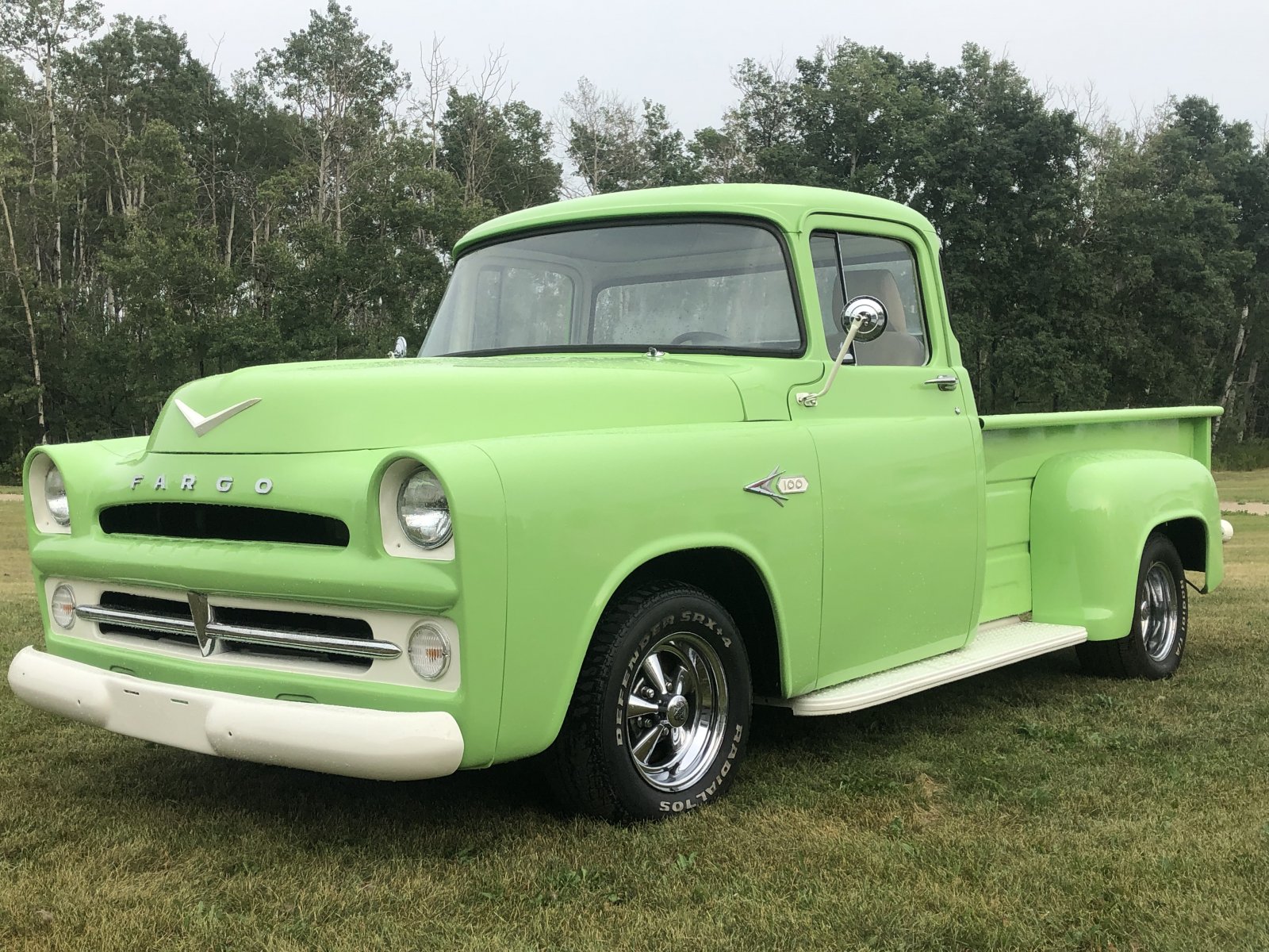

    installed the fuel filler. Little things.

    I worked on it yesterday a little, changed the temp gauge sender and it works now, pulled the speedometer gear out of the transmission and figured out I “clocked” the gear housing wrong when I put it in so that’s an easy fix except I managed to break the bolt that holds the retainer of the speedo gear housing. I pulled the tail shady and swapped it out for one I had on the bench here. I’ll finish putting it together today and get another drive in.

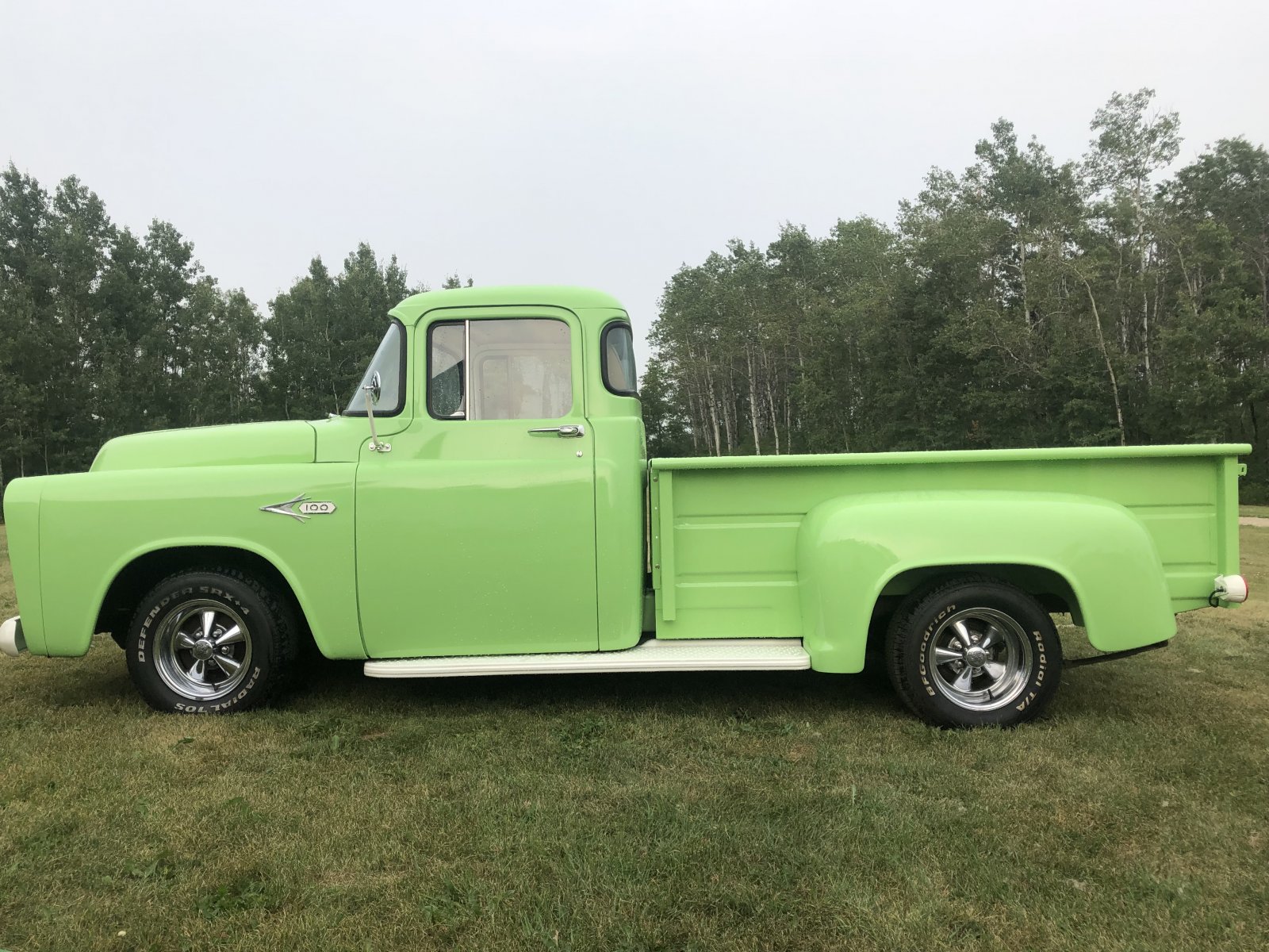

    Took the truck to town and home today. About 20 miles round trip. So far so good.
