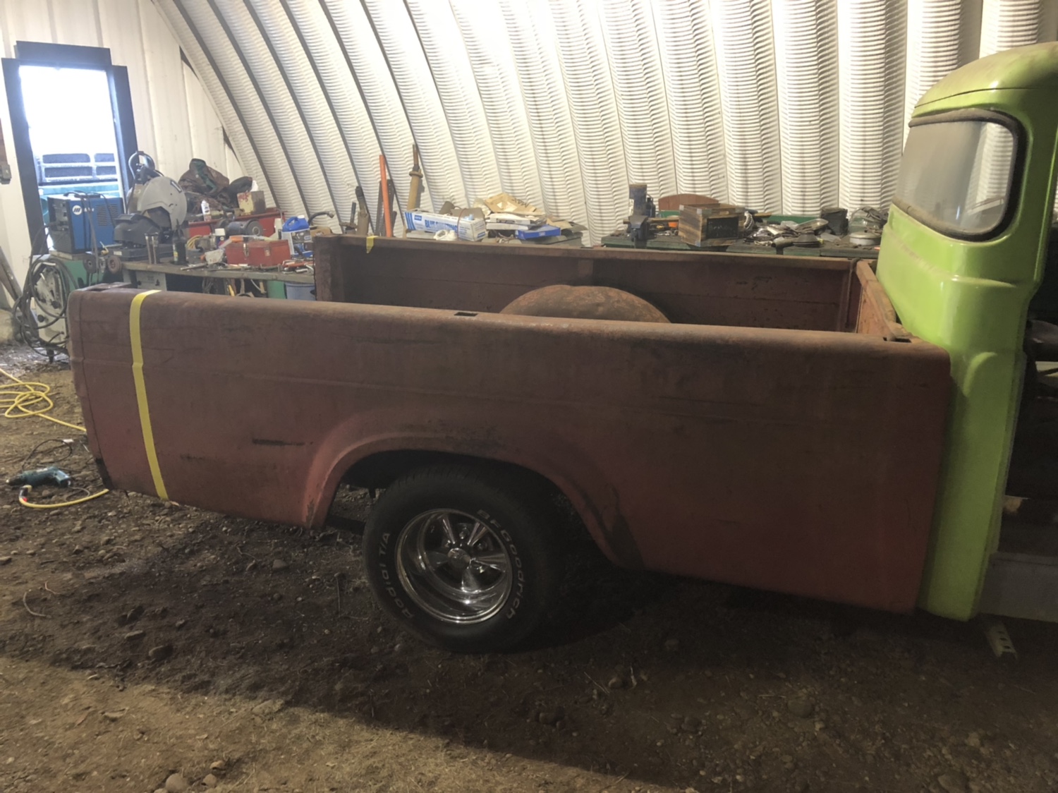

    So got the p***enger seat done, put the box back on and this happened....
    Now don’t expect any great metal working tips or anything, expect some Fantastic half ***ery and hillbilly engineering. A pro would have at least cleaned out the box first! Taking 9 inches out of the box, I didn’t like the overhang, hopefully I can put it back together...
    Before...
    Where we are headed...
    Notice my beautiful gravel floor and no heat so winter will interrupt at some point...and yes my benches are a mess...

    Had a couple short hours between teenage daughters volleyball and having to pick up and ***emble a swing set for a toddler so I decided to repair the removable transmission tunnel. Of course complete with suitably ****py pictures.... IMG_1471.JPG IMG_1472.JPG IMG_1473.JPG IMG_1474.JPG
    Apparently no before pictures...I’ll give it a quick dusting with the sandblaster and have it coated with box liner at a buddies body shop and call it good. If the weather holds out I may get a little more picked away at before it gets to cold. I have a couple lines on parts, I’m waiting to check out a couple of boxes before I do anymore on the one I have.

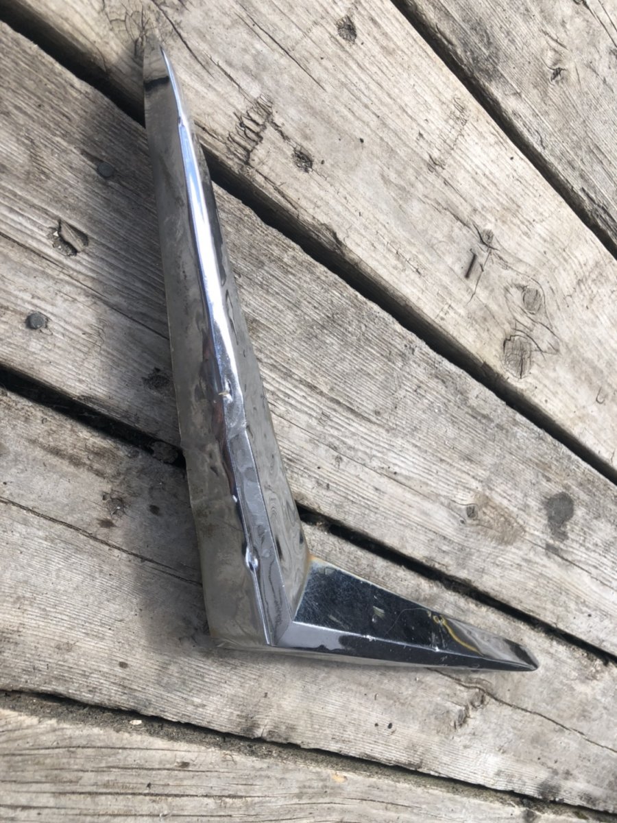

    Pulled a trim piece off the hood of my parts truck, not sure if I should use it or not, thoughts? Any who, it’s in really rough shape so while my two year old was napping I thought what the hell, surely I can’t **** it up any worse than how bad it’s already ****ed up. IMG_1820.JPG IMG_1821.JPG
    So in keeping with my low tech build theme, using my front steps and a claw hammer I had at hand, I proceeded to beat the hell out of it with m***ively low expectations of actually ending up with a usable piece.
    After a half hour of not so gentle m***aging using plastic trim removal pieces and the aforementioned claw hammer, I’m pleasantly surprised and somewhat determined to save it even if I don’t use it.
    Here’s where it ended up for now, at the fine pick and file stage soon, get it as straight as possible before polishing. Now the time consuming part starts.
