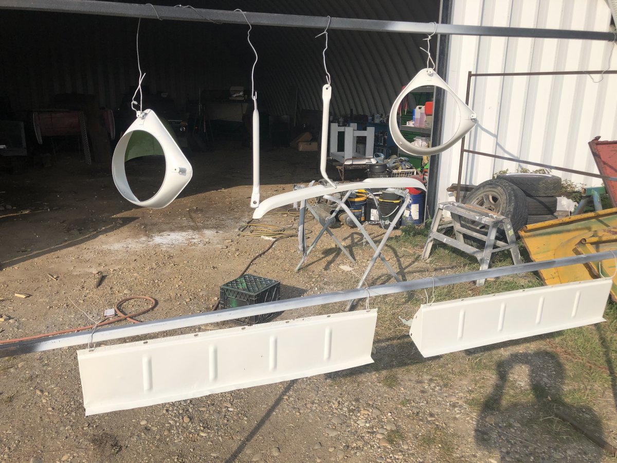

    You bet, I have some there already.
  18. 57 Fargo
    Joined: Jan 22, 2012
    Posts: 6,181
    57 Fargo
    Got the body work done on the front bumper, put high solids primer on it today, sand and paint tomorrow.
    Going to borrow a small blaster in the morning to blast the headlight bezels and mirrors then I can paint them at the same time.

  20. 57 Fargo
    Posts: 6,181
    57 Fargo
    CEB2C827-1012-455C-9B1B-A42EDD20C959.jpeg 0B3516DA-A53C-4D42-8A72-5440B8A57467.jpeg 3654ADD3-193E-4BCB-80ED-19A82B3CF54A.jpeg Go the little stuff blasted, block sanded the bumper then decided I would hammer a coat of epoxy on the bare metal stuff and on the bumper as a sealer then paint it. Well got the sealer on, laid down beautifully then these guys showed up...****...no paint today. Sand again tomorrow and figure out plan B...
  21. Lloyd's paint & glass
    Joined: Nov 16, 2019
    Posts: 10,876
    Flies in the vaseline we are :rolleyes: Never fails man. Nothing scares me more than a bug flying around the shop when I'm spraying paint lol. It's a helpless feeling
    loudbang and 57 Fargo like this.
  22. 57 Fargo
    Posts: 6,181
    57 Fargo
    I can live with one or two but wow! There was nothing at all, I went inside, cleaned the gun and this happened!! Some swearing and a proper kindergarten moment and here we are. Maybe I’ll try inside tomorrow, wonder if my wife will notice the air hose headed down the stairs....
