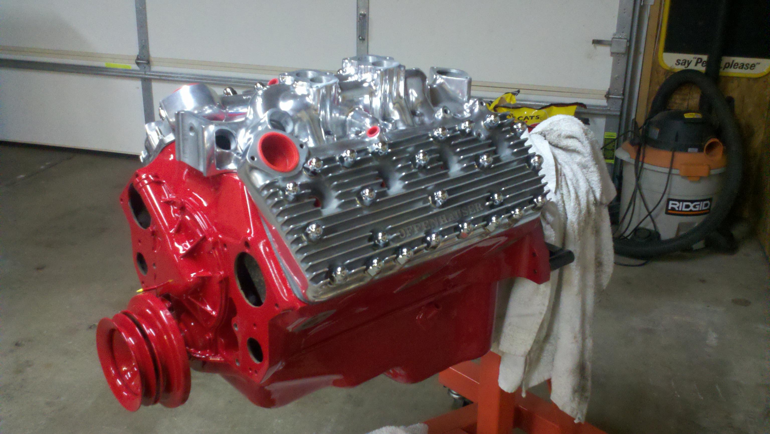

  13. I just installed some fresh offy heads on my engine yesterday. I was wondering if the pipe threads on yours were a little on the tight side. On my easel rock heads, the fitting seemed to go in farther with less effort.
    RLFFRL
  14. Edelbrock heads I meant, auto correct changed it to easel rock

    I could onlu get a few turns on the fittings on the heads. I used a pipe tap and cut them deeper. Make certian you put antisese on the threads.

  16. That's the same problem I'm having, it ****s because now they're already on the engine. I suppose a few shavings in there won't hurt anything.

  17. walter

    Thats when I figured it out, I dipped tht tap in 90 weight and the shaveings stuck to that. It realy took very little to tap them deeper.
  18. Right on, your flatty sounds good with a full exhaust. Mine is just wide open headers, been that way for years. I prefer the obnoxious hahaha!! So I guess that's what I'll do, just put something sticky on the tap and run it in.
