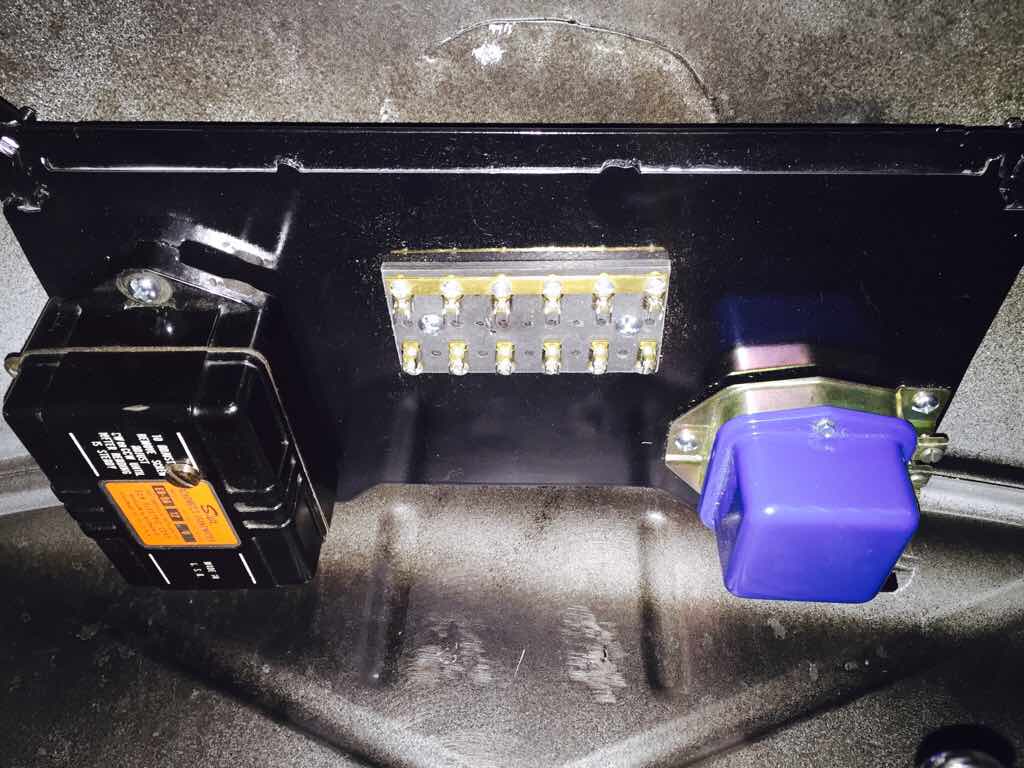

    Well I have been working on the roadster but nothing very glamorous. Built a fixture under the dashboard to provide a place to mount the tachometer brain, voltage regulator, fuse box, and relays. Then it was time to sand, stain, and varnish all the wood. I hope to spend some time installing it over Christmas.

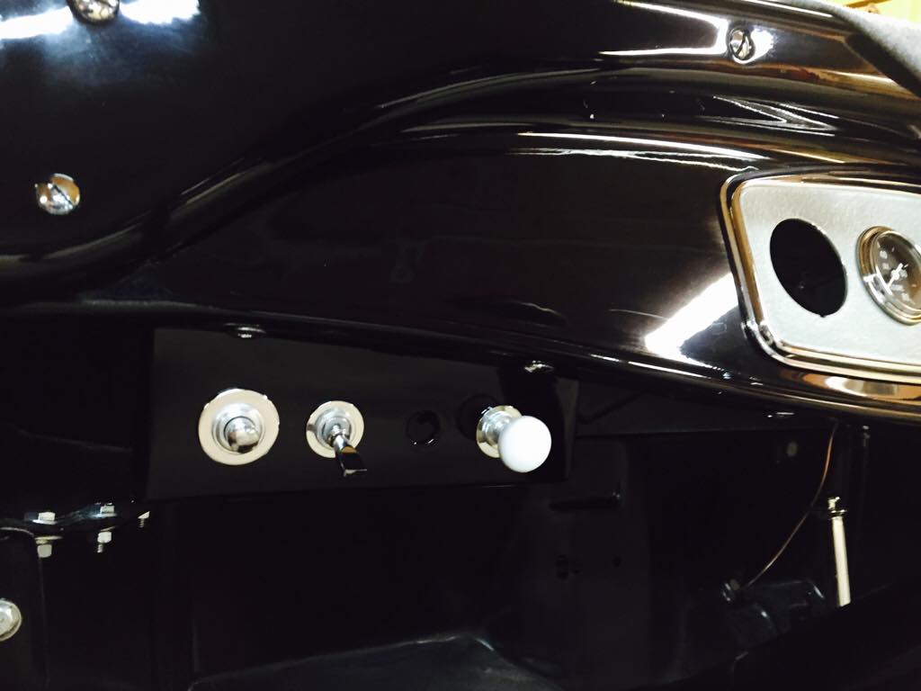

    Not much progress the last few weeks. It has been cold in the shop and I am getting old and lazy. I did get a panel built to warehouse the switches and choke under the left side of the dash. I also built a trap door to gain access to the master cylinder reservoir. Still waiting on some Plateing to come back and the rest of my gauges to ship. ImageUploadedByH.A.M.B.1421844632.436474.jpg ImageUploadedByH.A.M.B.1421844646.437382.jpg

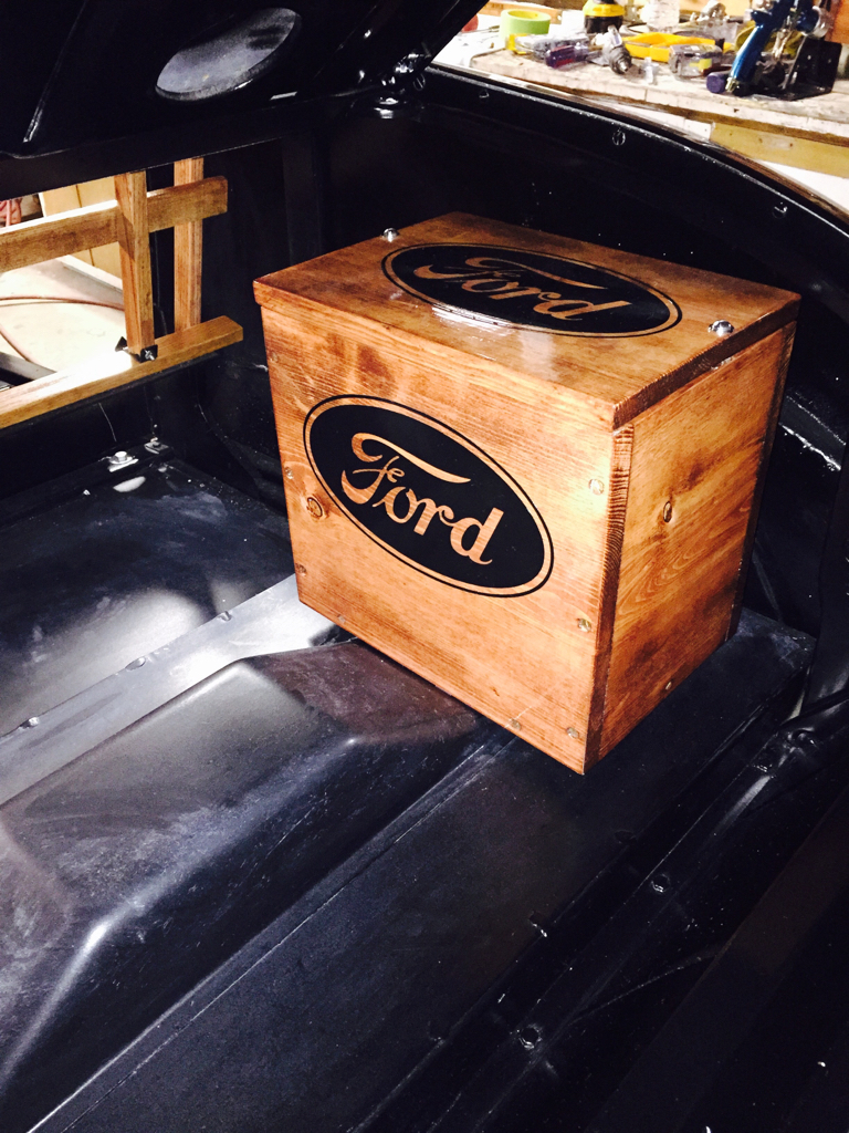

    ImageUploadedByH.A.M.B.1422659679.182182.jpg ImageUploadedByH.A.M.B.1422659726.274403.jpg ImageUploadedByH.A.M.B.1422659749.880848.jpg
    Battery box is completed. Period correct Ford logo in basic shipping box. I fee more things to locate and I will be ready to string wire!!
