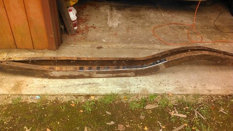

    I spent the weekend out in the garage listening to the Bonneville live feed and working on the coupe off and on. I got the rail welded up and tweaked back into shape.

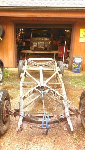

    Then I jury rigged a set up to remove the body. Working alone can be quite a pain in the ***.
    The way the body is sitting it may be easier to do the frame outside. I think doing one rail at a time, cutting it loose from the crossmembers and reattaching it before welding the splice, it should stay square if I brace it and support it on stands. I can put the stands on 2x12s to level it. Maybe this week if the weather holds out.

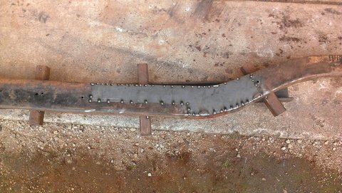

    It's been a while since I posted an update. I just started working on it again. I got the good front half of the frame attached to the rear section I repaired. It's stagger seamed and plated on the inside with plug and perimeter welds.
    I still need to make the sections to connect the x brace at the back, then boxing plates.
