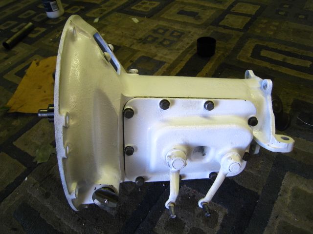

    I really want to see what the trans looks like inside. The outside looks bad. A bunch more cleaning before I open it up.
    Looking inside things were looking really good. Brass syncro rings looked great. Maybe my grinding into gear was a bad clutch adjustment.?? Now I'm thinking "clean it, front seal and it's good to go. The u-joint felt really nice too.
    Then I saw pain. The gear cluster had a couple chunks taken out of it and the second/reverse gear was chewed up.
    Put those on the list too. HAMB want ads here I come.:)

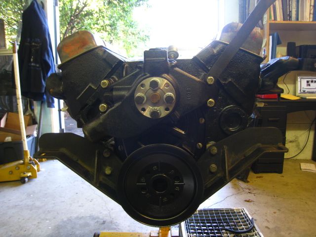

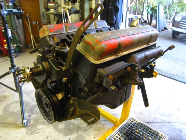

    Been getting some stuff done motor wise.
    New timing chain, front seal, and gasket.
    Rear main seal, again.
    Sand blasted the replacement exhaust manifolds and high temp. coated them.
    Cleaned the block like the dickens and painted it. Couldn't do the bright orange, so black it is.
    I'm liking the valve covers one minute, the next minute I'm not so sure. Maybe take the rest of the paint off of them and see. ?? I do like the purely functional aspect of the galvanized covers.
    Once my dirty mismatched 97s are on top, the room might come together. :rolleyes:
    Trans is waiting on the cluster gear then it can go back together too.

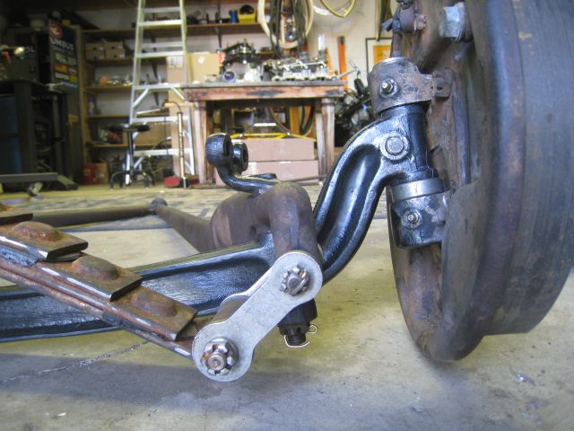

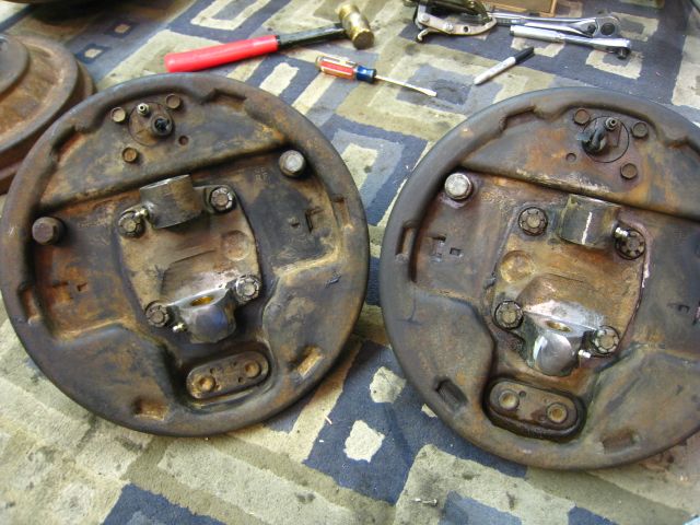

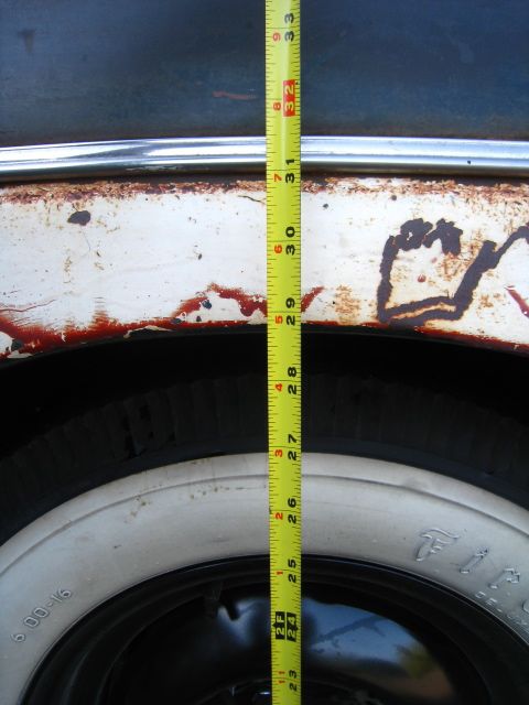

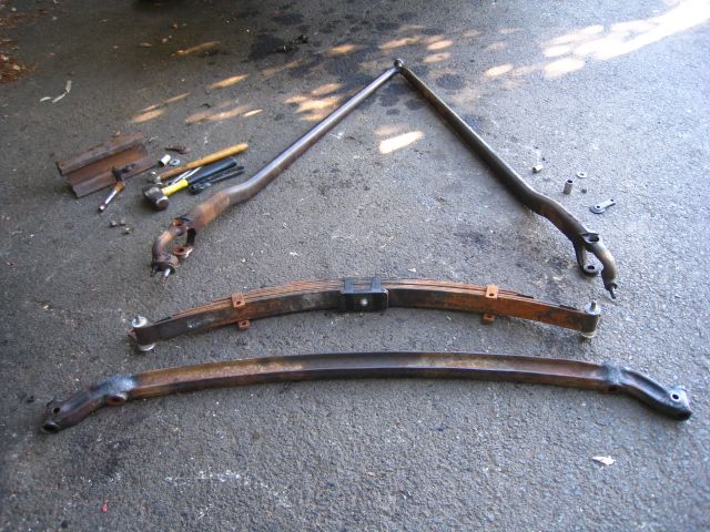

    After putting the 16s on the front of the car the front got a little taller, too tall. It already has a reversed main leaf so earlier I pulled a couple leaves to see where it would end up. Dropped a little, but not enough.
    At least it didn't make the front end feel too soft. Feels pretty good actually.
    My buddy Harvey (117Harv) has been dropping axles lately, and doing a really nice job. So it seamed a natural to yank this one out and give her "the drop". If we get 2 inches out of the '46 axle awesome. We're thinking 1 + is more realistic. Not much material to work with between the perch and kingpin holes.
    Out came the front end. It put up a fight. Especially the perch bolts. Those will need some work to be usable again. Ruined the threads but that was it.
    I've been dragging around an unknown shackle kit for years. Turns out to be the front kit for a '46 so those will get installed too.
    The height measurement is without the motor, radiator, and transmission.
    Here's how she's sitting tonight. Tomorrow we drop.

    Mike Britton, Seen springs like that before, never on the front though. I think I'd change it too. The spring removal isn't too bad. Easiest if you pull the whole front end.
    Don't be surprised if when you put a new reversed eye main leaf in there that it actually gets higher then lower. Heard of a few where that's been the case. Old spring was saggin' a bit I guess.
    When I pulled a couple leaves out I tried to keep everything but the spring attached and it was quite the shit show. Got it done but definitely wouldn't have been a "winner" on tech week.
    We destroyed (chopped) the shock and sway bar links when we pulled the front end. I had a neat little pusher tool but we should have used a bit more heat on the eyes on the joints.
    Our parts list for the front end work:
    new 3" sway bar links
    new 4" shock links
    big rubber ball for the radius rod pivot
    new or repaired perch bolts
    perch nuts
    spring shackles (since they were already on the shelf)
    *note to self: take pic of tool to post on here, add part numbers if I got 'em too.

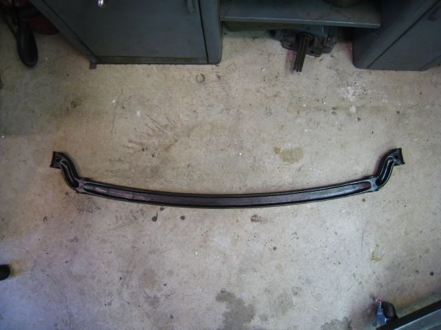

    Here's a shot of the axle with a rattle can of black.

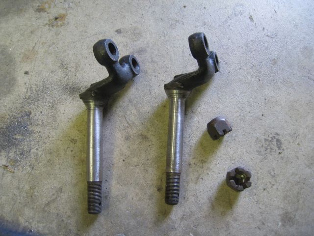

    In anticipation of some parts showing up I figured I should prep some parts, test fit etc. That's when I found out that the steering arms aren't going to clear the axle. Figured that would be the case but not that bad. The normal heating and bending of the arms isn't going to give it the clearance it needs.
    So i did what a normal hot rod dude would do and chopped them off. Has thought about relocating the arms, but the idea of the bushing holes distorting from all the welding, etc. lead us to think that bolt on arms are the best option.
    Tomorrow I'll be making a call to Chassis Engineering to get a set of there dropped arms. Looks like there's are the only ones that will clear.

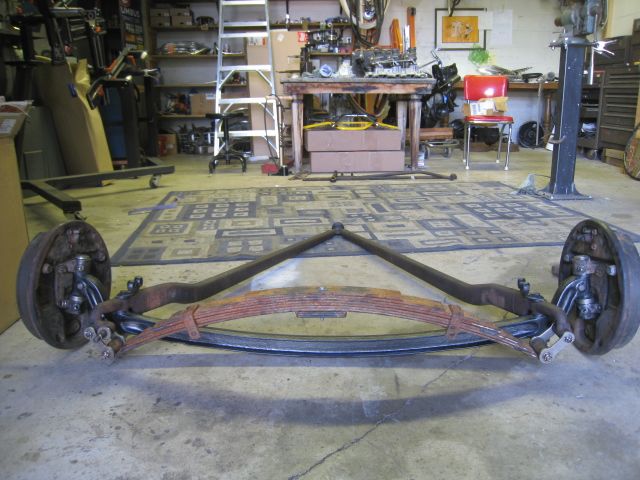

    Perch pins showed up today! So I was able to get most of the front end assembled. It took a little grinding in the perch and king pin holes to get thing to fit up. I used a carbide burr and did a little at a time. The end result was a nice, tap it with a plastic mallet fit. :)
    Used some anti-seize on the pins so that 50 years later they might come out a little easier.

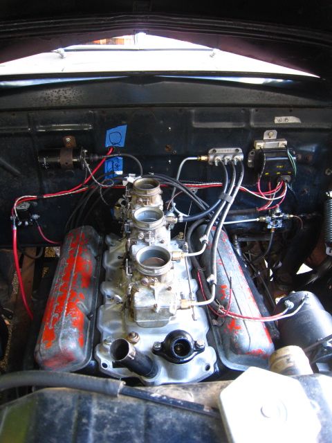

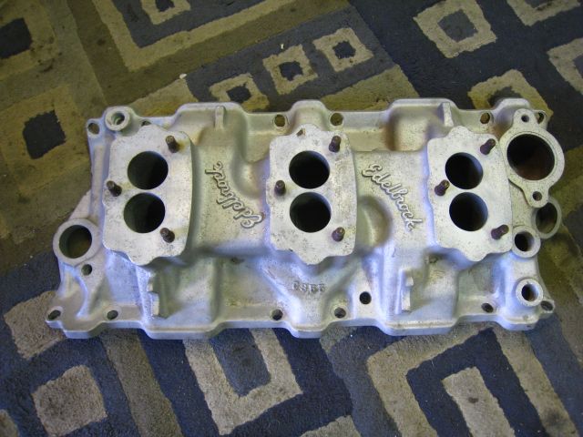

    Yesterday and today I worked on the intake, carb assembly and actually got it installed.
    Filled it up with oil and water and tried to start it.
    All I was getting was an occasional back fire out of one carb.
    Turns out that I had run the wires to the dist. counter-clock wise instead of clock wise. Once I swapped them to the way god intended, it fired right up!!
    It ran/runs, but pooped out when I gave it gas. When I bi-passed the progressive linkage and ran all three it ran much better. Not sure what that means.
    Not enough fuel from the main carb? Jets, power valve thing?
    I've never done a 3x2 setup with progressive linkage. We'll see how that goes tomorrow.
    I AM STOKED. :)

    This weekend has been the longest. I ordered the steering arms from Chassis Engineering last week. I was hoping "Brown Santa" was going to drop them off Friday. I'd be driving this thing.
    BTW, Those folks at Chassis Engineering are great. Super nice on the phone, and didn't make me feel like I was wasting there time. :)
