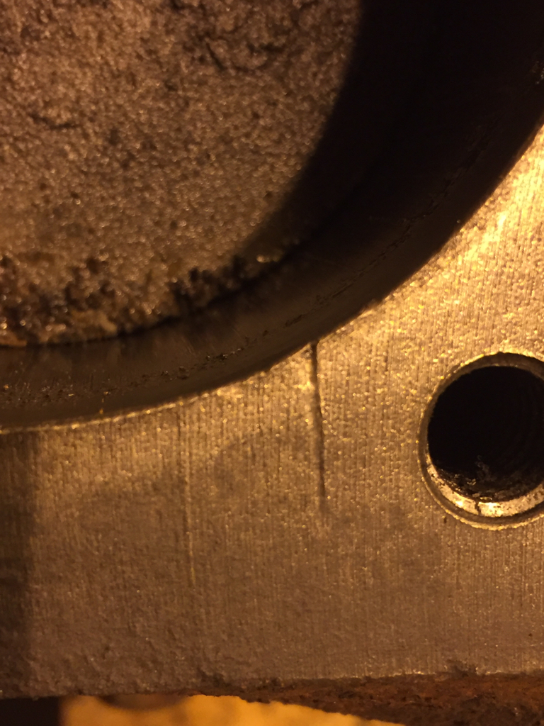

    I've read a lot about these blocks being notorious for having cracks. I cleaned the surface to see if any were visibly noticeable. I did find one that appears to be a crack. One that looks like a crack at first glance, but might just be a casting mark. And a couple of areas around the valve seats that have pitting.

    There are liquid penetrant test (LPT) kits out there that anyone can use for crack detection. It usually is 3 can kit of solvent, dye, and developer. Clean the area well then spray the dye on an let it sit for 20 minutes or longer so that it can creep into the cracks. The dye is oil based and will creep into everything if it is clean. Wipe the area with a cloth lightly dampened with the solvent to remove the dye on the metal surface. Give it a minute or two then spray it with developer. The developer leaves a white powder coating and the dye in the cracks will literally bleed red clearly showing where cracks exist. Surface imperfections are more like blushes and not as intense as a crack. This would allow a person to find any cracks that are not easily seen. Should it reveal fatal cracks then you can seek guidance on whether it is salvageable or toast before investing a lot into a block.
    If you know anyone who does testing and inspection for industrial piping and boiler code work they may be able to borrow & use magnetic particle testing, It still requires a cleaning but will indicate cracks where contaminants may not allow the oily dye used in LPT to creep into the cracks. The advantage of MPT is that it will show cracks even if the crack is filled over with crud or just sub surface. If cracks are machined out then followed up with MPT then it is possible to see if the cracks were eliminated or continue on. Machining smears the metal over micro cracking so it is not visible to the eye but it still shows up with testing. We used it to chase cracks in large pressure vessels. We would use a pencil grinder to gouge out the crack, test and keep repeating until the metal is cleared then weld it back up.

    that probably is a crack you found. very common and nothing to worry about.

    I agree about the "part number" crack not being a problem; the other does seem to be a surface flaw of some sort.
