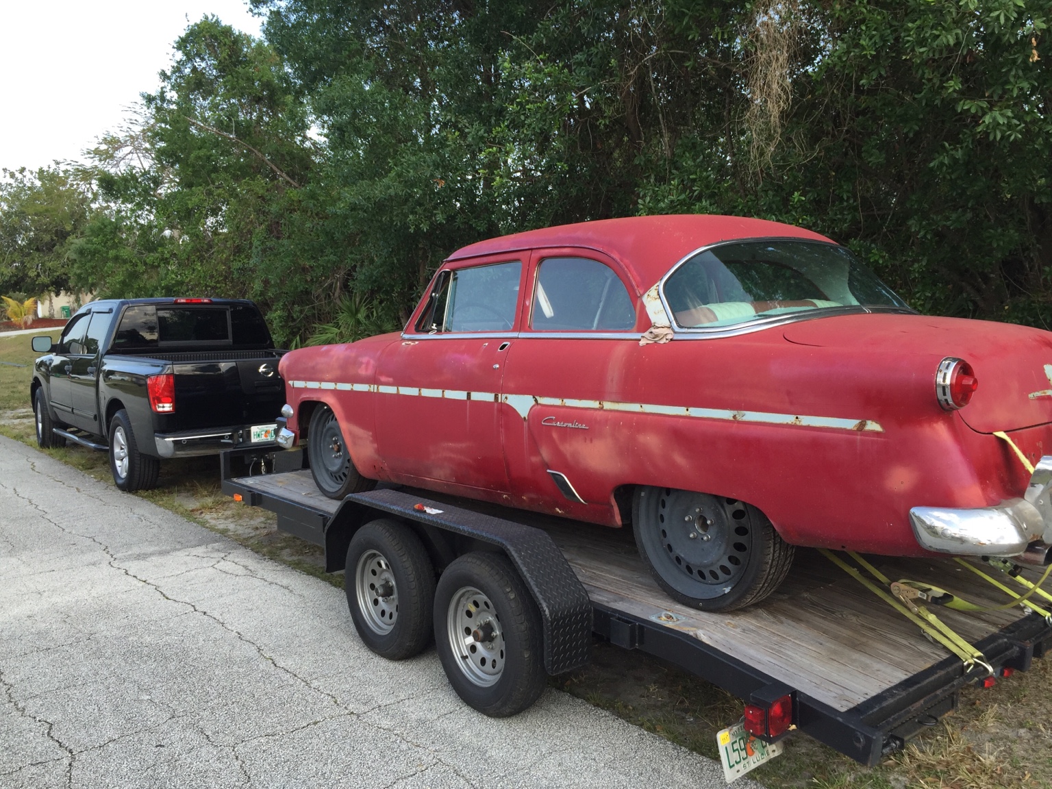

    After selling my '53 Mainline 5 years ago, I immediately regretted it. The car seemed to disappear(I looked for it, wanting to purchase it back). I ended up purchasing this '54 Customline and drove it 3.5 hours home from Jacksonville.
    Well, that's when life got in the way. I had a child(beautiful little girl), went back to school and started a new career as a machinist.
    The '54 sat, and sat, and sat.(clutch rusted to flywheel, brakes froze up). Now I'm starting to have some time to play with it, but it's still a slow go.
    The car has a 302 out of a '69 mustang that runs pretty good, and a factory 3 speed manual in it.

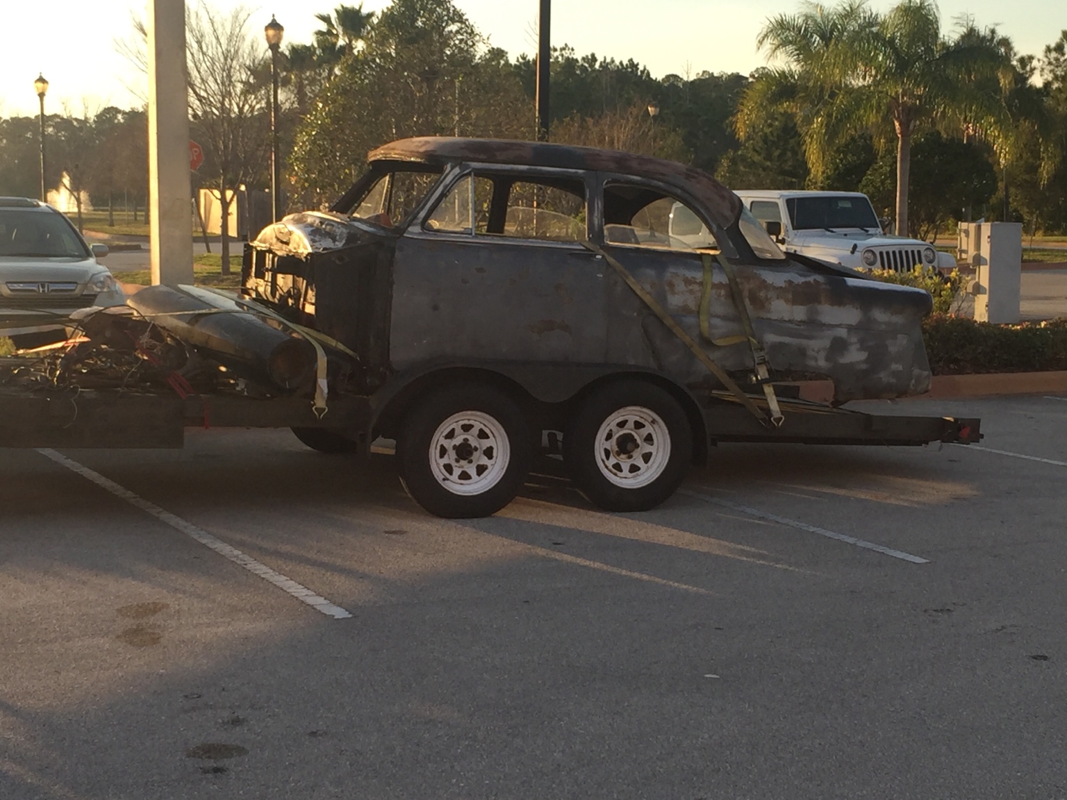

    I also bought a nearly complete '54 parts car too. I've got 3 spare hoods, 2 extra sets of fenders & enough interior trim to do 3 cars.

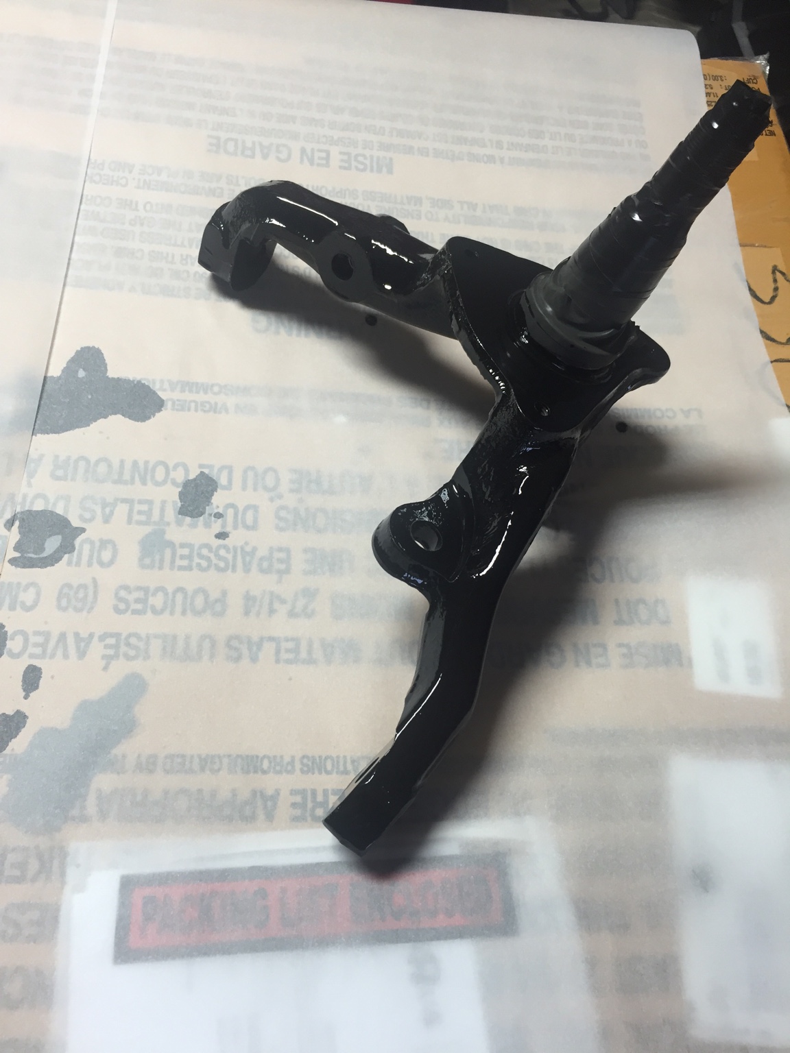

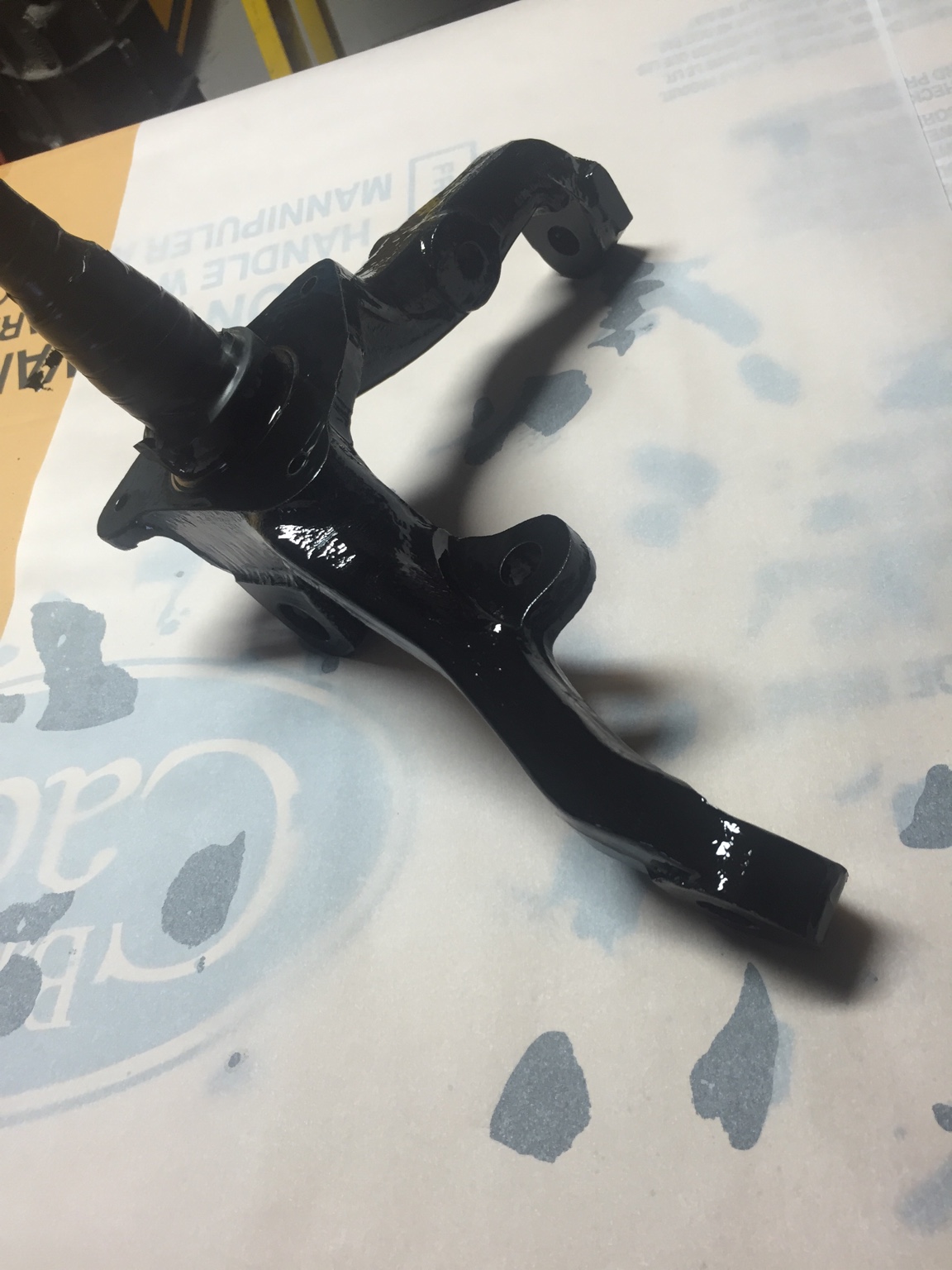

    Reamed lower balljoint holes at the shop on Tuesday & gave the spindles a fresh coat of Por15 today after work.
    Baby steps.

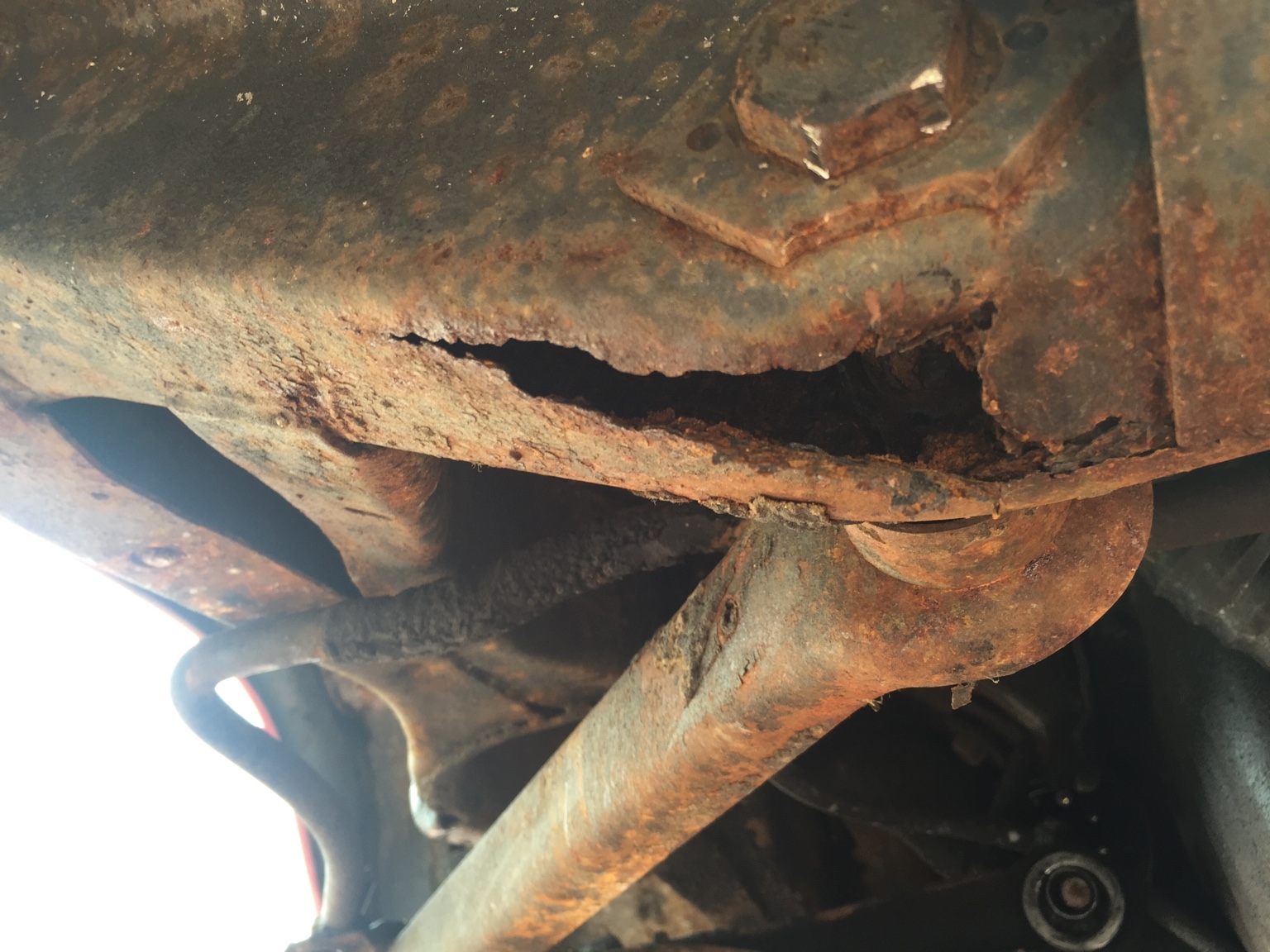

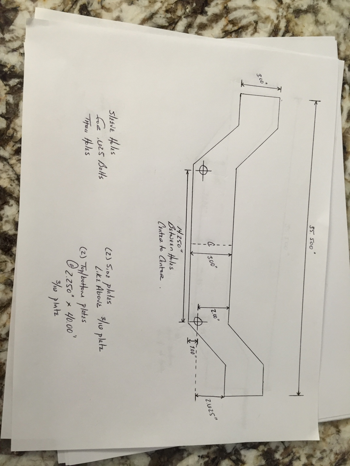

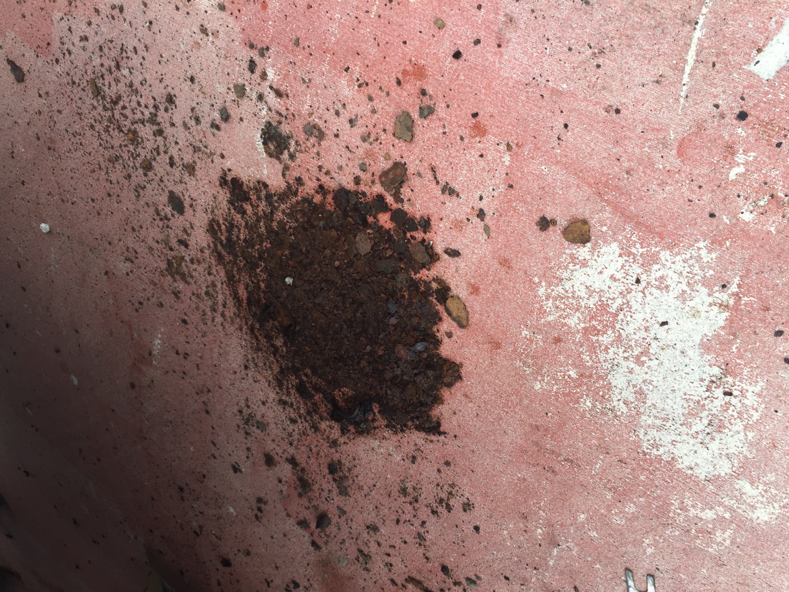

    So while disassembling and removing the control arms this morning, I found the forward crossmember that the lower arms mount to is ROTTEN. Unsafe to drive on type of rotten.
    Not a happy camper today. Now I either need to find a donor chassis to take the crossmember out of, or cut some plate out on the waterjet and fab up a new one. Either way, this is a fairly substantial setback.
  10. Great pictures and a great car. I like it (but then, what's not to like?). As for the cross member, might I suggest checking out Dennis Carpenter and Bob Drake. They may have what you need.
  11. That's not a uncommon problem,you can fab up a new crossmember. HRP
    Lowdownfab likes this.

    Yeah. I started taking some measurements today. I'll start cutting some plate at work first of the week. I'll get it fixed. Just kind of a kick in the nuts finding that when you're not expecting it. [​IMG]

    Had a couple minutes to draw it up properly at work. Hoping to get all the pieces cut this week so I can start gluing them together this weekend. Been busy busy at work though, fingers crossed.

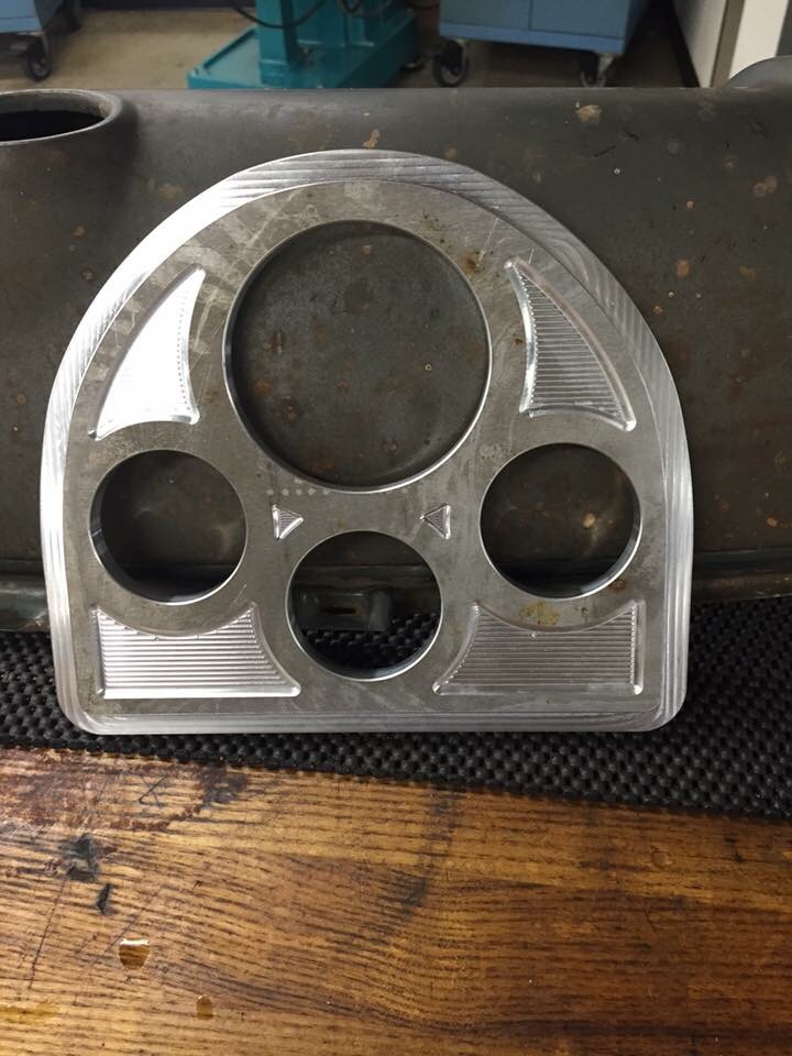

    Not really related to the build of my car, but a Pinstriping buddy of mine made me something pretty badass & I've gotta show it off. [​IMG][​IMG]
    clunker and chryslerfan55 like this.

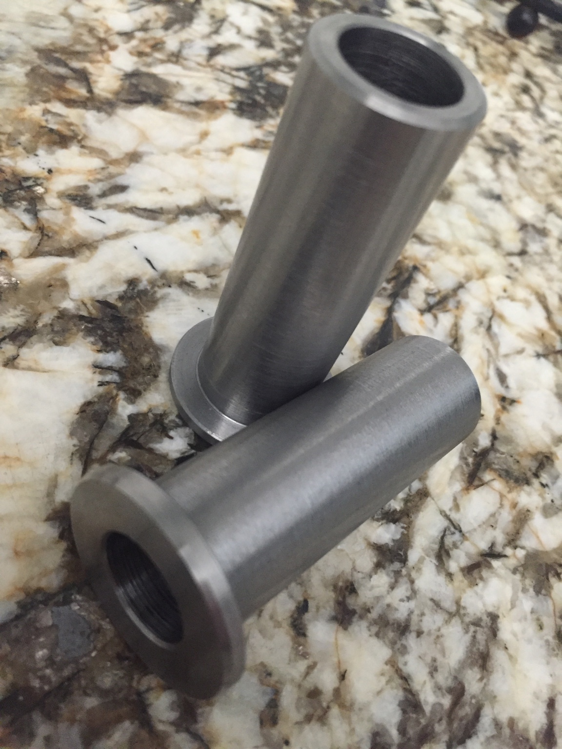

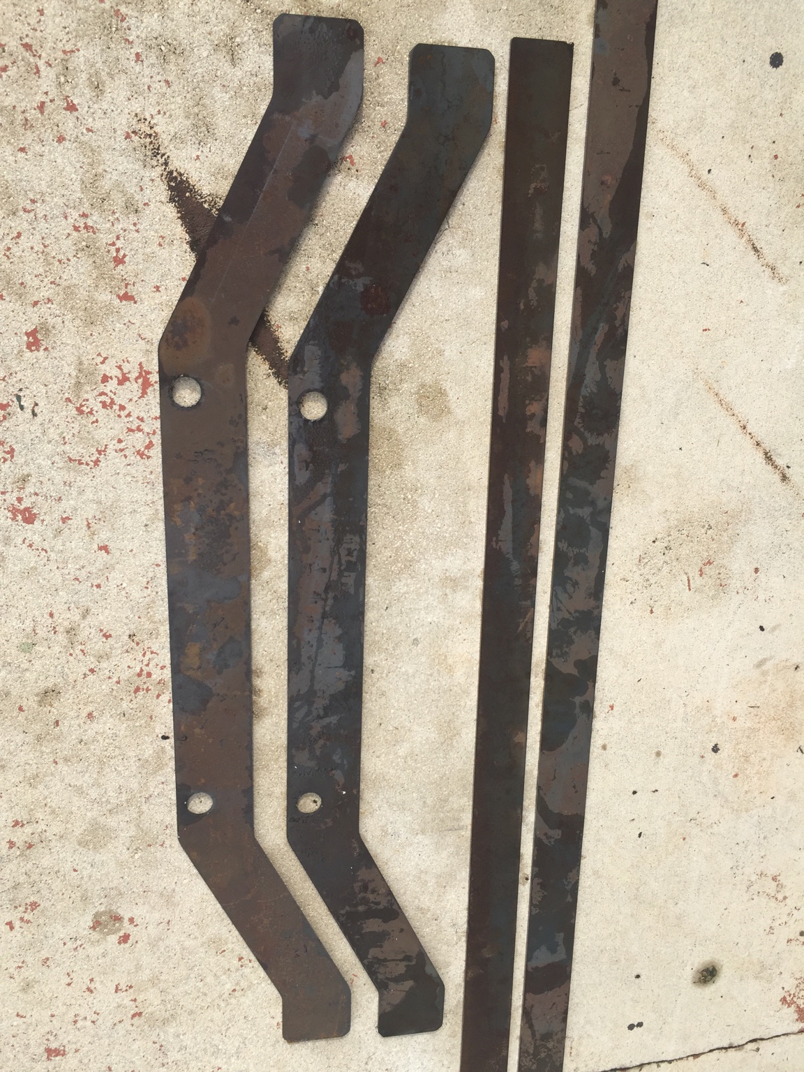

    Knocked out a couple sleeves on the lathe yesterday, for the control arm bolt locations on the new crossmember. Made them flanged so I've got plenty of area to weld them in.
    3/16" plate will be cut tomorrow for the crossmember itself. Hoping to have it all together and ready to install in the car by the weekend.......if we don't get a hurricane that is.

    With this hurricane heading our way I haven't done much, other than prepare for it.
    I did however finally get the 3/16" plate cut on plasma table for the crossmember. Should go together pretty easy.......if the car, house, parts, welder & tools don't blow away this weekend. [​IMG]
