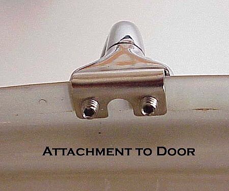

    Why about one of these type of brackets, found on most peep mirrors.
    It could be mounted straight to the gl*** then

    vonschmidt;
    I do believe that those screws will shatter the gl***, at a min cause runs. I doesn't take much pressure, esp concentrated in a small area to destroy the surface tension on gl***.
