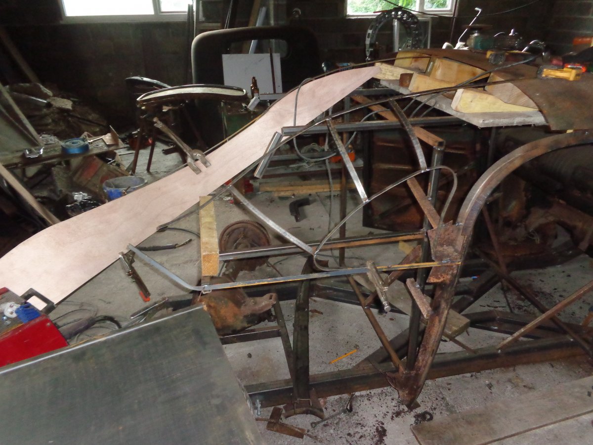

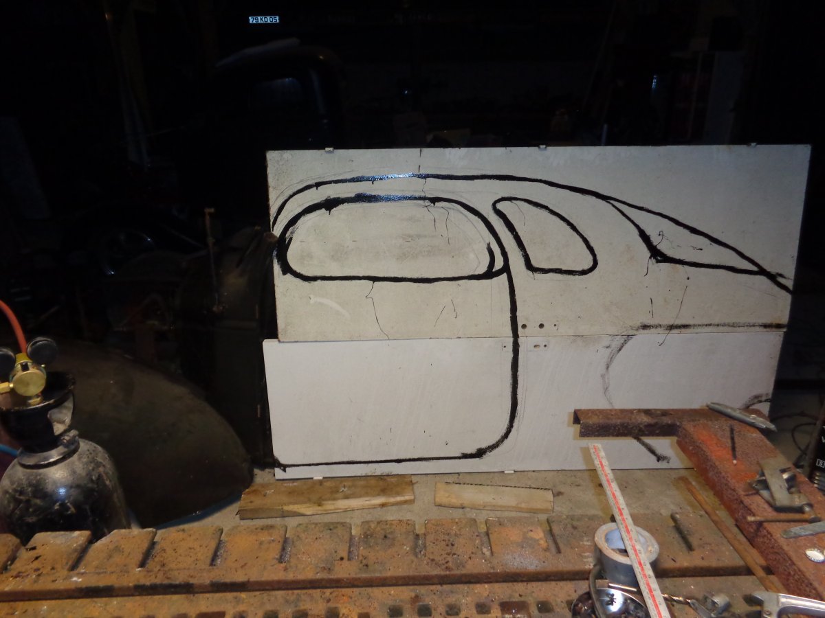

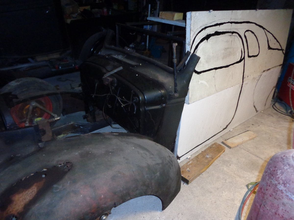

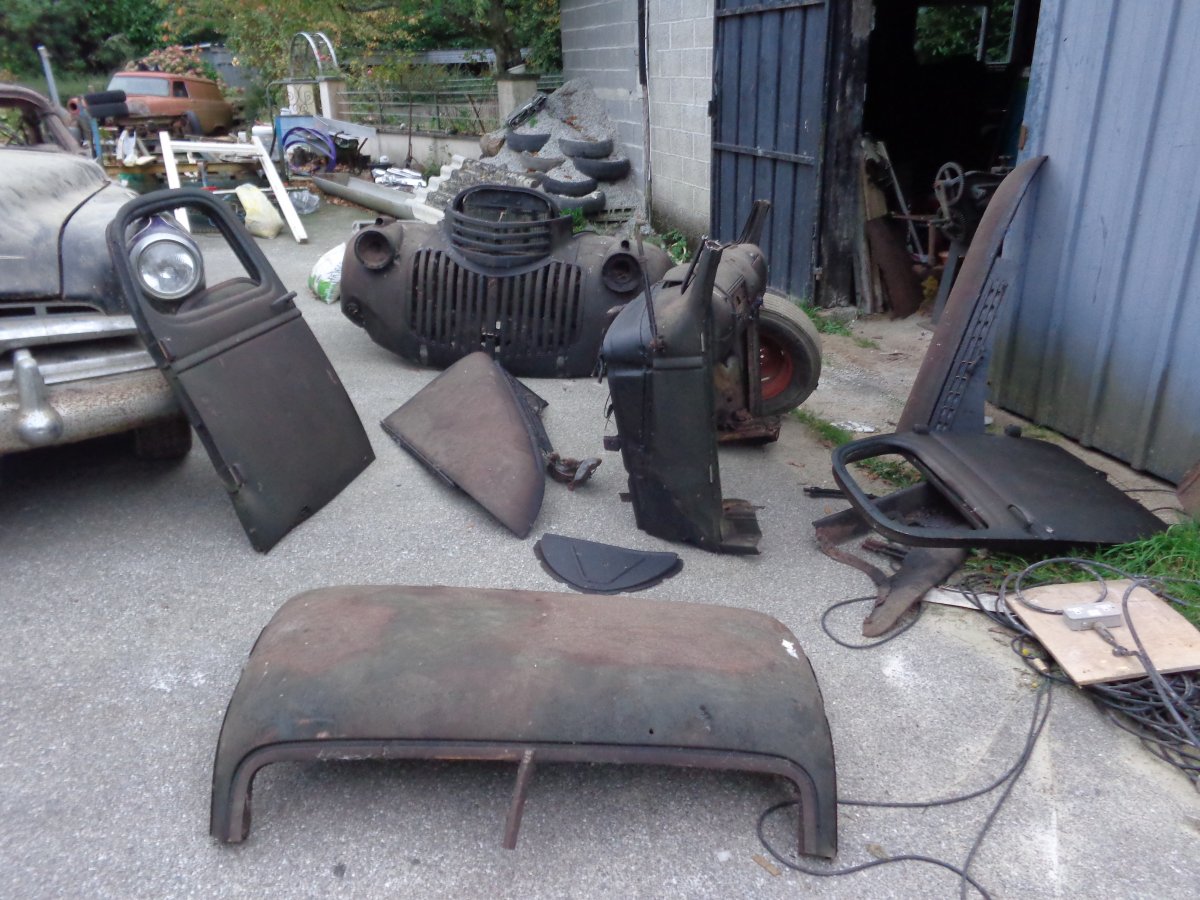

    Well as is fairly obvious. I have no access to CAD and I have better things to do with my life than to learn how Photoshop works. So armed with a case of beer,2 internal doors and a 1inch paint brush. This is the plan i'm working to. Thats a 4inch chop,9inch stretch on the doors. 126ish wheel base. Finishing at about 17ft long. Still don't know on coupe or slope back?? Nearly to scale the brush leaves me a little leeway

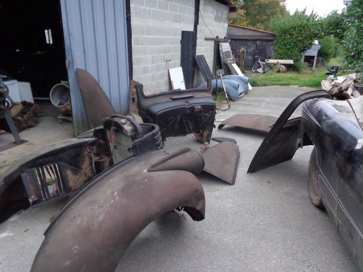

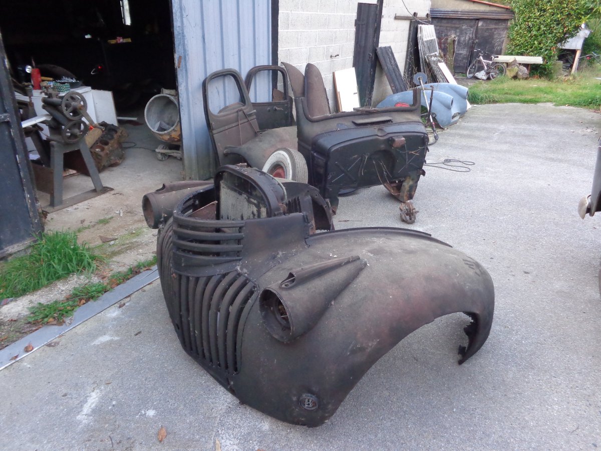

    Bonjour mon ami. What's the grey colored, "bug eyed", front end in the background? I'm guessing the primer red "Delivery" is a Ford Courier, but it's hard to see much of the car. I vote Coupe for the car/truck. Au revoir. I am Butch/56sedandelivery.

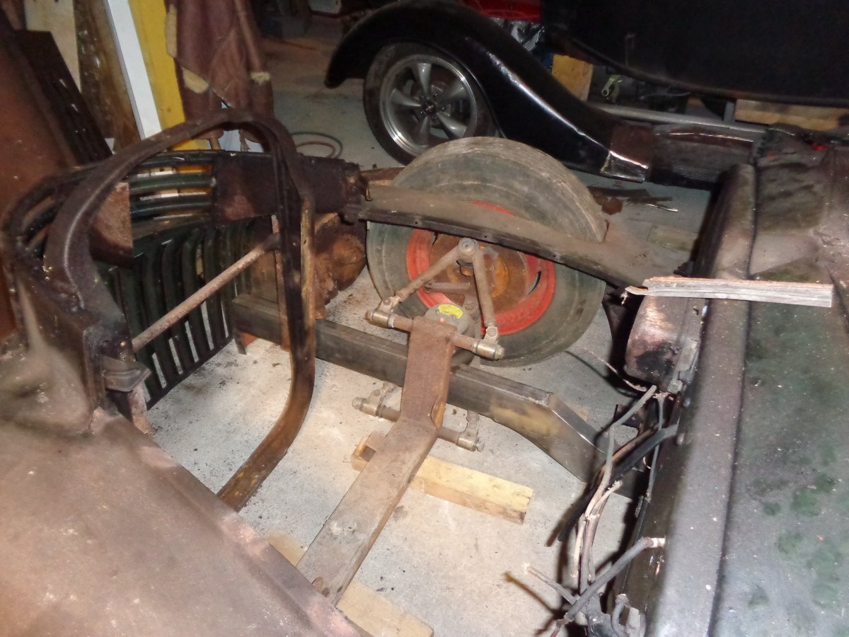

    Front end is 38 Willys. Panel is a60/61 Ford consul 375. English. Bit like 56 Ranch wagon 2/3 size. Still not decided on body style. Get the doors made and the roof on over the weekend and see which way it pulls me

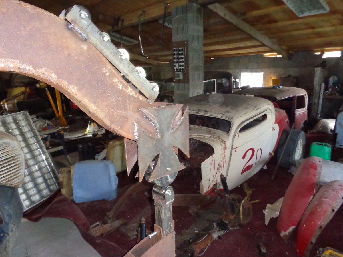

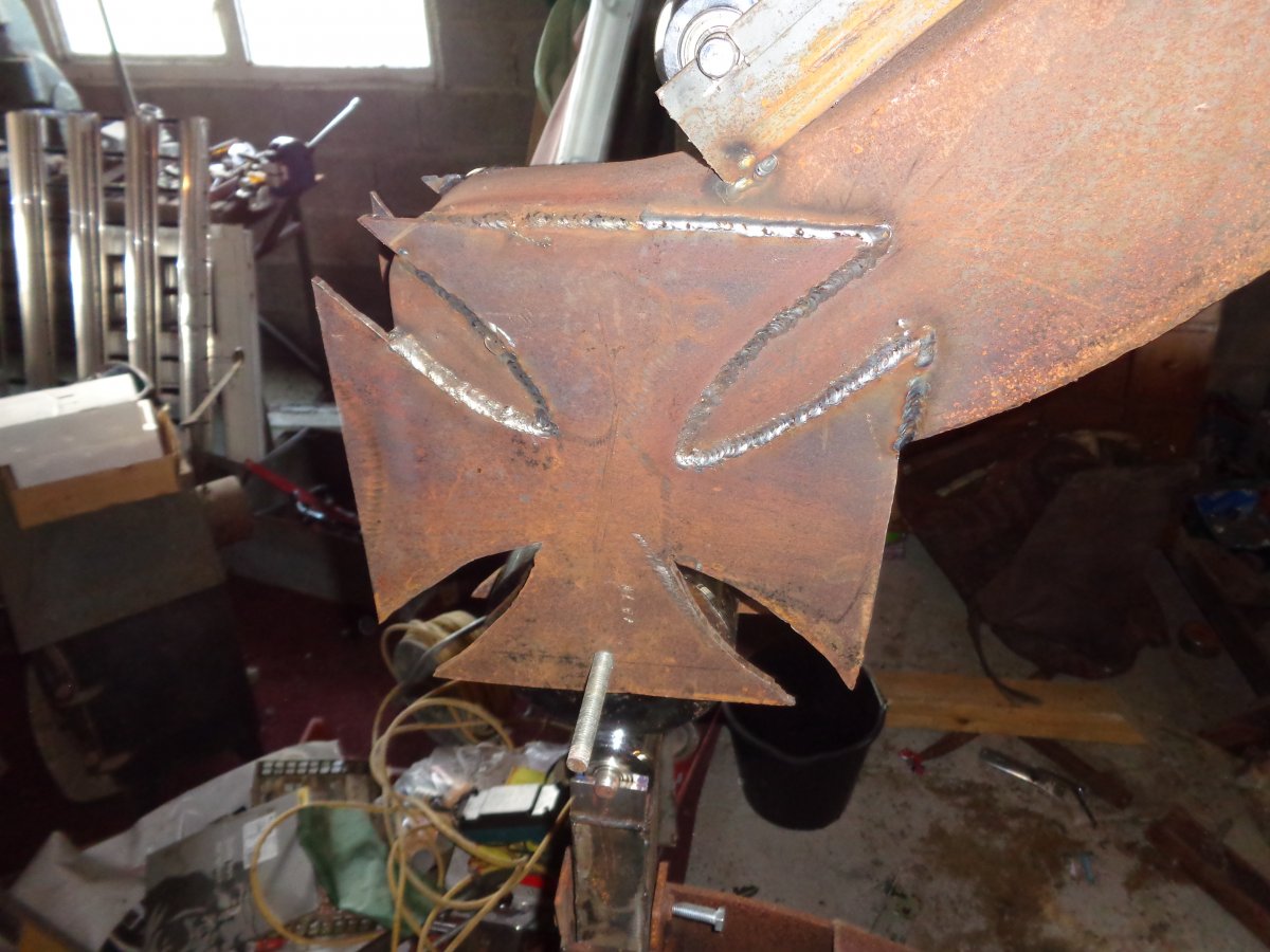

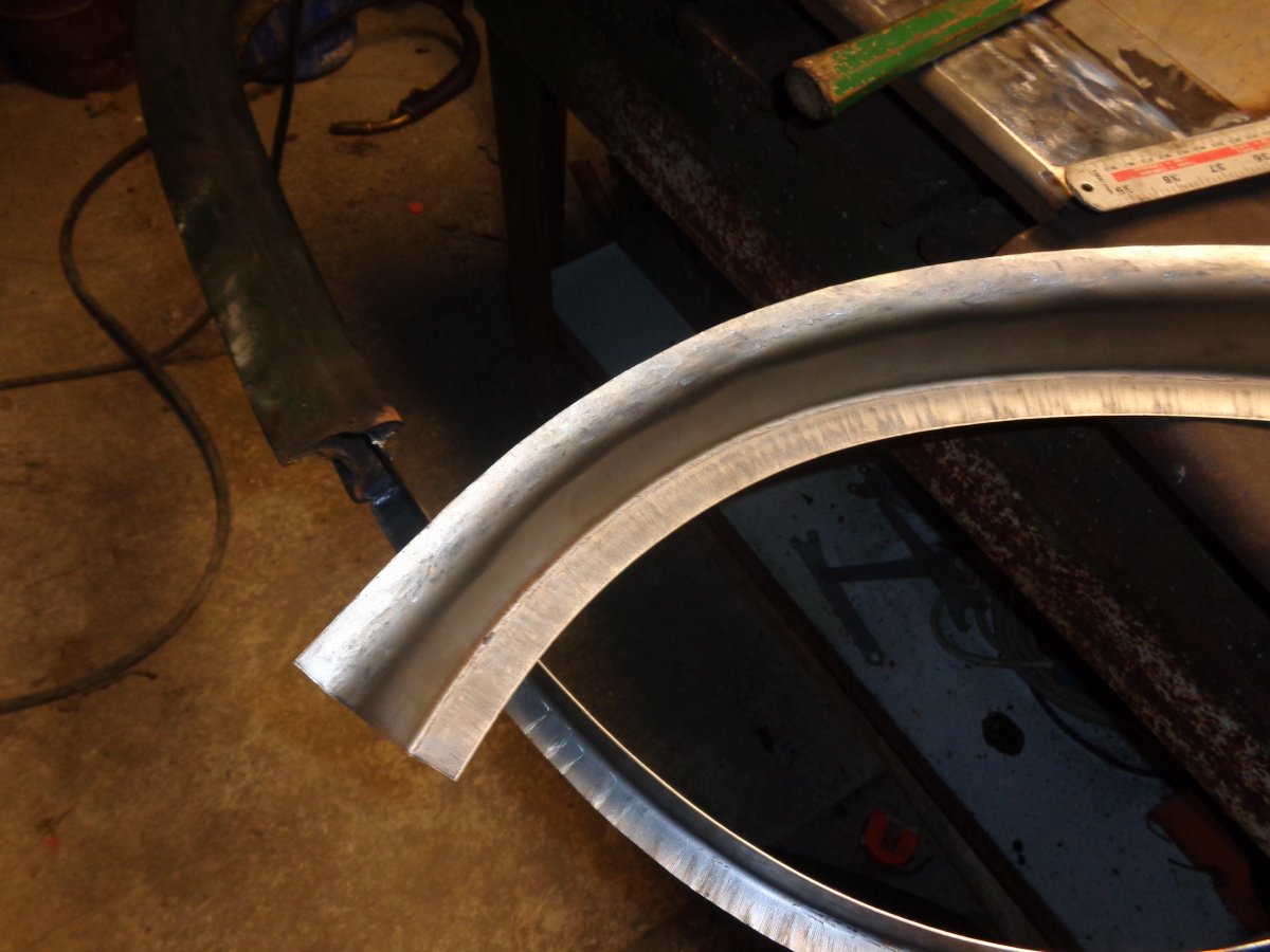

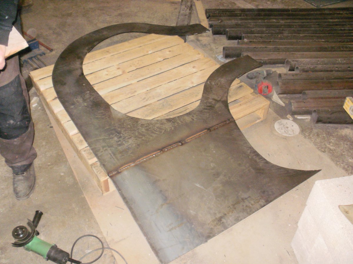

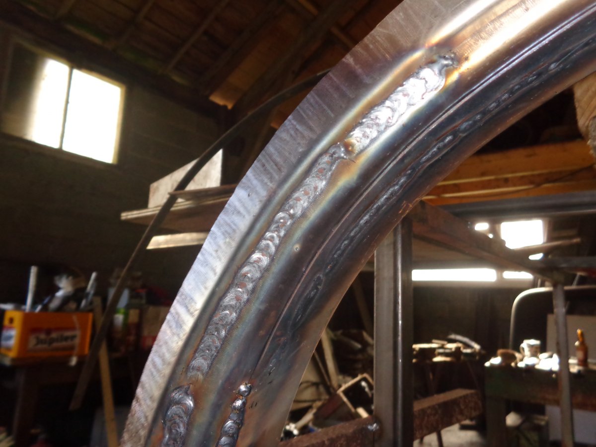

    Starting with a sheet of 8x4 ply. I cut out a large G shape. I then laid that on some 1/4 inch plate and with a plasma cutter,cut 2more G's out of steel. A bit of bending , more cutting and some welding. I now have the main part of an English wheel. I returned from the UK with large threaded bar and tube. Top wheel and lower anvils etc. So will build the slider, saddles etc this week end. Hopefully is will all be straight and work fine. Now to lock myself in the garage for 2weeks and with luck when I re-emerge the silly season will have finished. Joueux Noel to you all.

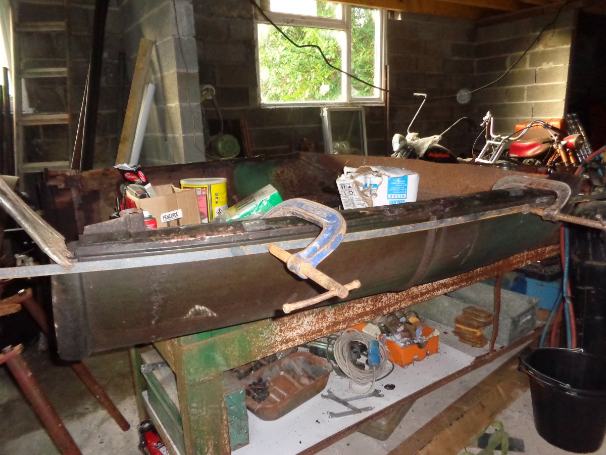

    Well I could have used a piece of 3inch plate,but it wouldn't look as cool. Can't wait to smash my hands into those edges. So that was todays work. Saddle and slider for lower anvil. Will just weld a flex plate to the bottom of the tread for adjustment. Fit a proper bolt to the top wheel and dress those edges and round off the points where my hands are going to hit. You lot might just be waking up but i'm off to the pub.

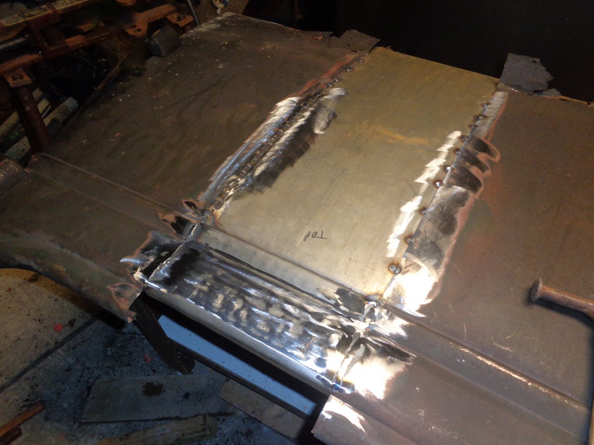

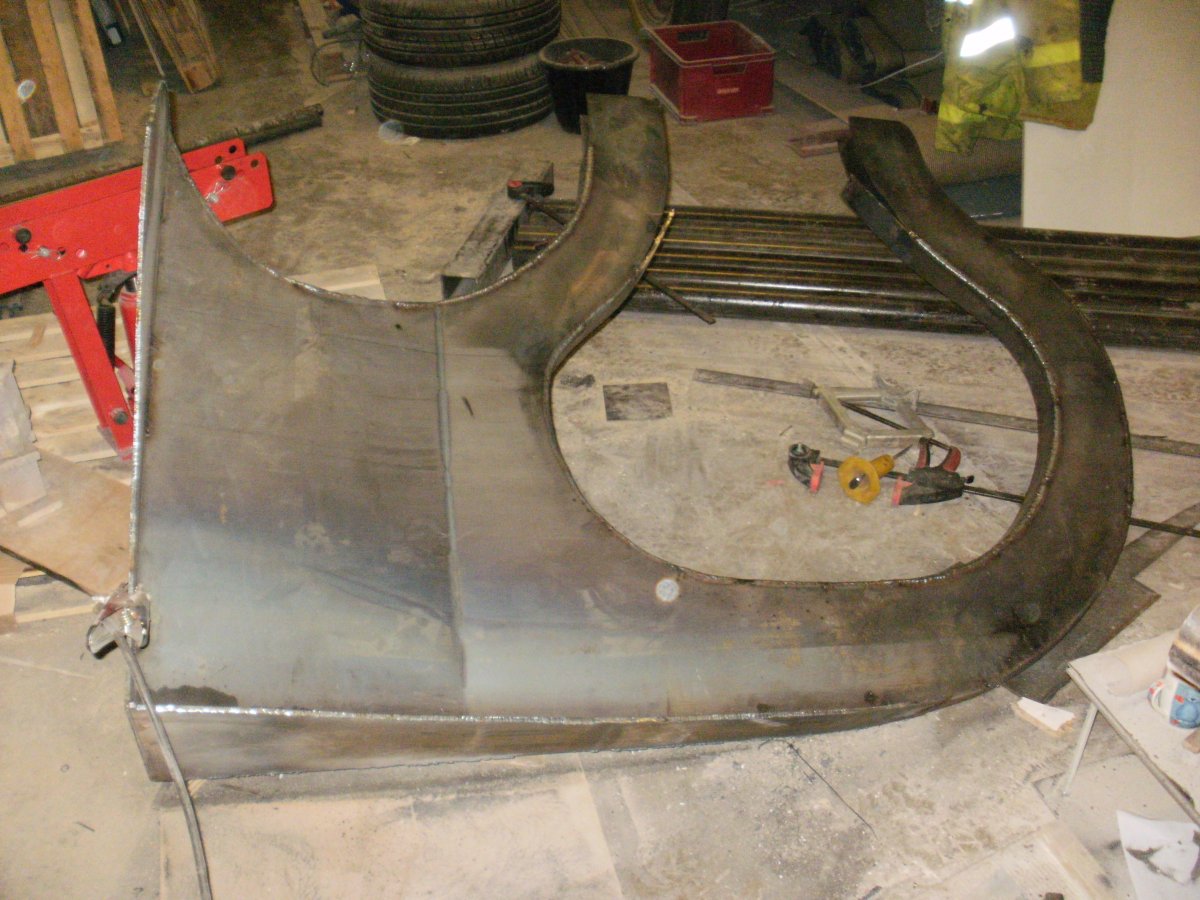

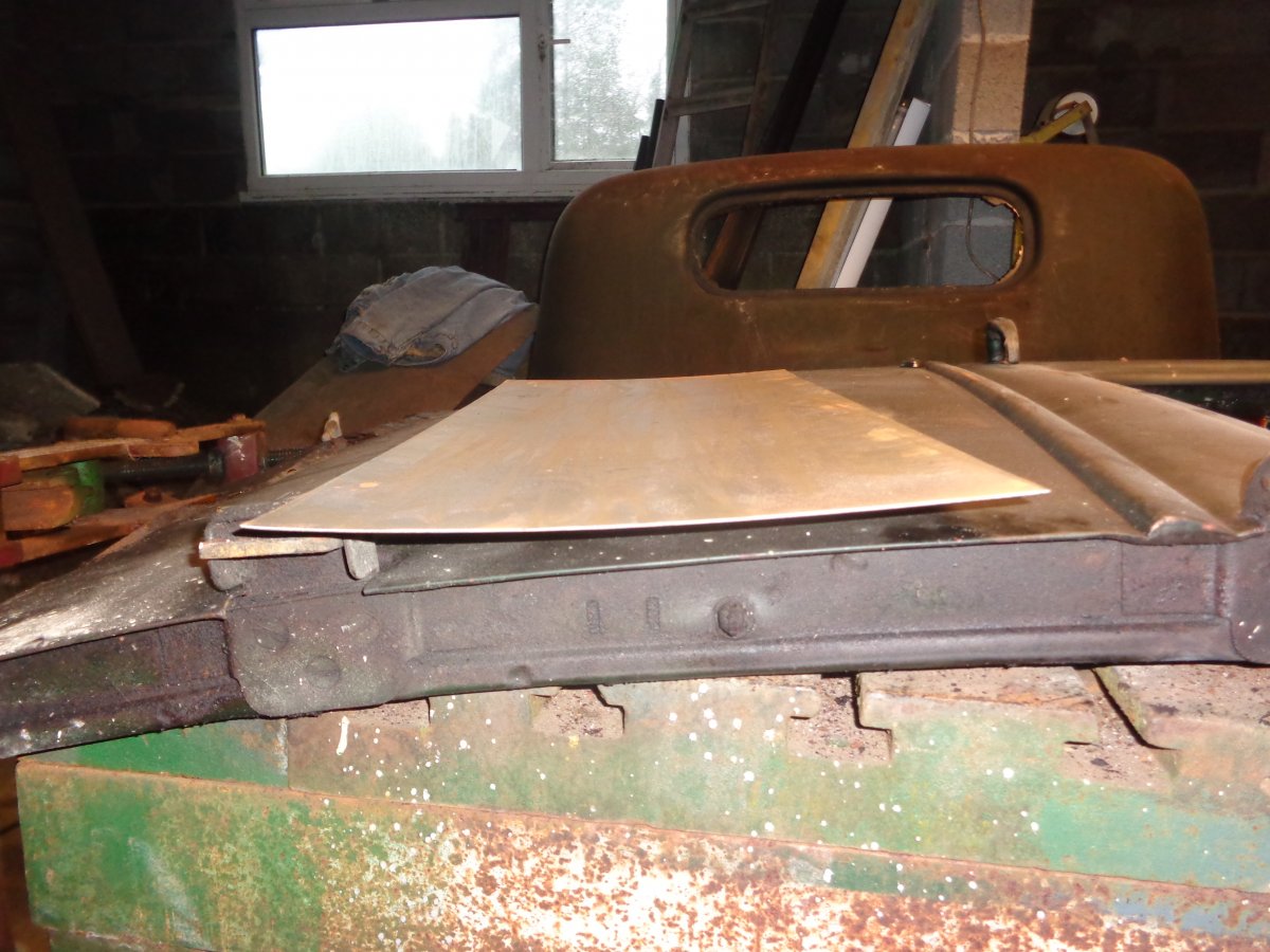

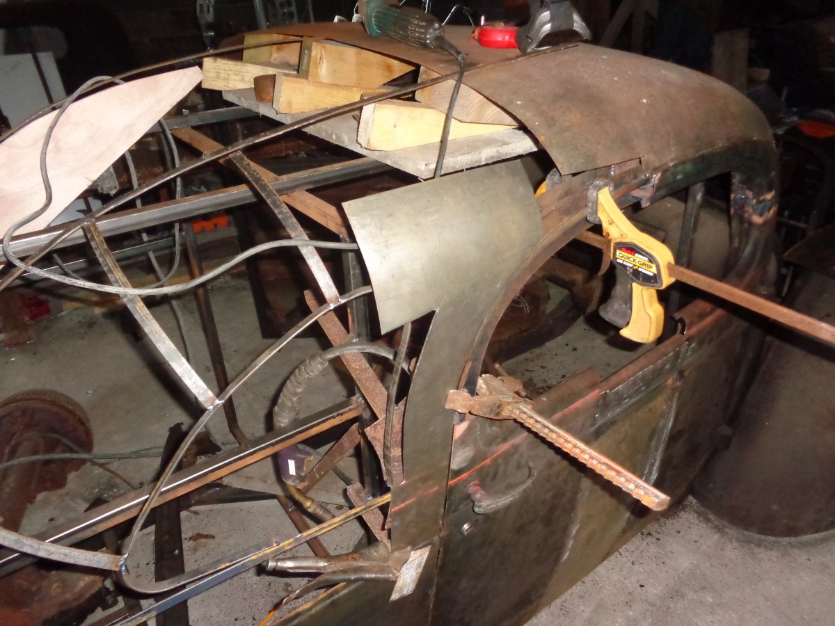

    Well another day of rain so another day in the garage. Cut the old B posts off the cab back. Then had a play on the wheel. Seems to work fine. Plus couldn't find the edge setter. So I used the box and pan folder to set the edges. A bit haughty but I got away with it. Then I rolled a new door centre,cut the door in half and set it in. 11 inches longer. It seems a lot but it was a pickup and they tend to have shorter doors and it measures up to that fine sketch I did. Thinking out loud. Feedback is welcome. Thinking I might just reshape the hole on the front fenders. So they always have a hole in them and the tyres stick through when parked. Just make sure the wheels are straight when its lowered. Think I might suicide the doors as well. Well its beer o'clock again

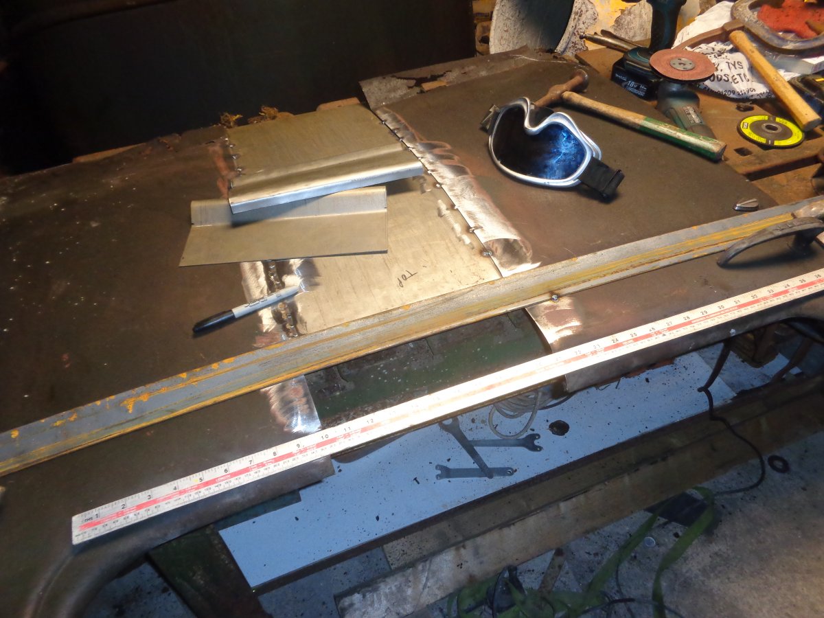

    So another day of rain and still in the garage,May have to sell this and get some wood in to start on an ark. Well 11 inches was too much. So the doors are 7 inches wider now. Rolled the bottom the door and radiused the corners. Chopped the door,went for 3 1/2 inches. Then bodged up a couple of bits of tin to make the curve I want on the back of the doors and welded that in. Chopped the roof and trial fitted that. Pulled the hinge out of the hood whilst I was thinking what to do next. Put the door on and mocked it up. Hope you can see where i'm going with this. Cheers for now

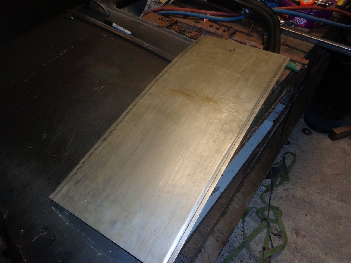

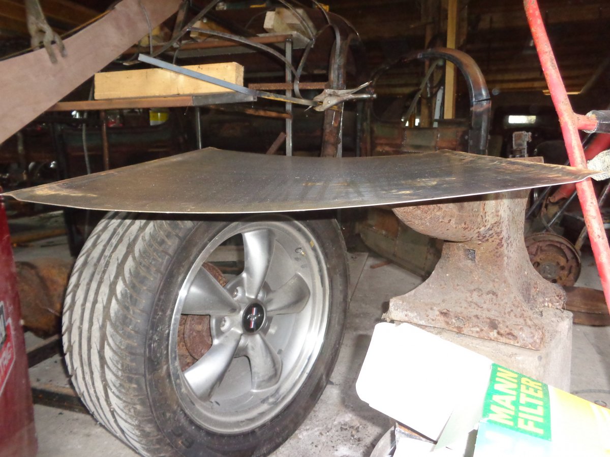

    Now its sort of going in the right direction. Spent 2 days ****ing about learning how to use an English wheel. Managed to turn a few sheets of 18 gauge into a pile of ****. Then I started see what you can do with it. I had read up on the subject and asked mates about it but its not the same as practical experience. So its slowly getting better. So what happened today? Made the top of the door frame,mocked up a few bits of bar for a general shape. Built a central wooden spine. Which is my centre line/data point and profile. Thats what i'm working to. For better or worse. But plans can change! Then just bodged the roof on

    Hey @ugliefrance a little off topic for this thread but I just have to know. What is that front end on the background? Its not from the truck but I would still like to know.

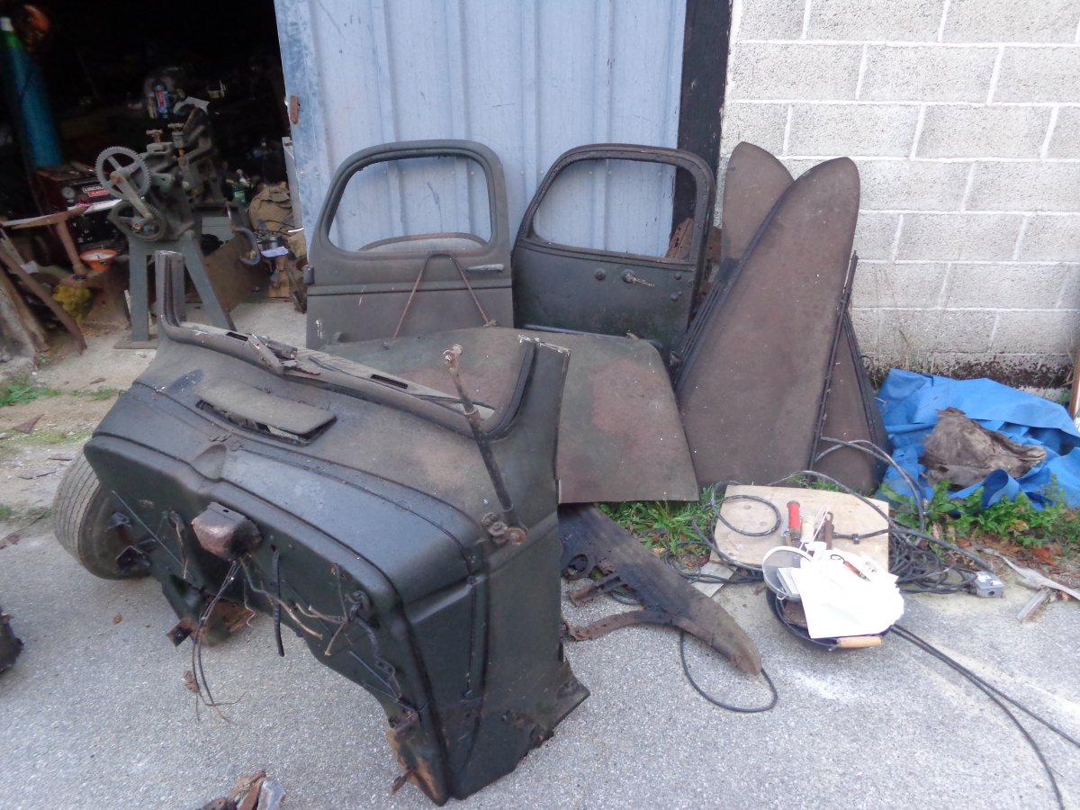

    Those parts look OD Green and painted in "blackout" I wonder if that could have been a wartime truck. It's a very neat build, thanks for sharing.
