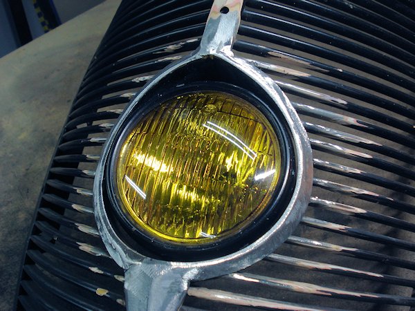

    Well, in post #77, I had the fabricated ring welded into the grille shell and was ready to fit the grille bars. After staring at it for a while, I thought that in addition to the fog lamp being recessed a bit, I needed a wider ring to facilitate welding the grille bars to. I won't go into the cut it out, fab a new ring deal, because it's the same process as before. Just me trying to get the project where I want it. I fabricated a new ring out of 1 1/2 " stock, and like that much better. Also, mounted the lamp ***embly, and have room for adjustment and alignment.
    After getting the ring squared up, I welded it into position.
    Welded a bolt into the lamp housing. The holes I'm not using in the lamp will get welded up.
    I'm liking that much better.
    Setting on the car. I'm ready to position the grille bars. That will be my next adventure when I get a break. Thanks for looking.

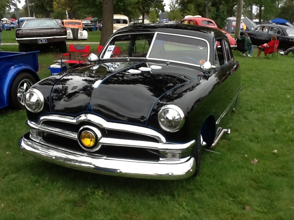

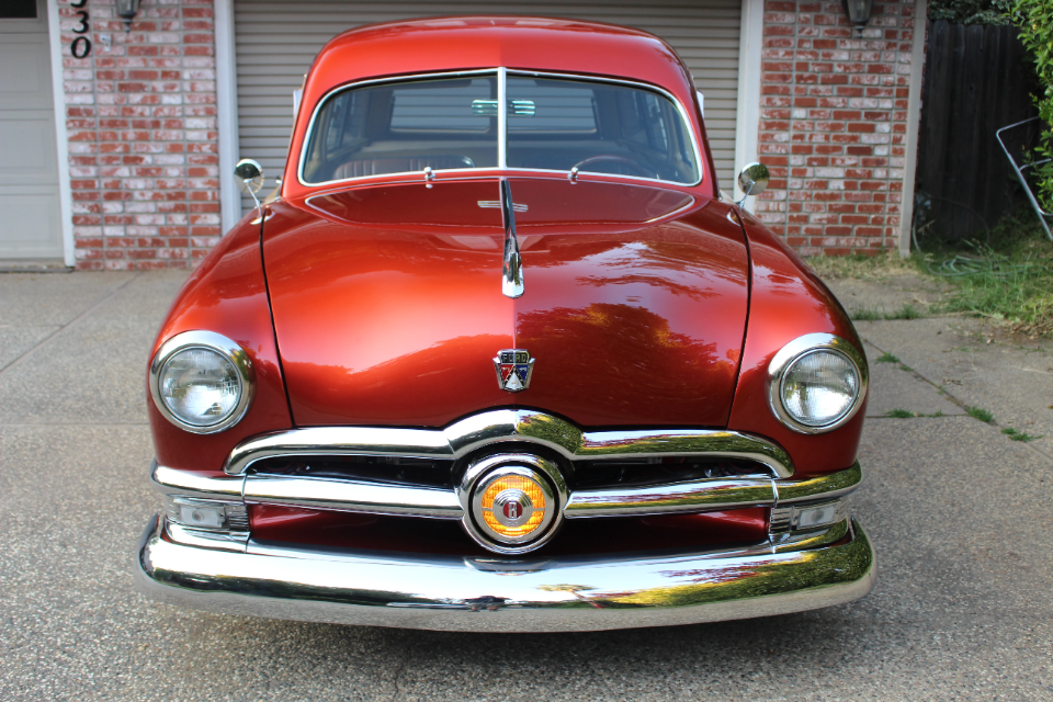

    Quality work Stu. Never would have considered it but I like the look of it......as with these shoe boxes.
    James Dean 4.JPG ebay147460740327678.jpg 1949-Ford-Club-Coupe.jpg 1950-Ford-Crestliner.jpg
    With illuminated medallion.
    wudz-up-restomod-ls-powered-nor-cal-1950-ford-woody-wagon-2018-08-30_22-31-04_948269 - Edited.png

    I'm back. I've had many good suggestions from the HAMB, along with a few naysayers (which is okay, because if everyone liked the same thing, it would be a dull world). Finally had some time this weekend to wrap up the fabrication portion of the grille. This project has evolved from a rather crude hole for the fog lamp, into a refined piece of work. As I moved through the process, I made changes that I felt were important to compliment the initial idea. Had to change direction on the ring size a couple of times, which in my opinion, resulted in too much material protruding from the grille. Again, after staring at the grille and reading some of the ideas, both posted and shared privately, I guess form followed function to the end result that I'm posting here. Sorry it's taken me so long to complete this modification, and thanks for looking.
    Here's where we left off..
    Each of the grille bars needed to be trimmed to fit the ring......
    Wanting the lamp to appear more built in, I trimmed up the ring to be closer to the grille bars. Additionally, I wanted to fabricate a piece which I could weld to the ring, that would trim the area where the grille bars attached.
    I decided to use a strip of 18 gauge metal to fabricate the trim piece. It was cut from a flat piece of 18 gauge steel to fit the outer perimeter of the ring. Thin stock like that can be a challenge to fit properly, so it took several tries of fitting and a combination of shrinking and stretching to enable the piece to fit the ring perimeter and lay on the grille bar in a pleasing way.
    Keep in mind that this is a strip of 18 gauge that is 5/16" wide. Pretty much a pain in the **** to get into position and fit properly.
    After quite a bit of t*******, it wasn't looking too bad. So, a few tack welds to hold it into place, and stand back and look at it.
    That looked pretty good to my eye, so I went ahead and welded it up (slowly, cause remember it's 18 gauge), and ground the weld smooth.
    Well, there it is. Like it or hate it. Of course, I still need to finish it out and refinish in satin black, along with installing the stainless trim. I won't bore you with that process. I've got a new Walker radiator to install before I put the grille back in. As you've seen, I don't always have a lot of time to work on the 37, but I really enjoy it when I do find some time.
    Thanks for looking, and maybe I've inspired someone to take a walk on the wild side once in a while. Stay safe.
