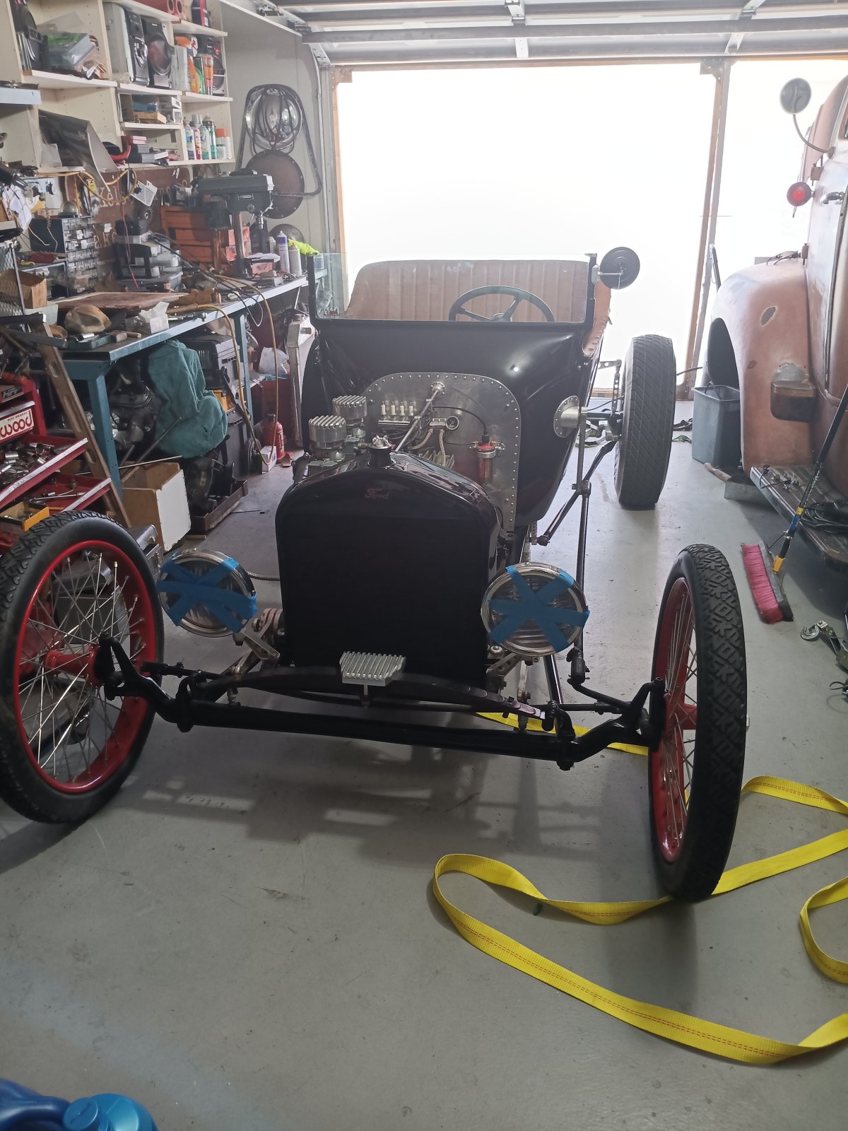

    Model A steering arms in T spindles, you should be fine if the balls are still round.

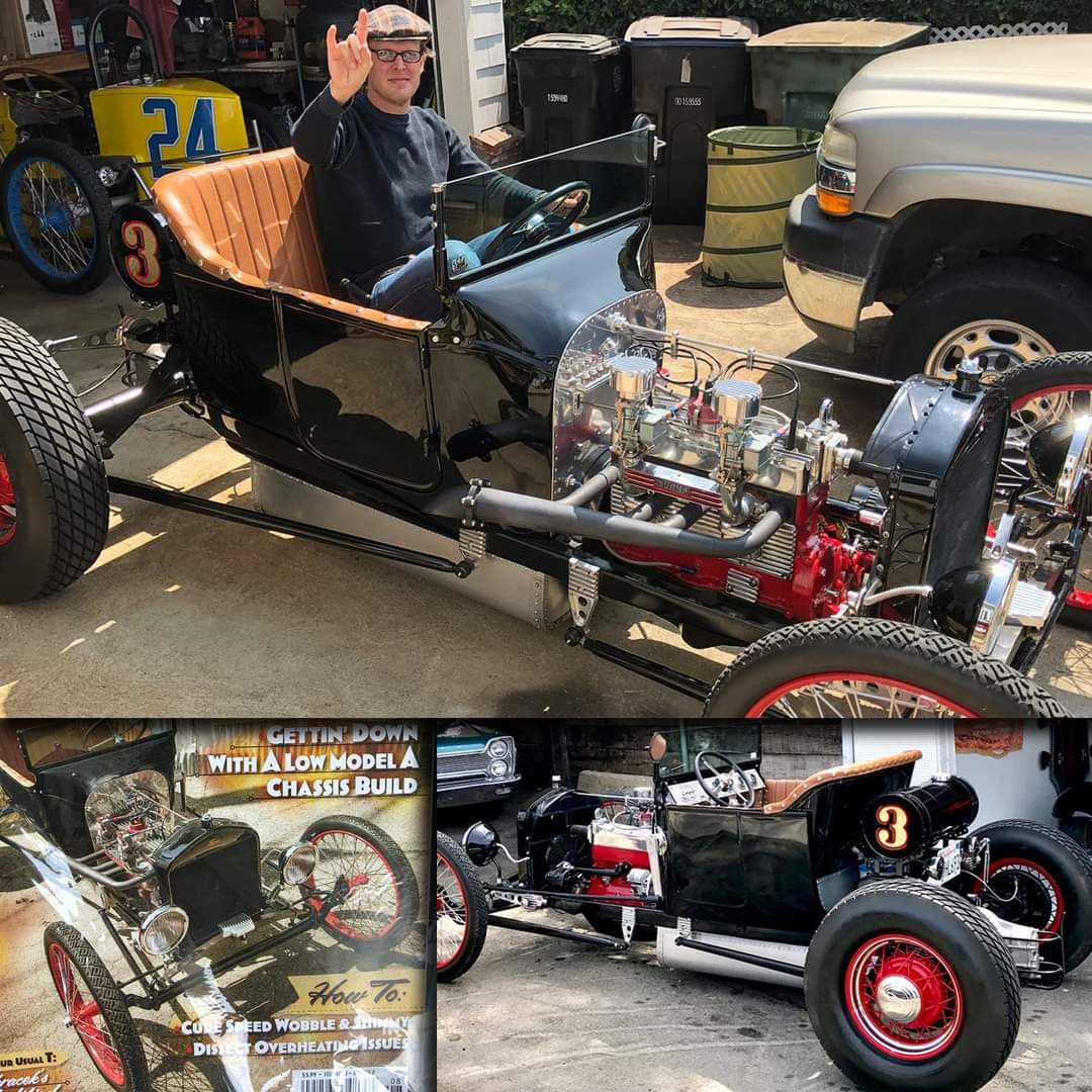

    Man I'm jealous! I've drooled over that issue of rod and custom many times!
    I'd make the rear brakes work as well as they could, and would even swap to discs if you had to, just to leave the front looking like that.
    I've driven my T a little over 11'000 miles on just rear brakes, but they work GOOD.
    keep tweaking little things and get out and drive that thing!

    This car is so cool. I bought the issue of the magazine it was in for the feature on this car alone.

    The seller,gave me two copies of that issue..pretty neat.

    There could be a very good reason that it only has rear brakes.
    It still has a lot of Model T there.
    I was deep into “stock Model T” research, I believe it was Kansas Ts or something like that but they have a series of cl***room, shop instructional videos concerning stock Ts.
    Anyway…….
    Front brakes?
    Not a good idea on stock Model Ts due to steering geometry, ch***is and axle construction.
    While vendors do sell disk brake kits for stock T axles, the presenter did not recommend them.
    The stock T front axle, ch***is and suspension is incredibly flexible and it was never designed for braking the car.
    Those front brake kits may work well on a flat surface in a straight line. With that said there are many risk factors in the real world, curves and uneven surfaces.
    On a stock T front brakes can cause……
    Sudden loss of control (darting either across the lane or off the road)
    Ch***is flex causing binding and one wheel lockup
    Axle breakage
    Wheel collapse ( wood or wire spokes)
    Steering link breakage see No 1.
    One wheel lockup, loss of control…
    Loss of control and rollover…
    I know this car does not have stock T steering but it still has the wire wheels ch***is and suspension.
    If it was mine I would make sure the rear brake were the best they could be and drive accordingly.
