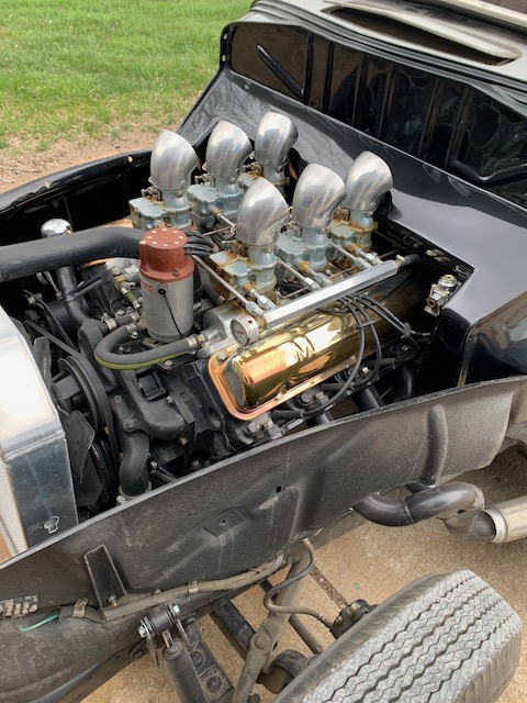

    Anybody happen to have a few pics of the work in progress '40 coupe with no front clip? I saw it in the video. I was noticing its exhaust routing under the running boards and thinking of going the same route.

  15. UNCLECHET
    Joined: Dec 3, 2002
    Posts: 1,255
    UNCLECHET

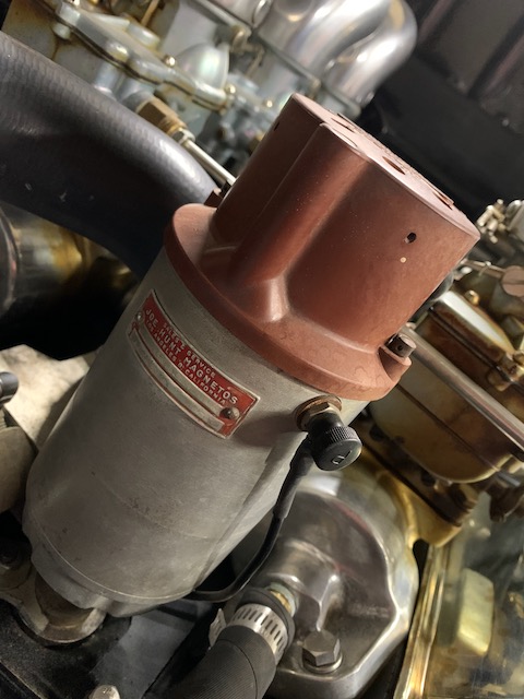

    I don't have many photo's but here's some. The engine is a 430 MEL bored out some and came out of an alcohol drag boat. It's a monster! Ford top loader 4 speed, 9" rear. It's gonna be super nice!

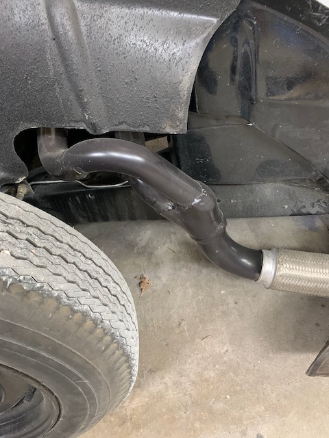

    Complete exhaust built by Donnie Blecka. Headers route to flex joint then into ovalized tubing under the running boards. The exhaust exits thru custom ports in the running board. No mufflers!

  19. Crusty Chevy
    Joined: Aug 28, 2007
    Posts: 1,320
    Crusty Chevy
    Thanks for the pics, that thing does indeed look mighty wicked. I was thinking of running the exhaust outside like that would help to keep the heat out of the cabin. Personally I cannot live without mufflers, but I can probably see a way to squeeze in some cherry bombs or low profile versions.
