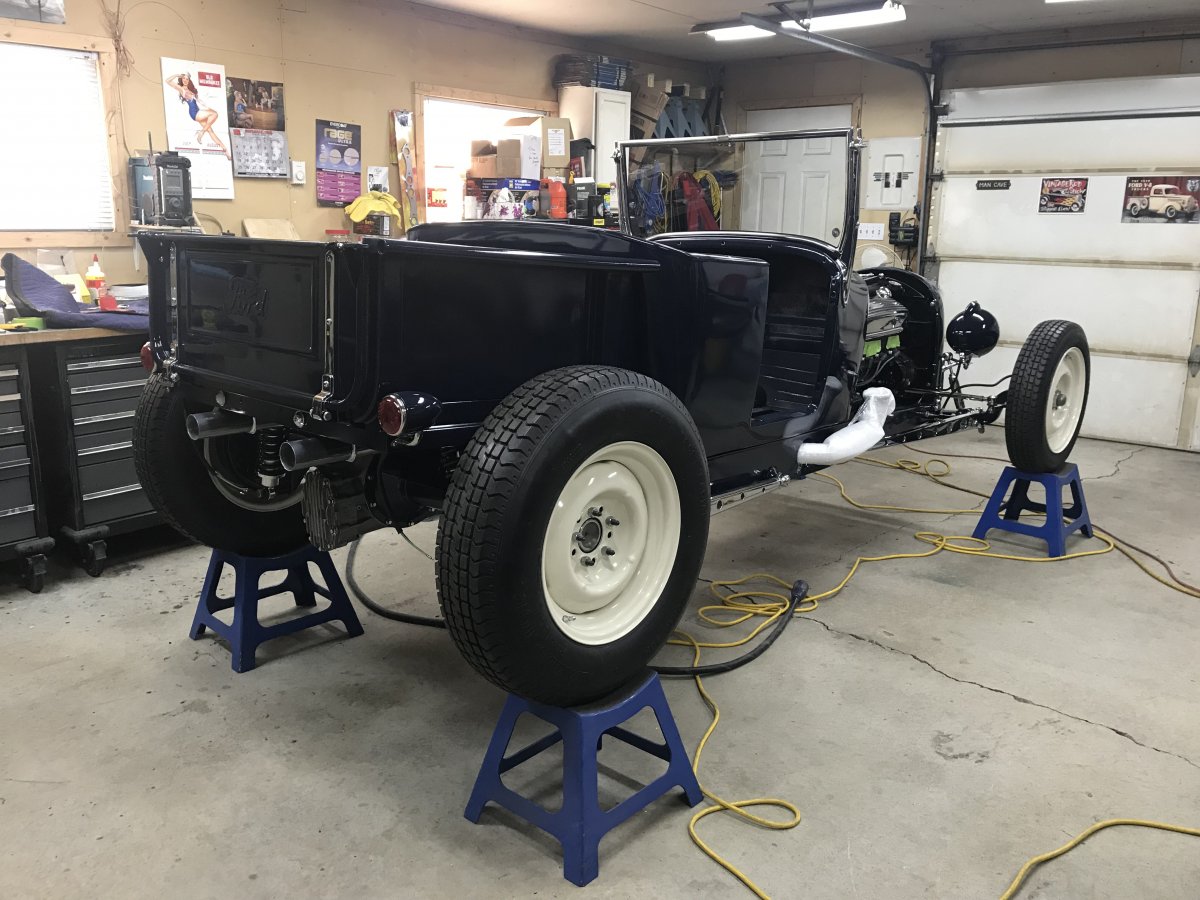

    If you don't need to remove the wheels then I like this kind of setup or something homemade out of lumber.
    These stands were posted on here by one of our Canadian members, Blue One.

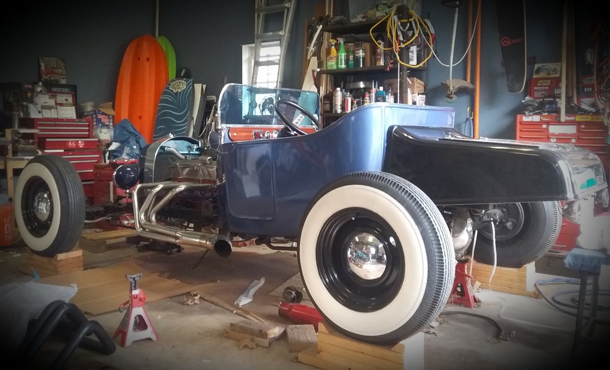

    I use wood blocks when I don't have to pull the wheels off, a combination of jack stands and wood blocks for safety, when I do... 20200324_192045.jpg
    charleyw, jimmy six and williebill like this.

    Mine are similar to Rustydusty's stands, except with heavy duty rollers. Pretty sure that nothing bad can happen with them, and I have fallen asleep under my cars when they're on the wooden stands.

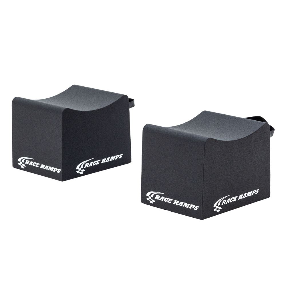

    This is what I use when I need to work under my p/u. If I need to remove a wheel to adjust brakes or whatever I only remove one wheel at a time and use a 6 ton jack stand in place of the wheel stand.
    https://www.raceramps.com/ RR-WC-10.jpg

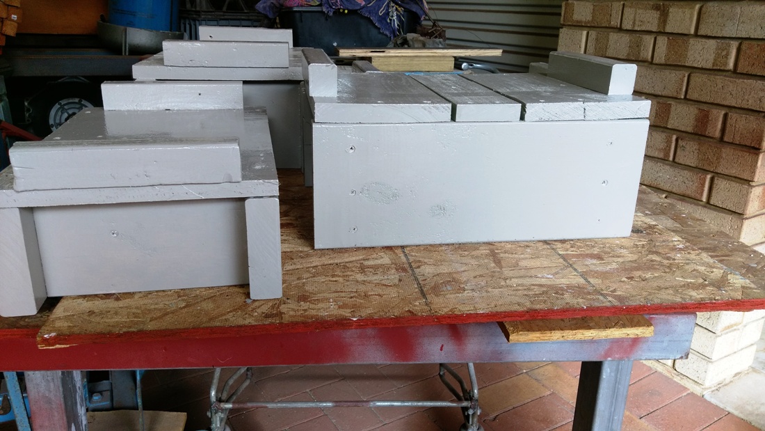

    I made these out of s**** lumber.
    Copied from YouTube.
    They are stackable and I made them in 2 heights to cope with big and little wheels.
