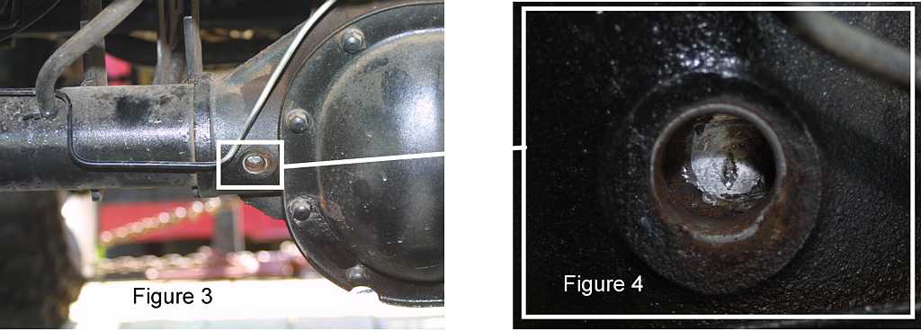

  19. The first mod to a 8.8 is to weld the tubes solid to the chunk is it not?
    Vs
    Depending on the plug welds or pins to let it do that^^^
    Here's what it looks like when the pins shear

    This internet version of the sky is falling stuff started when it was found in owners and factory service manuals - Do not lift by center point load on differential.
    I guess the point I was making is that although the 8.8 is a very durable unit even in stock form, you'd better know to weld the tubes before pushing it. Sticky tires and a hard launchs from a stout power plant, or pulling too way too much weight will eventually cause issues with the pins too.
