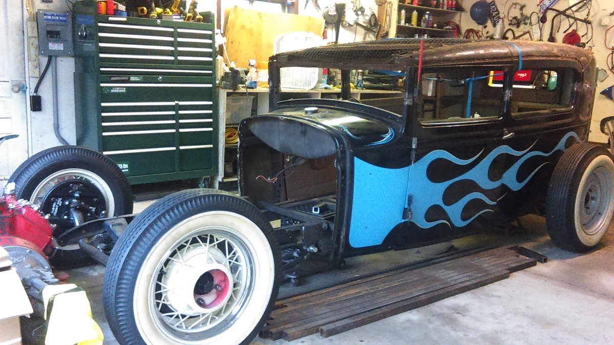

  28. Jade
    Joined: Sep 19, 2010
    Posts: 120
    Jade
    And here it is channeled! Still a lot of work to do, but this is how it's going to sit. The body is just even with the bottom of the rails. 6" off the pavement at the moment. Once the engine goes back in... it drops a little more.
    Aaron D. likes this.
  29. Shadow Creek
    Joined: May 14, 2014
    Posts: 309
    Shadow Creek
    My personal opinion - car sits great!
  30. Just Gary
    Joined: Oct 9, 2002
    Posts: 6,047
    Just Gary
    You do great fab work!
    The car looks good so far, but you'll need to both lower & section the grille shell to keep it below the cowl & beltline. Otherwise the car will look really awkward.
