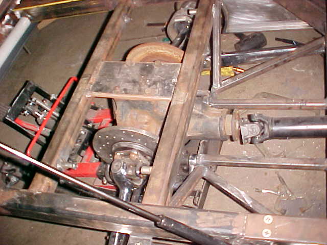

    go with the jag front and rear. the front clip will give you big brakes with 4 piston calipers rack steering and is ment for a 4000 lbs car mustang 2 stuff is too light for some thing you plan to use as a truck.
    jag rear you can set it up with the center section against the bed floor and have plenty of suspension travel with out having lost alot of bed space.
    bed is only channeled 3 inches over the frame
    frame is 31 inches between rails but the crossmembers could be any with you need. i also used xke lower control arms and axles

    did not use the jag front on this car but when i have used them in the past i get new springs from johns cars who specialize in sbc jag conversion and make lighter springs. and aluminum head sbc with headers is 1000 lbs lighter then the jag v12. front hubs i put in a brake lathe and turn them down to fit a standard chevy wheel
