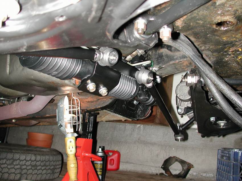

    Not done yet but I have plans to narrow one 4" to fit under my ...ehem...`54 Jag Sedan. I'm looking to solve the rack issue by using a Cavalier rack with fabbed centerlink extension.
    Along these lines:
