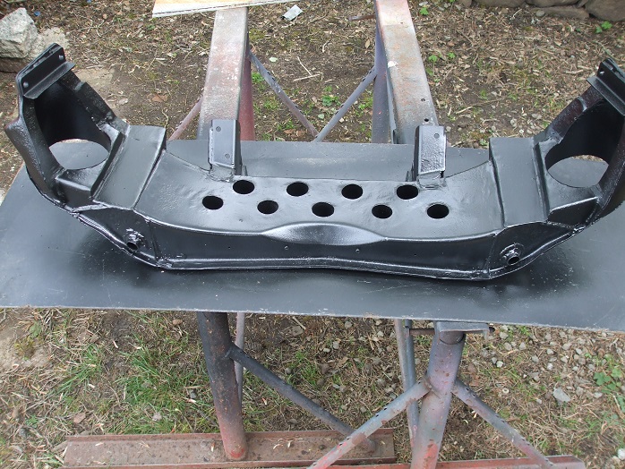

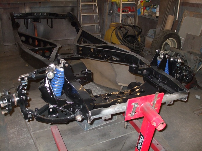

  1. XJ6 is def. the easiest one. Here's one I converted slightly for my avatar truck. I removed the large coil spring and subs***uted coil overs. I think it looks much neater (Less cluttered).

    Nice truck, great work, BUT is this really a traditional hot rod project? I have a hot rod with a MII front end, but you're not going to see it here. Just asking.
  3. I fully agree with you there. I only posted this in answer to the question. I haven't done a build thread for this reason.
