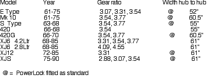

    Here you go:

  6. Thanks for the chart Keep I don't want a bulky lookin rear end as the Stude is a small car I'll have some measurements to check what will work (Jag or Vette ) Steve

    Mine is on a model A and is 61" end to end. That above diagram should help a ton.
