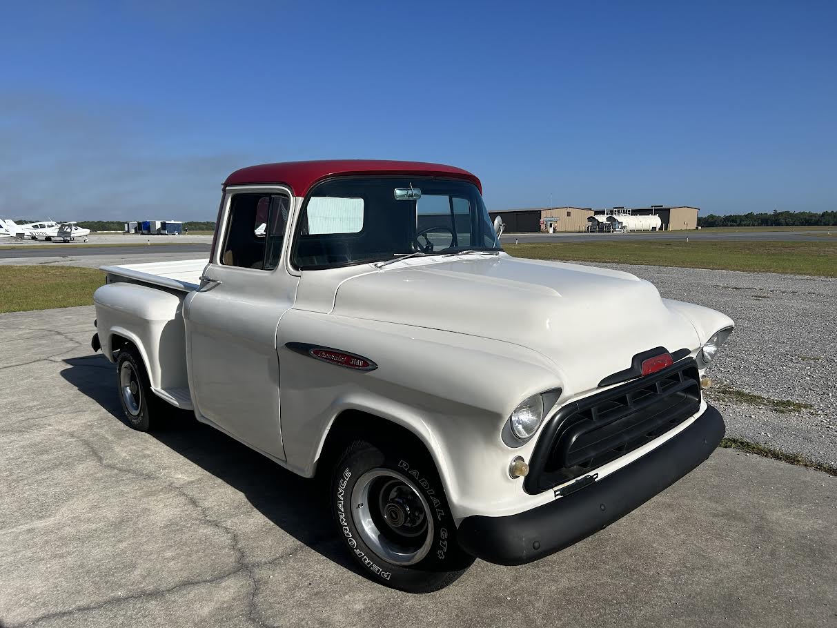

    New to the board. Just bought a 1957 Chevy pu. Has a hotrodded stovebolt 235 and stock everything else. Ive been reading old p osts on the jag ife and irs transplanted into hot rods. My question is if the xj8 is a good donor for this into my truck. There seems to be alot more xj8s than xj6's avalable in my part of central Florida. 99.jpg

    I agree that it's not in the best interest for a swap. If you are set on turning the truck into a more sporty rod style, I'd tend toward a later model Corvette. Keep it in the family, easier parts and setup along with aftermarket support, provided the track width is decent.
    You also mention just buying the truck. I'd say to go slow, get used to it and what you like or dislike about it before diving into a major change. If it is not what you wanted, it may be better to sell it off and buy what you do want. The time and money spent is rarely returned. Once the rear is swapped, I'd guess you'd want the front dropped and changed too. Then engine/trans, followed by paint, chrome, wiring and interior. At that point, you would have been better off buying one that has all that already.

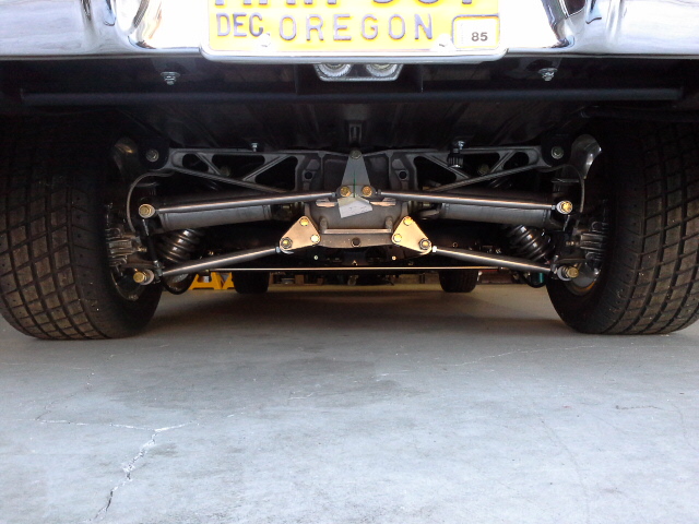

    JAGUAR XJS FACELIFT 3.54 LSD OUTBOARD BRAKE REAR AXLE XJC LATE IRS AXLE DIFF.jpg One other note on the IRS. In 1993 the XJS rear brakes were moved outboard. That makes them easier to service but adds a couple of lbs of unsprung weight.
