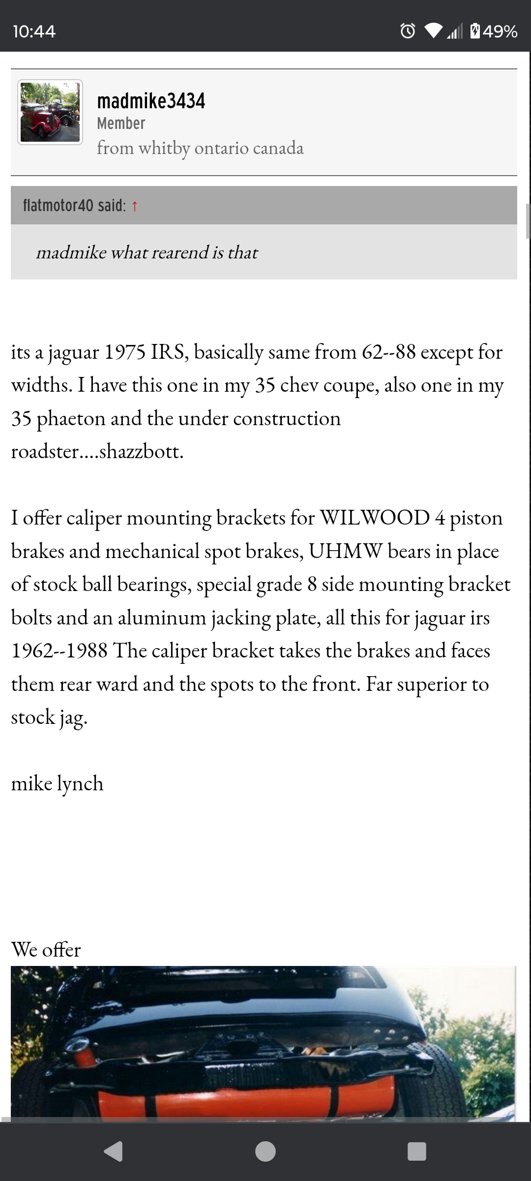

    Hello! I found a bracket years ago that is for a Jag 1980s Salisb/Dana44 that would flip the calipers rearward and have a parking brake to the front. If I remember correctly, it was sized for a wilwood caliper. I cannot find any saved information about the bracket as far as mounting instructions. It appears to require a minor bit of machining tho. I'll post a picture of it shortly.

    I just did a search for @madmike3434 and found that bracket on a Jaguar center section. Here’s a few photos from his installation, no mention of machine work to install the brackets that he had CNC machined, they were not from Wilwood.
    Wilwood is mighty proud of that manual parking caliper, $185 ea. from Speedway or Summit, less pads. The caliper floats on the brackets, you split it to install on the bracket.

    That looks like a very neat setup. I'd guess the machining might require adjustments to the face where they bolt up so they remain in the same plane.Perhaps shimming washers. That's common on Wilwood and Jag.

    Mike was serious about his builds, he had grade 9 bolts made to hold the calipers. Grade 9 is 180,000 psi tensile strength material, and I think the low crown socket heads were necessary to clear the third member. A socket and ratchet wouldn’t fit but an Allen wrench would. The bolts were drilled for safety wire.
