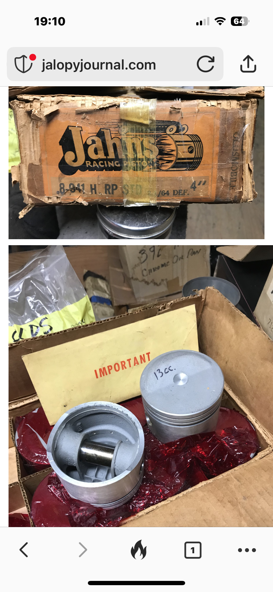

    Question for the older engine builders. I have a set of Jahns pistons for a 324 with a 4.00 bore. My engine machinist contacted me because the pistons are .008 under 4.00 and would be real loose. Should I have him tighten the bore just a bit to fit the cast pistons and file fit the rings? Or run the 4.00 bore and be a little loose. Here is what the paperwork included with the pistons says.
