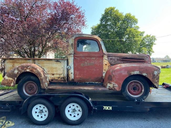

    13903.jpeg Thanks for the info. I was looking for a project when this truck presented itself. I have been riding and building old Shovelheads for years and needed to do something different. As you can see , it has no bed, rear fenders, and the floorboards are fabbed. I found a 46 that had the parts I needed and brought that home as well, all in now....

    Nice looking truck! That is the stance I'm going for.

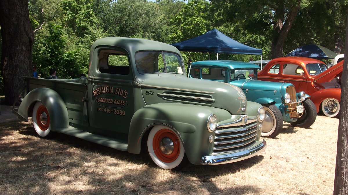

    They dont make a dropped axle for these trucks, you would have to send yours to Sids
    I reverse eyed the top spring and removed a few others. you will need to keep the second one if you do this.
    You can also move the springs under the axle but be sure to fab and weld a flat section to the bottom of the axle or the spring package will twist trying to roll. not safe!
    you can get enough drop doing this and a comfier ride

    https://droppedaxles.com/f1-axle-install
    This tech article is about a Ford F-1, but is very similar to your 42. And Sid does drop axles for your truck.

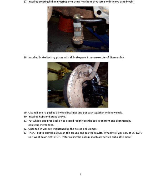

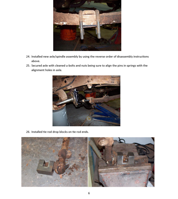

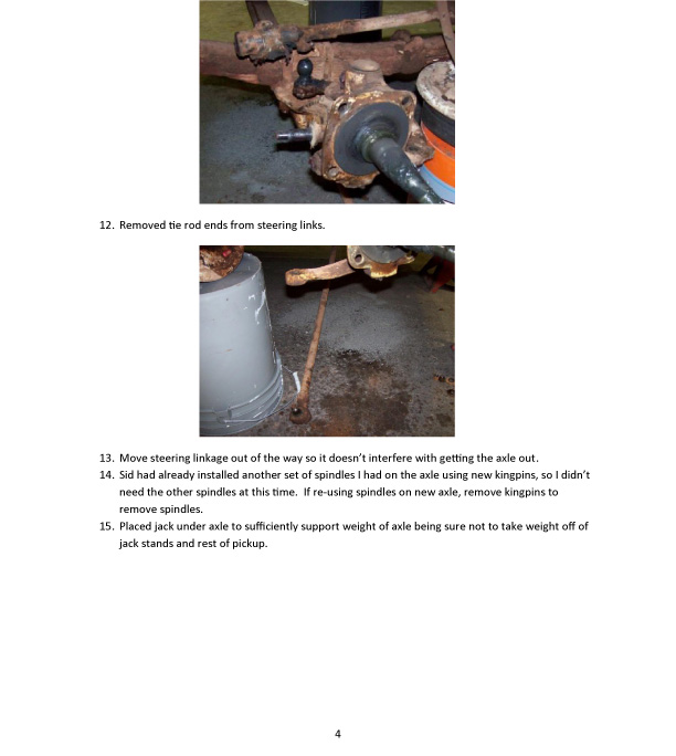

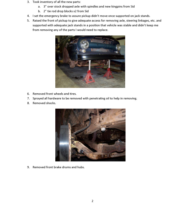

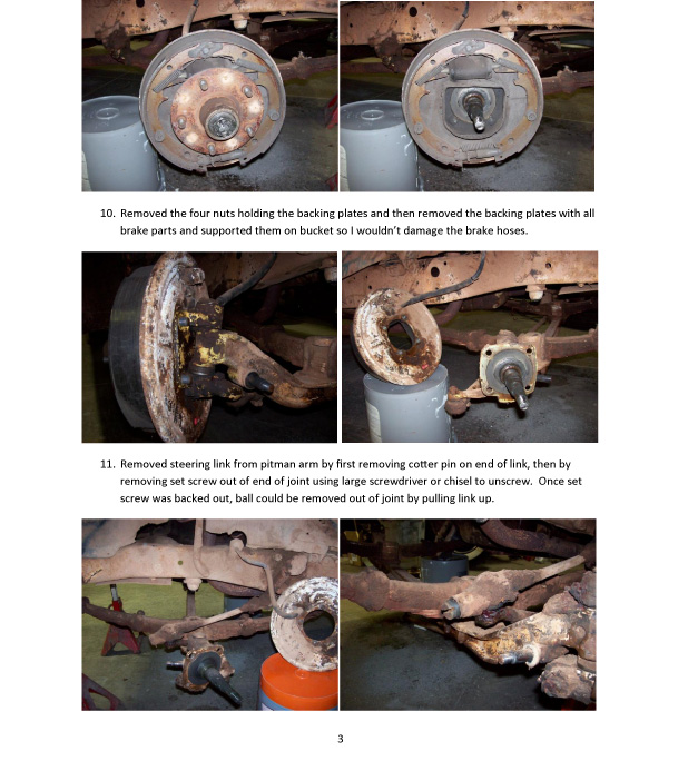

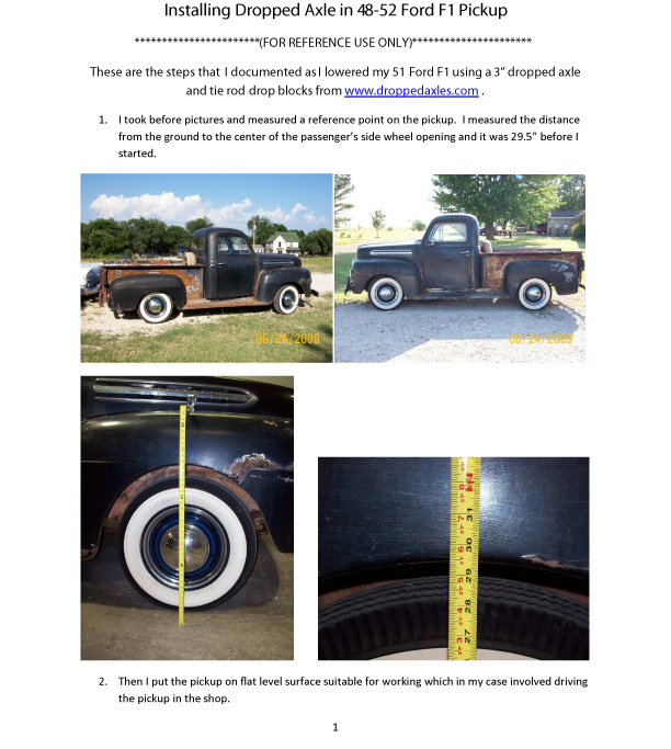

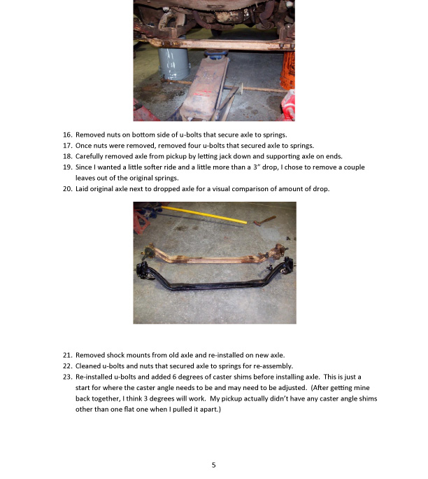

    Decided to just save the file as .jpg images and post them here since they aren't on the website correct right now and they might be of use to someone else too.
    F1 Axle Installation Instructions1.jpg F1 Axle Installation Instructions2.jpg F1 Axle Installation Instructions3.jpg F1 Axle Installation Instructions4.jpg F1 Axle Installation Instructions5.jpg F1 Axle Installation Instructions6.jpg F1 Axle Installation Instructions7.jpg F1 Axle Installation Instructions8.jpg
    charleyw, Tman, Hnstray and 4 others like this.

    Wow that was a fantastic write up.. Thank you..

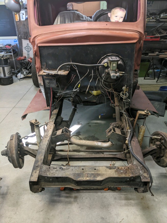

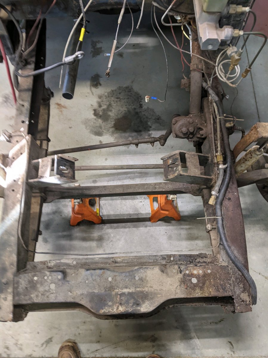

    I removed the motor and transmission yesterday. Getting a better look at the suspension. After much thought and after member input, I have decided to go with a drop axle and rebuild the stock suspension. The previous owner had done some "interesting," mods with the shocks and motor mounts. I will be addressing these issues. I have been trying to upload pics but I keep getting error notifications from the site and have been unable.

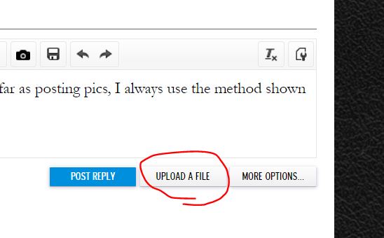

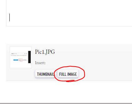

    Glad to hear your direction. I’m sure you will be happy with it. As far as posting pics, I always use the method shown here where I click on the "Upload a file" ****on, browse to the pic I want on my phone or computer, then click the "Full Image" ****on so it shows up full size in the post.

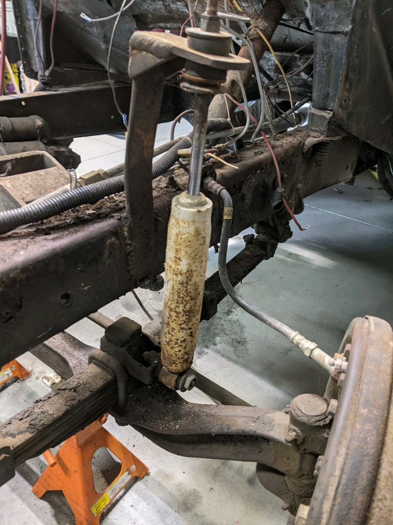

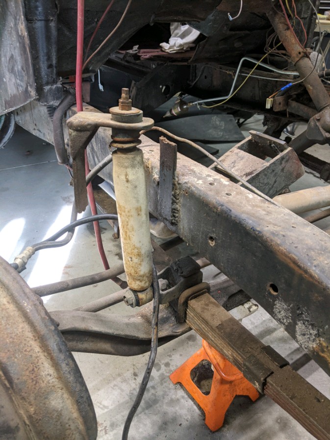

    Ok, I had to send the pictures to myself, then pull them off the media ony phone. Must have something to do with the size. So here you can see the state of the shocks and mounts. Any suggestions on what to do with the leaf springs and a different shock setup?
