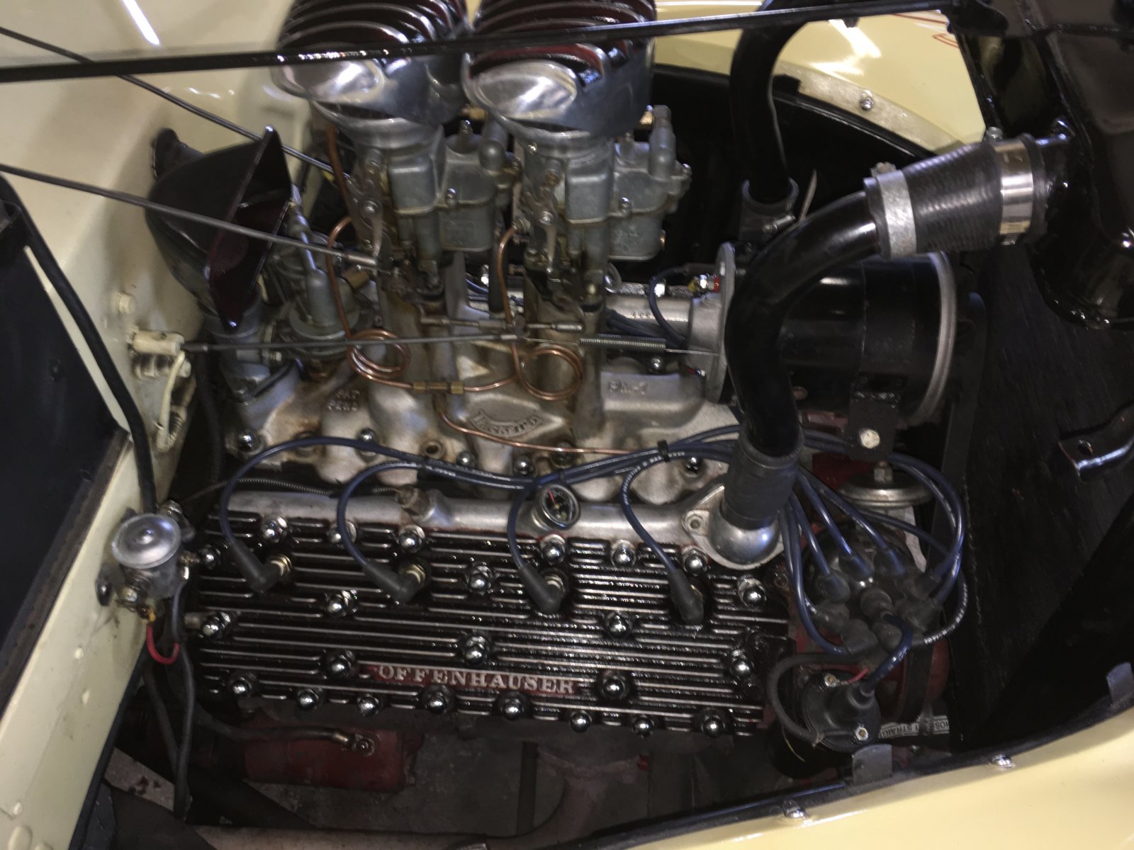

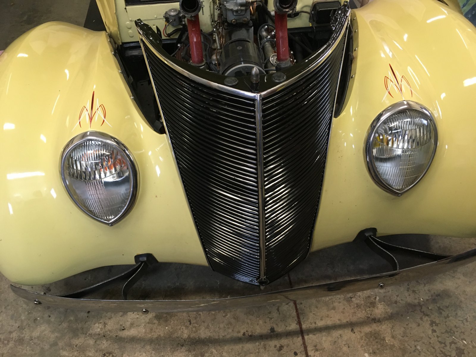

    I’m running one belt which drives both the pumps and the generator on the 8ba in my 37.
    I’m not using a mechanical fan.
    Not a lot of room to work with the original distributor in place. 987CCBE7-04B7-45D8-A229-F3F2F3D85569.jpeg C91AE5F6-BCA5-411E-93CE-45BB0C1B99D9.jpeg
