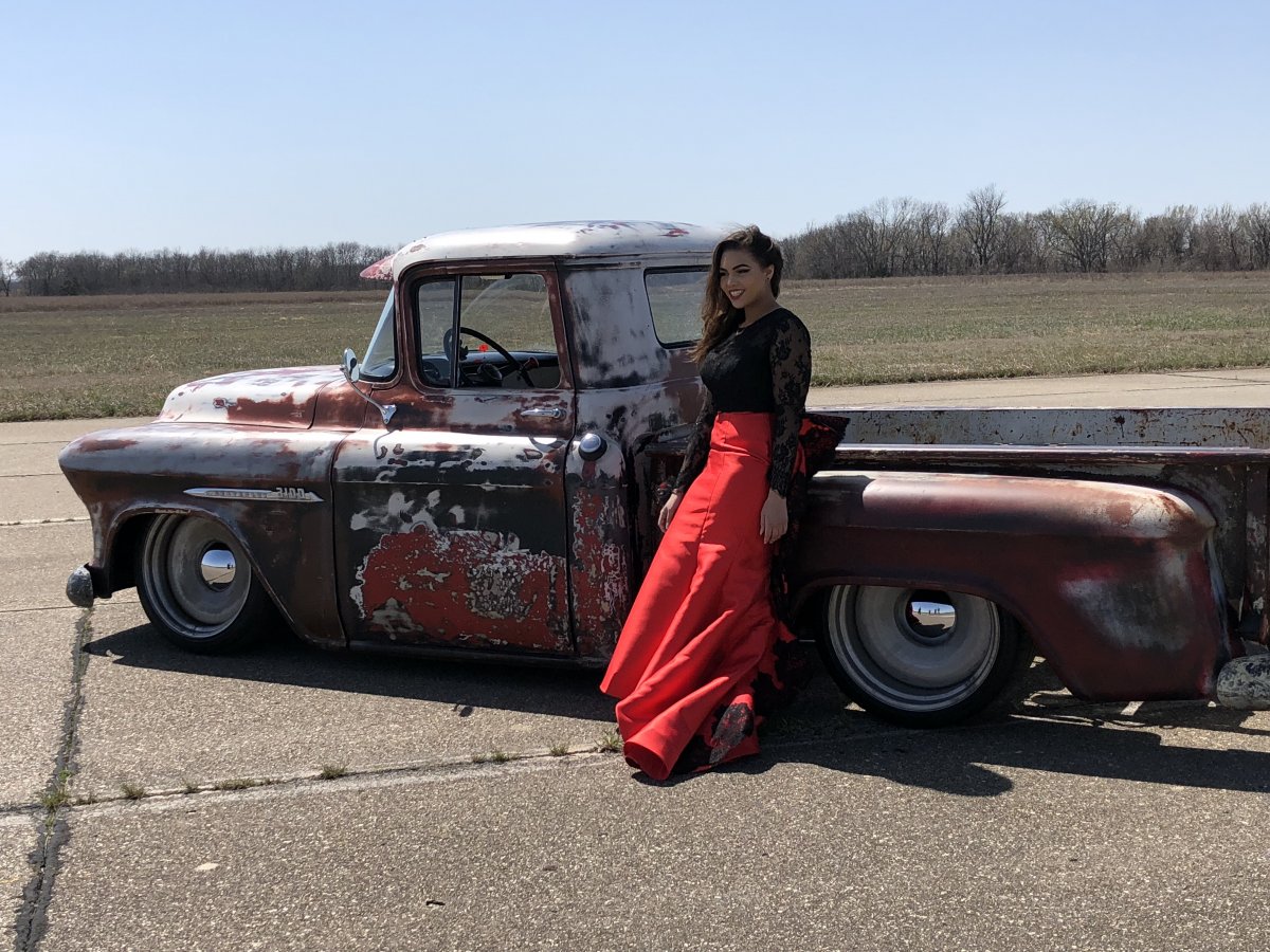

    The old 55’ B076DE34-597E-4567-BAFC-030BD705429A.jpeg well, it has them now, but I don’t know if they were added sometime in the last 63 years. I know it does have a dome light that is stock.
