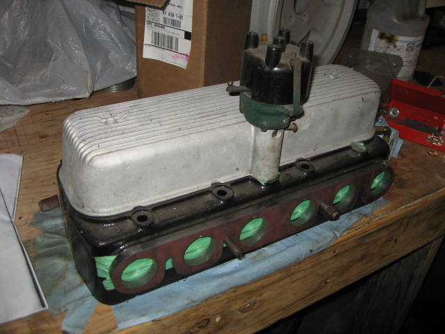

    Hey guys thanks for all the ardun pics and info....I am kinda surprised that they are set up nothing like the flathead V8 ardun heads......Here is the head I will hopefully be running soon. Its rebuilt and ready to go. I'm not exactly sure what head it is but I have been told (by the guy that rebuilt it) is was an Ambler or Alexander. Its just like a Cragar and uses the same rockers but it doesn't have the cut-out in the valve cover for the distributor stand. Does anyone know anything more about this head?? Thanks

    As far as I know that's because they are not Arduns at all and not based any old design. They are machined billet pieces made by Norm Frick and just used the repop Ardun valve cover. Anyway I like it because of the size of the head it fills the engine bay well and evenly as it is cross flow type. My only wish it has been engineered and made better from the start.

    It does not look like it is crossflow like repop ardun, was happy to sell mine before I used it to a guy back east. HnH quit selling them also at that time

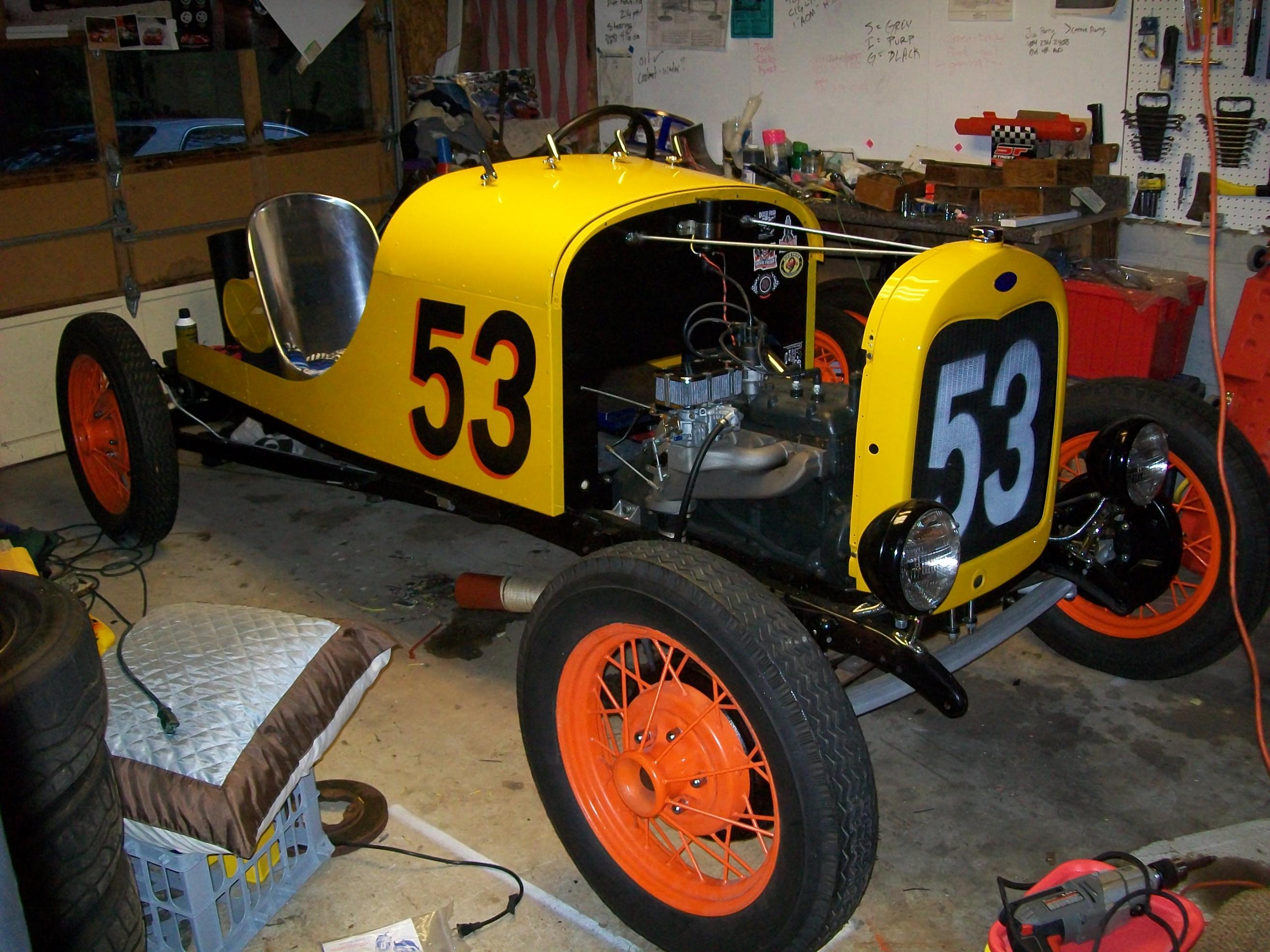

    Don't mean to interrupt- But I was wondering if anyone knew of a banger expert in the metro Atlanta area- I have been working on my banger for about 6 months and i cant get it right. I just don't have the time I used to and have trouble finding a time to get it running with a 1 year old.
    Just for fun I thought I'd show everyone how close I am to being "finished" One with hood on and one with hood off. I have to get the leather straps to hold the hood on still though.

    It is really just running like shat. I did a rebuild in the carb but sometimes it still sounds as though the car is drowning. When the choke is out (which is the only time it will run) is is shooting flames and lots of smoke. It really sounds like a timing issue when it running. I have watched lots of videos and heard a lot of A's and the all sound smoother. Mine sounds like it is running only 2 cylinders. I have checked the wiring order and that I am getting spark and both are fine. I know some are running some advance and mine is running near 0 degrees of advance. Mac- you can come on over! I can provide food and alcohol (or not) for the time.
    I am really just tired of it kicking me in the nuts everyday; I also just can not seem to find the time to be in the garage OR my little girl is asleep and you can see from the exhaust that turning it over would not go well with that.
    I just want to drive my baby. it deserves more than sitting in a garage no matter the temp outside.
    And one way or another it will be at the World of Wheels Atlanta this year. I do have a truck and trailer lined up but that would be an awful shame.

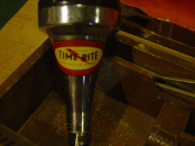

    are you using a timing plate & lite to time it ? be glad to try to help from here .. steve

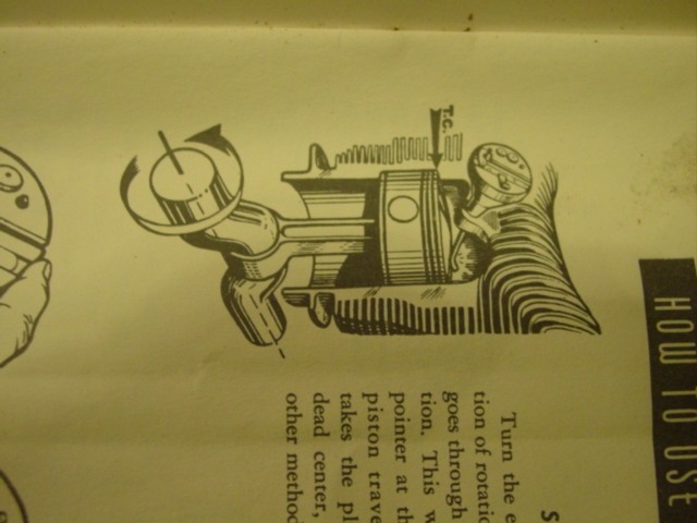

    There are several tools that go in the spark plug hole to time your motor
    I have a 'True Spark'
    These come with several offset arms to get to the piston.
    This is the tool being used on an aircraft engine but you get the idea
    To obtain True TDC you must rotate the engine one direction then the other and divide the distance on the pully or flywheel In this way piston dwell is corrected

    At first I was using the old pin in the front cover like ol Henry. But i have now moved on to the light and plate.
