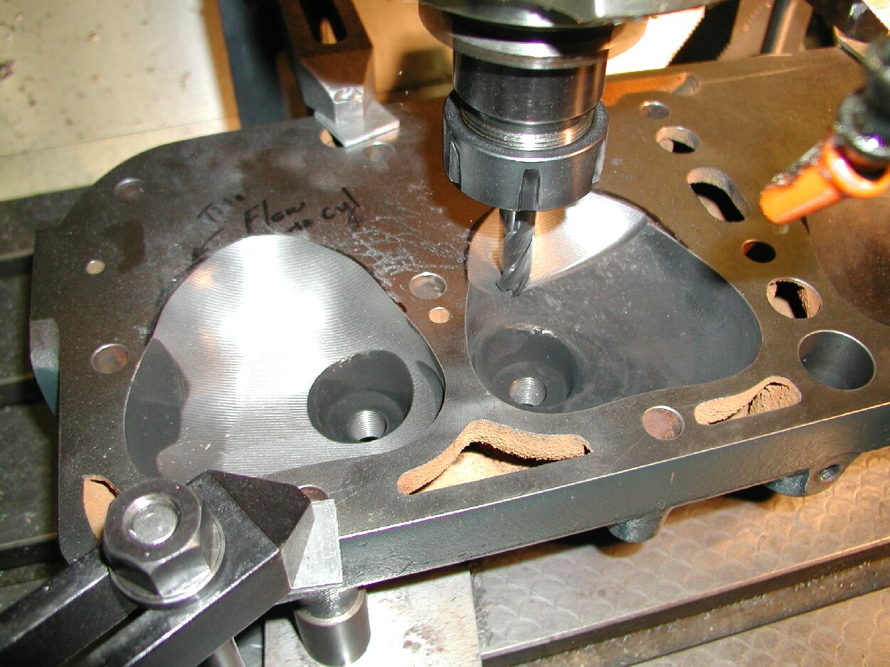

    I took a look at the earlier posts I have the Harley article a read it over. About 9 years ago I started testing different head modifications and have a new one on the drawing board that I think will perform well.
    Hear is one of the first heads I modified to get more flow in the transfer area this was 7 to1 after I was done.
    I made 70HP at 175.5 LB at 2100 rpm and 99.55HP at 153.6 LB at 3500 rpm very nice flat torque in the 1700 to 2600 rpm range 174 to 172 LB
    of co**** there where a lot of other changes to the engine like special intake valves cnc porting the bowls and ports weber 2 barrel good cam timing.
    The new head I am working on has the sparkplug in a better location and the chamber is of co**** a lot different.
    Have any of you guys out there dyno tested the heads you running and if so what HP and torque are you getting?

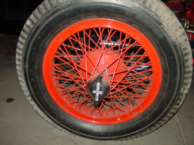

    These are the Daytons I need lock-ring, dental drive (square tooth)

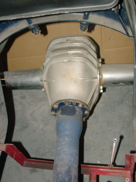

    And anyone got a spare Rearend like this??
