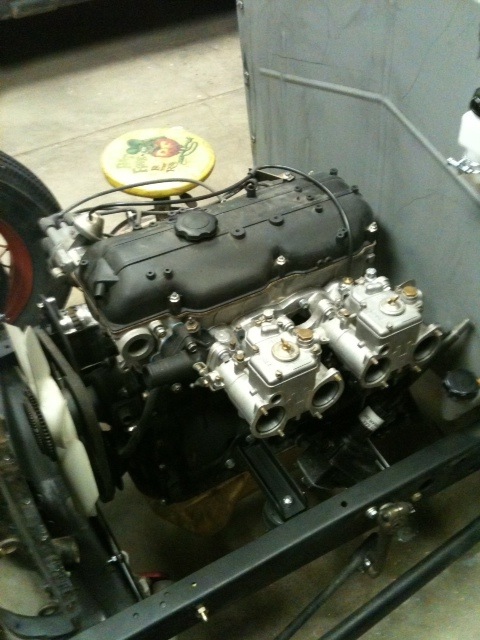

    Here's Mazda/Courier 1.8 SOHC that I'm using in a Model chassis with a chopped fiberglass sedan delivery body. Transmission is an aluminum 4 speed. Image 1.jpg

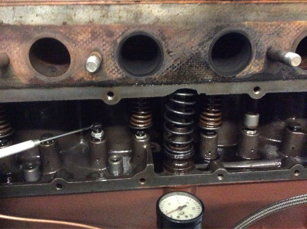

    Lifters! Which should I use? I have double lockers in the car but a new cam is going in and I think I should change over to the wider foot single lockers or maybe re-worked Chrysler. The cam is a Breirley M24/1R, a 4 Port/Winfield grind as I understand. ImageUploadedByH.A.M.B.1453089448.195034.jpg

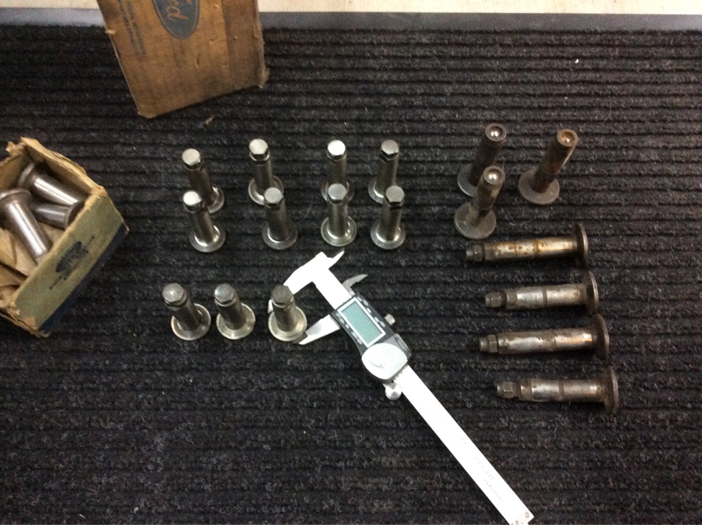

    An assortment of lifters I have. Single lockers in 2 diameters, 3 Chryslers setup for OHV and short & long Chryslers. ImageUploadedByH.A.M.B.1453089570.433088.jpg

    I personally go with the Chrysler lifters when possible then I never have any limits on future cam chooses

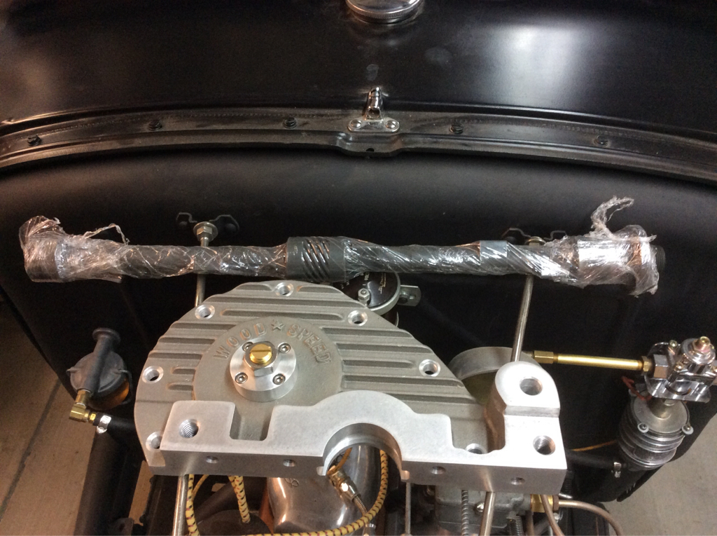

    Pretty timing cover!!!

    if the motor is still apart , be sure to cut the lifter blocks so you can adjust valves without all the rotating & guessing .....

    What are those Chrysler lifters out of originally?

    I thought I did that but that was 20 yeas ago. My gosh those things are a pain to adjust. The motor is in the car and I was trying to do quick cam swap. I will pull the whole thing apart now.

    Chrysler flathead I have read. They are slightly larger in diameter and I have 2 types, about 5/8" longer than stock and about 1/4" longer than stock. They sure look easier to adjust. The foot is wider.

  28. Just make sure the lifters clear the cam bearing bosses. I used a diameter I found posted but in my block (A) they were still a little large and would hang up on the bosses. Just check each one as you turn them down.

  30. I have also seen the Chrysler lifters interfering with the cam bearings (on cam).
    Part of the issue is just too large, not necessary with stock type reground cams and the foot is not concentric.
    IMHO, the Chrysler lifter is needed when cam is 1 3/4" OD and over .40 lift.
    A reground cam is much smaller base circle and the 1.1 lifter is fine.
