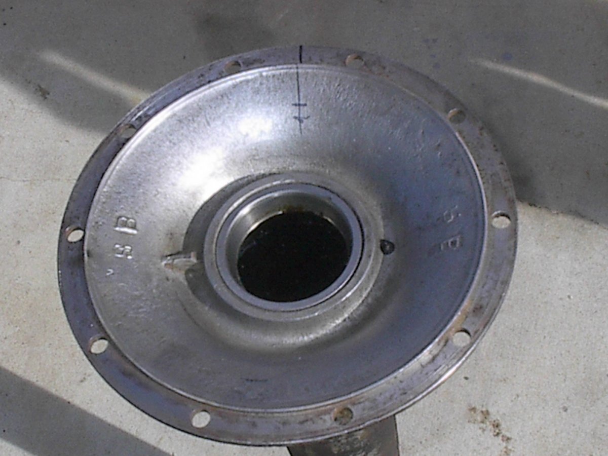

  7. Somewhere in the past, there was a tech on installing a brass snubber through the bell of the axle housing to keep the ring gear from flexing. Seems like it was simply a length of thick wall tubing welded in, threaded, with a brass bolt screwed in against the ring gear.
    Dannerr likes this.
