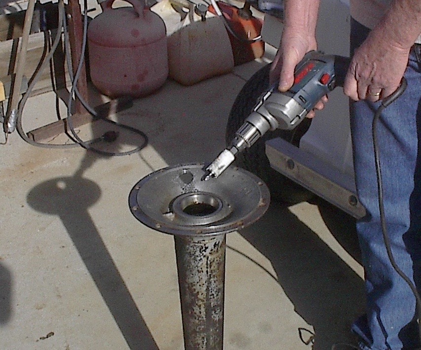

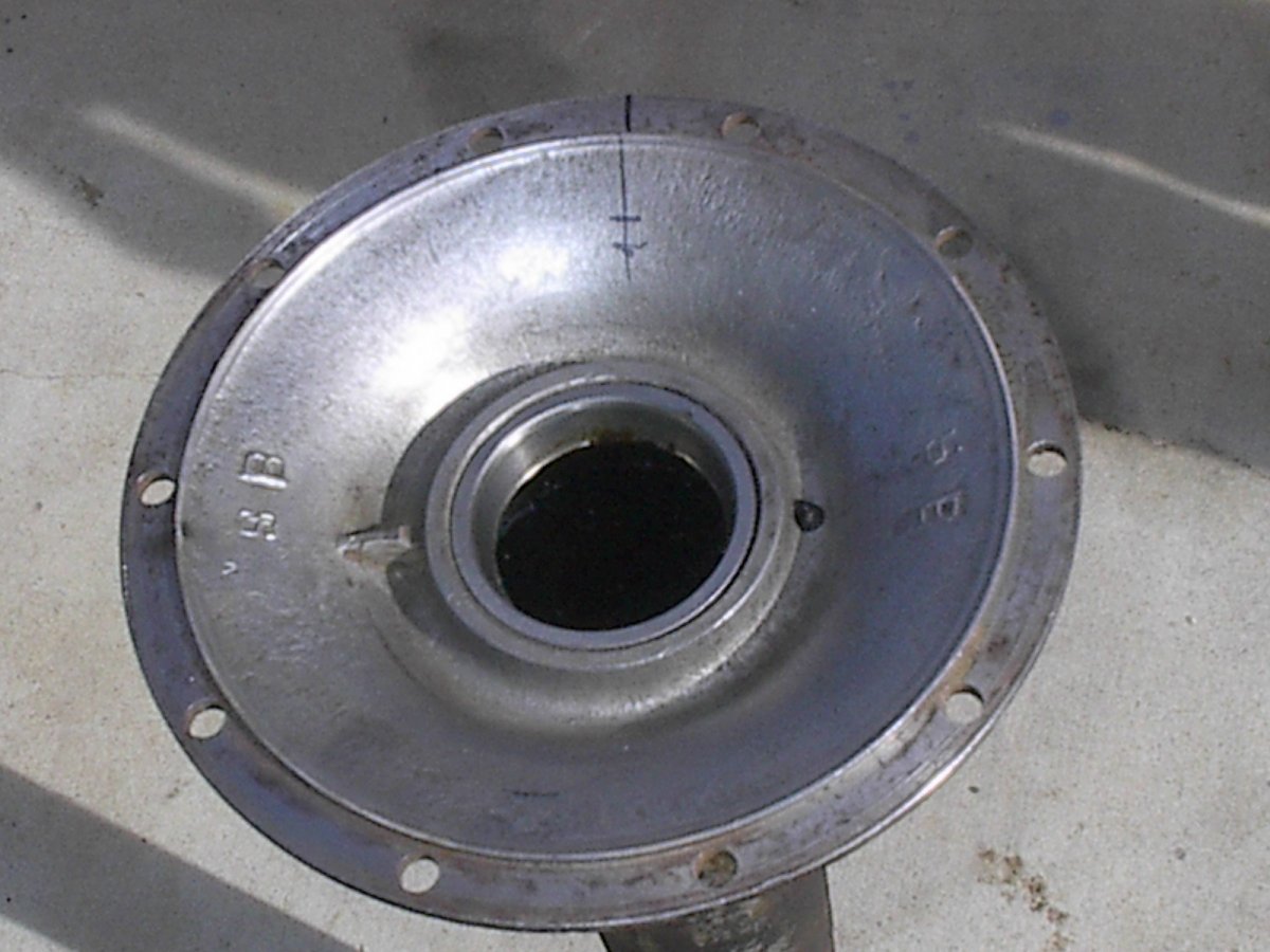

    A lot easier is to make an aluminum seal housing to bolt in place of the torque tube--seal ID to suit the OD of a slip yoke that fits the pinon spline. That's what I did on my avatar car.
    Pickup part, being only one year piece is impossible to find around here.
