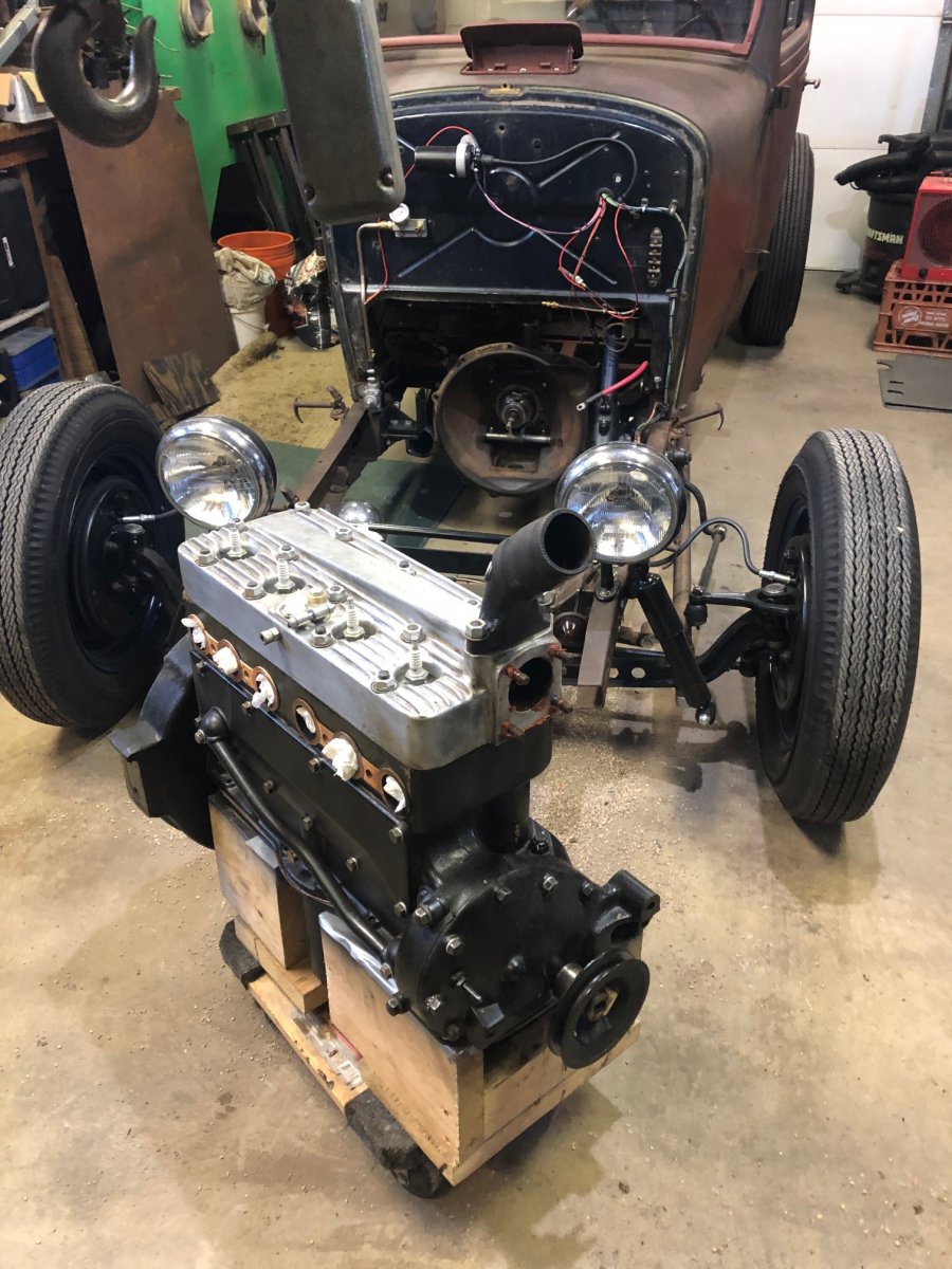

    Starting off the new year getting stuff done.Pulling the engine for a rebuild. banger.jpg

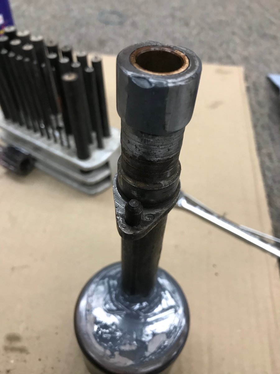

    I have filled the wide grooves (see photo) at the top of the oil pump to force oil out of the block at the factory threaded hole, through a filter, and then will return the oil back into the valve chamber through a fitting in the front of the valve cover. This should give a full/nearly full flow filtering system.
    1) How will the distributor drive gear and center cam journal get oiled as the cavity above the oil pump is now sealed/restricted?
    Is there enough "leakage" past the top of the oil pump to provide sufficient oiling?
    Will I want to carve a tiny groove vertically in the plugged portion of the oil pump to let a "little" oil past?
    Or is the distributor drive gear and center cam journal oiled from another source?

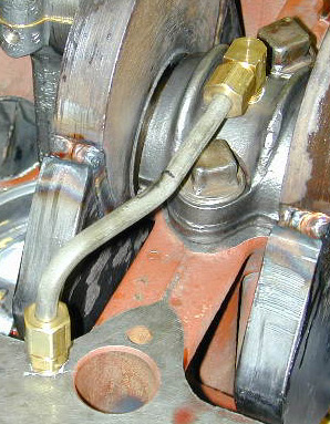

    2) While the engine is torn down, this is also a good time to add pressurized oil to the center main cap that is fitted with AER inserted bearings in a similar fashion as in the next photo.
    Would any oil bleeding off to the center main affect the effectiveness of of the oil filtering?

    Got the banger pulled out of the coupe this weekend.Now I need to decide to rebuild myself or send it somewhere.The line boring and cylinder boring are about the only things I cant do myself.I looks like by the time you buy all of the parts its about the same to have it done by a good shop. banger rebuild.jpg

    For Phred: I have put together similar oil filtering systems for a pressurized Model A and this past summer for a Model B engine. In both cases I filed a "V" in the top boss of the pump where it was filled in order to oil the cam bearing and distributor drive. I attempted to create a cross section of about 0.060" which is roughly equivalent to a sixteenth of an inch. Have quite a few miles on the A with no problems to date. The "V" would go on the side of the boss opposite the opening for oil discharge in the block. One thing I discovered with the Model B engine seemed to be a consequence of filling the entire slotted area of the boss as it appears you have done. I had issues with lower than expected oil pressure and less volume of oil flow than expected. What I discovered is that the filled slot effectively blocked off about half of the discharge port in the side of the block as shown in the photo below. The second photo shows the opening scribed on the filled boss, and the third photo shows how I opened up the discharge by filing away the portion of the boss that was obstructing the discharge port. Hope this helps you avoid any similar problems with your build.

    To oil the cam and dizzy gear, you need to mill a small groove into the lower housing it is currently sealed. Only need something like 1/8” wide by 1/16” deep.
    The oil p***age in the valve chamber needs to be plugged.
    This will force all oil out the side port in the block, through the filter, and then return to the front of the valve chamber.
    There are also modifications that can be done to the oil pump to increase oil flow.
