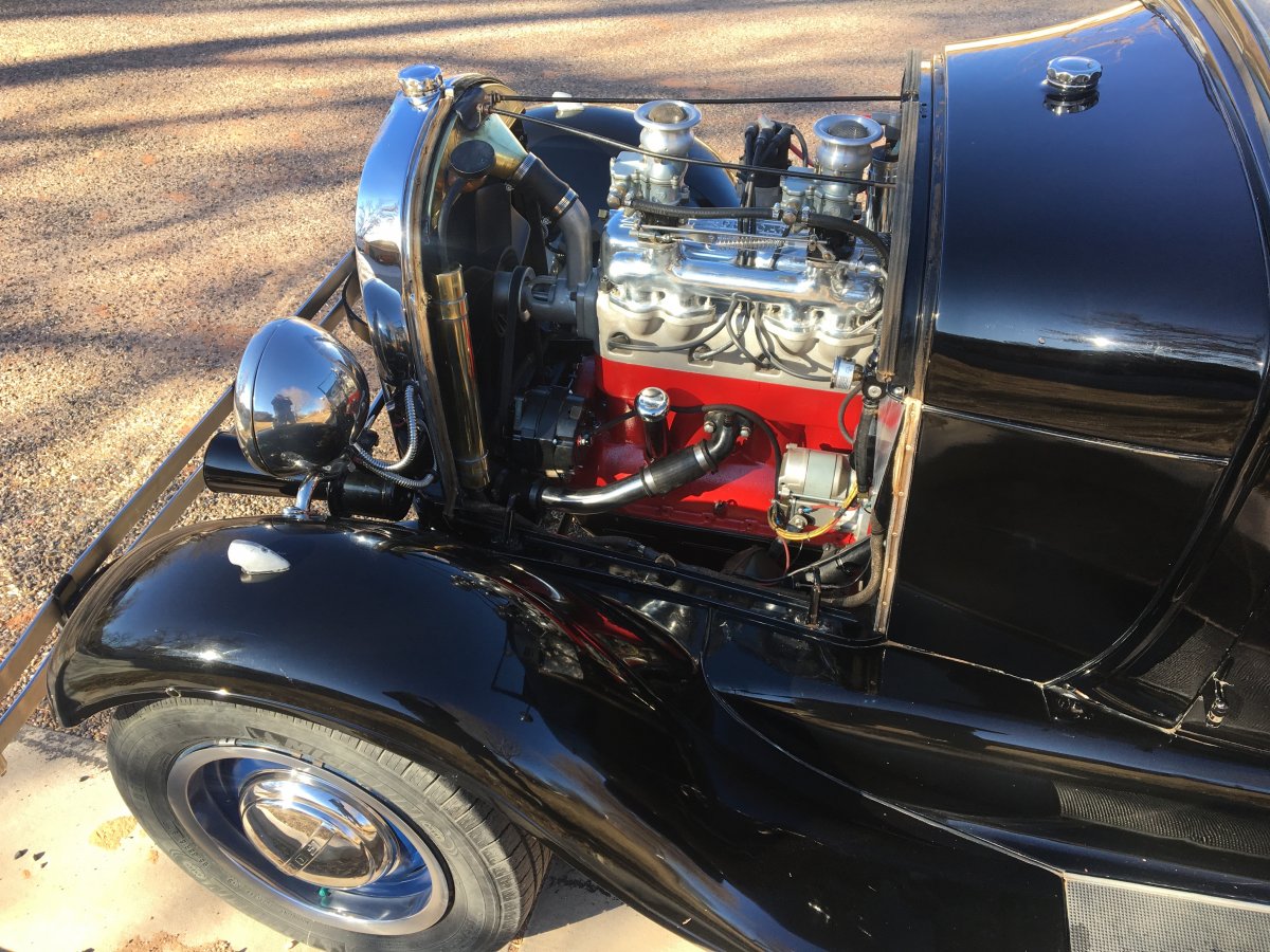

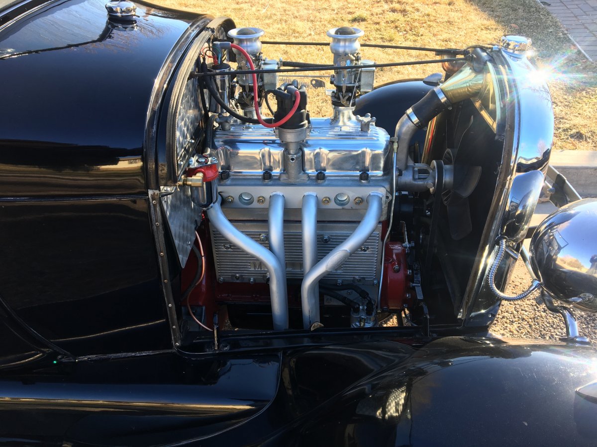

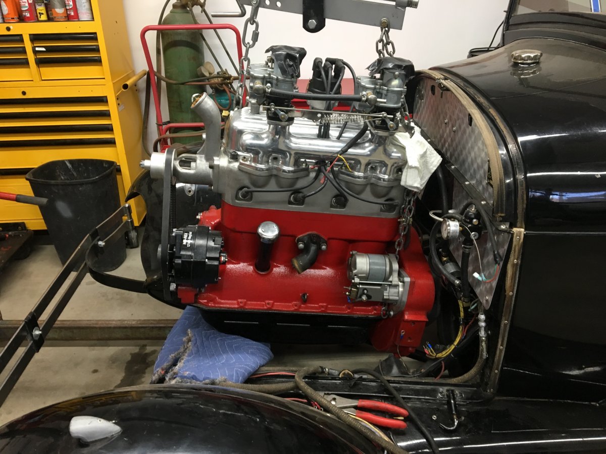

    First time ever to be ahead of schedule on a car project. Picked up the new engine from Joe at Turlock machine on Jan 4th. Drove all day on the 5th. Got the engine in and 90% done on the 6th. Finished up and running early the next morning. New engine is a B block with late counterweighted "C" crank, TM aluminum rods, 283 Chev pistons, inserted crank and rod bearings with full pressure, Dan Price Cragar with dual Stromberg 97's, FSI ignition, Red's header split into two pipes and mufflers running all the way to the back. Hooked into an F150 27% OD trans, 3.78 rear. Its a sweet combination and its good to have all of my old cars up and running. IMG_3867.jpg IMG_3872.jpg IMG_3875.jpg

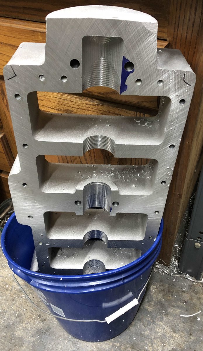

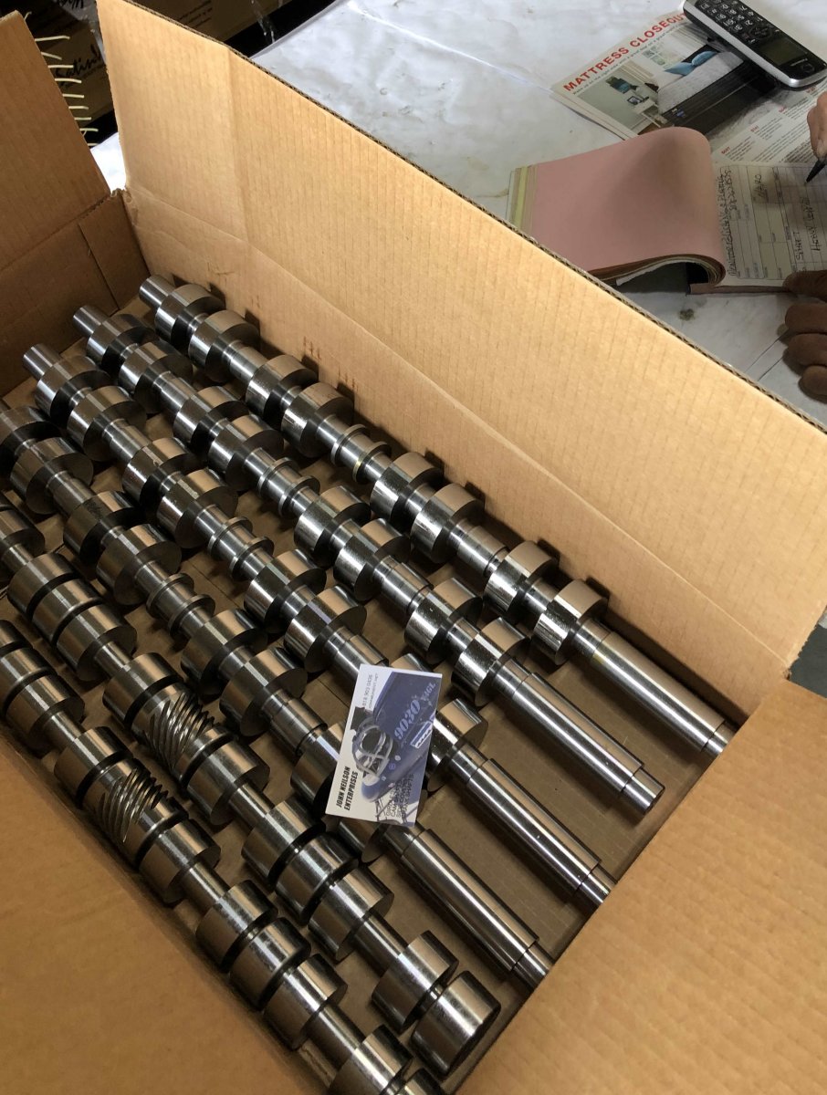

  18. Been cold outside, relatively so been in the shop
    here's a taste
    Cams out for plating then grind, new tank in coupe and girdles

    Very nice machining on the cams and the gui

    John, How thick is that crankshaft girdle?
    Thanks,
    Mike
  23. Mike,
    it is 3 1/2" thick give or take

    What kind of plating on the cams ? I have seen some cams that were salt bath nitride
  30. The37Kid
    Joined: Apr 30, 2004
    Posts: 32,450
    The37Kid
    I've seen copper plating on unmachined sections of cams, think it has something to do with heat treating. Bob
