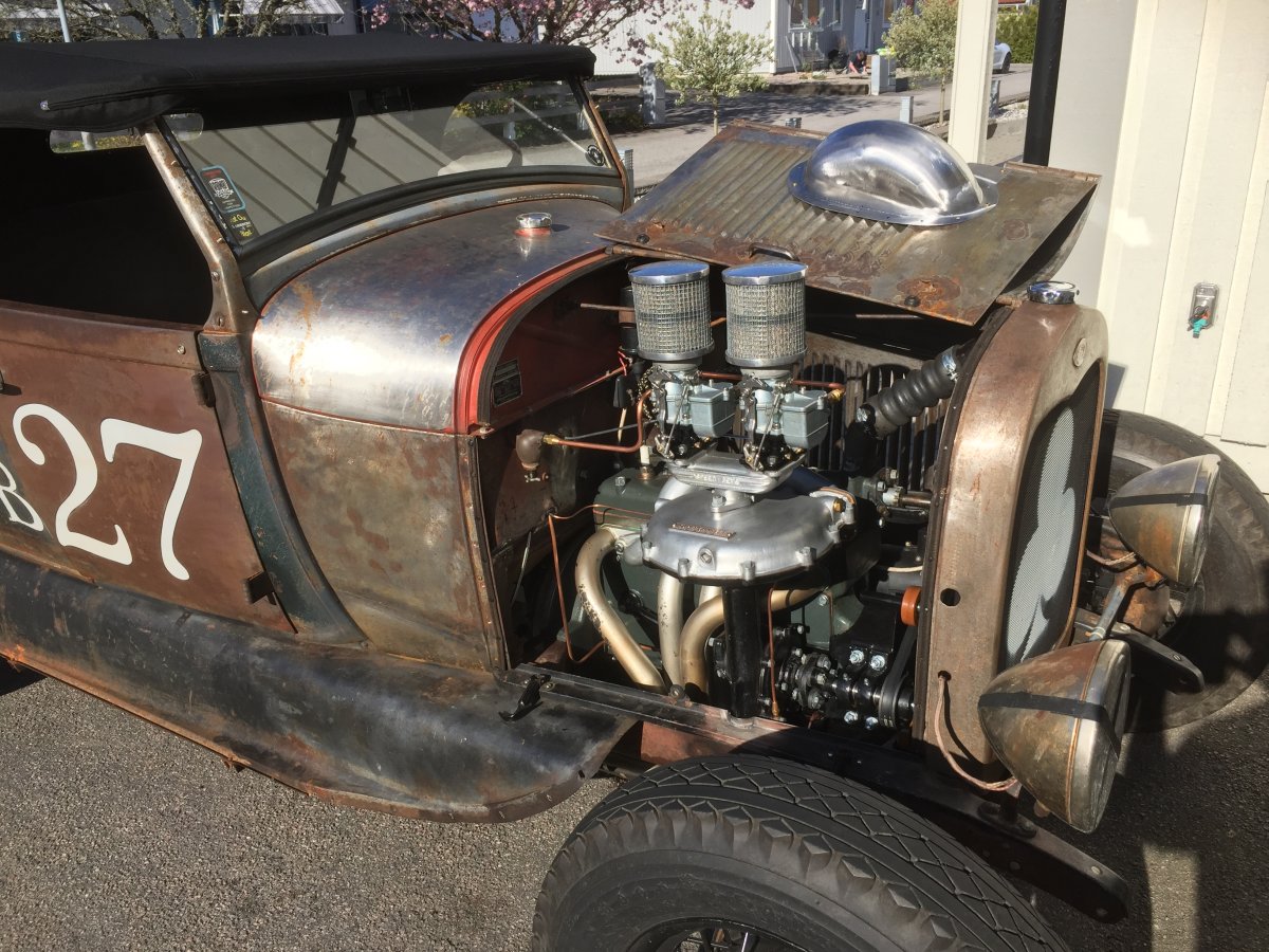

  8. two coupes
    Joined: Aug 11, 2009
    Posts: 47
    two coupes
    My Graham supercharged 1929 roadster.

  15. two coupes
    Posts: 47
    two coupes
    I have filter and a Carter electric fuelpump hidden behind the firewall.

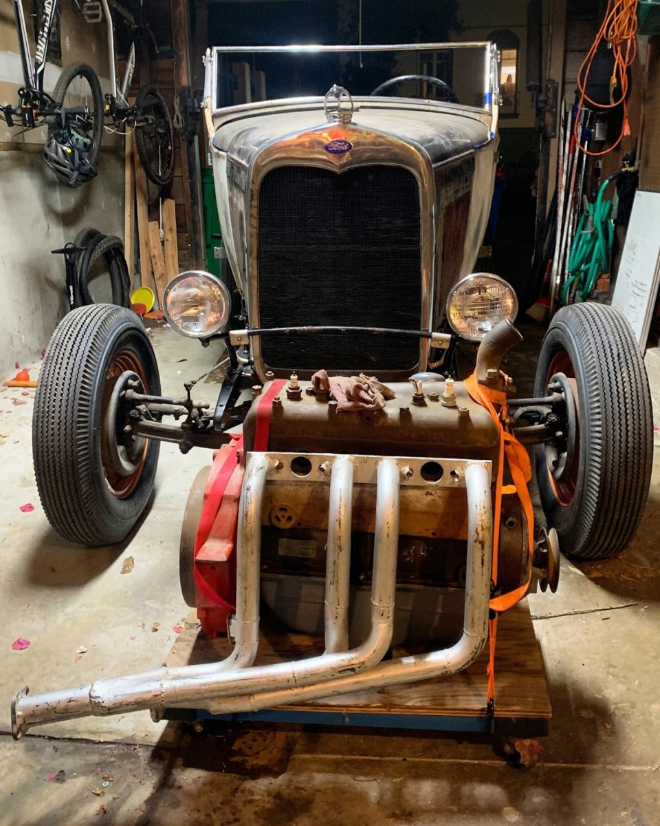

  18. J.Ukrop
    Joined: Nov 10, 2008
    Posts: 3,261
    J.Ukrop
    SUPER MODERATOR
    Hey everyone, I just wanted to introduce myself. I'm building a 'banger-powered 1930 Model A roadster in my one-car garage. I got it running with the stock setup, but I'll be converting to a Stromberg/downdraft/tube header later this winter. I converted it to 12V negative ground with a FSI. I know nothing of the engine's history, although it has adjustable lifters, runs smoothly and doesn't burn oil.
    I've been hanging out with some of you on my build thread, but I wanted to post on here to say hi. I'll most likely ask a bunch of questions along the line. Here's a photo of my car with my backup engine, which has been bored 0.080 over and outfitted with 0.30 undersized rod bearings and 0.30 undersize crank bearings. It was rebuilt decades ago and kept in storage. I believe it has not been fired in a long, long time. 16EB8152-6925-4E83-A260-5210DEEA320F.jpg

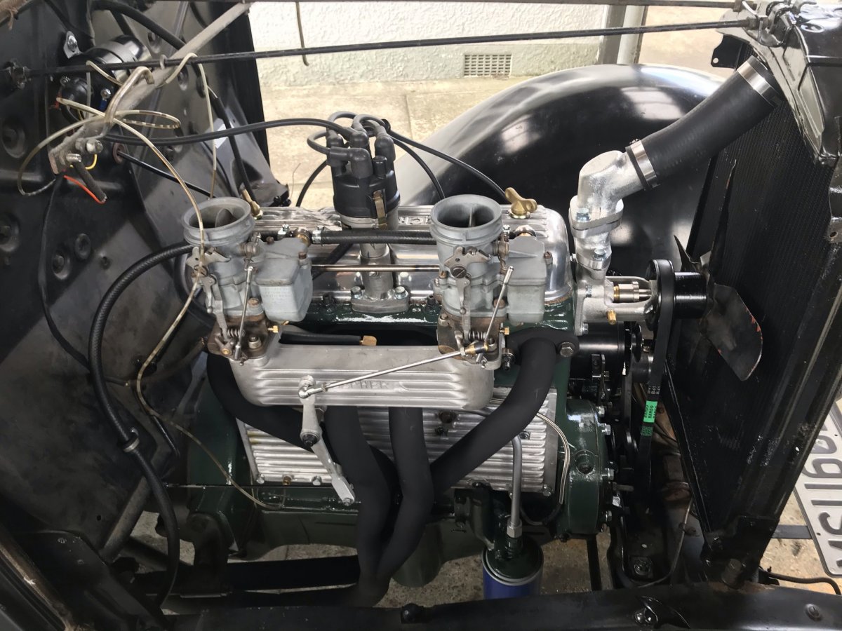

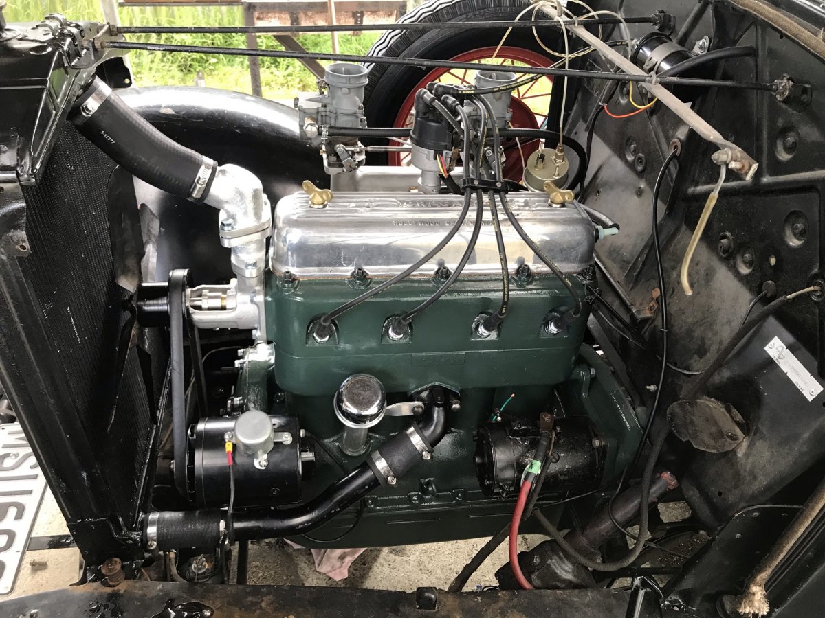

  24. Kiwi 4d
    Joined: Sep 16, 2006
    Posts: 3,713
    Kiwi 4d
    Very First fire up , obviously needs some adjustments ,tappets , mixtures ,timing etc but just running the cam in ,but its been a long gestation . My engine guys cheap oil gauge is very slow to respond. A few minor leaks to attend to. No rear main leak as yet , we fitted a 48 era Willy’s jeep rear main seal , nope would not tackle that task again, fabricating two half sets to retain the seal . Full pressure clip in bearings, scat crank ,crower rods, Chrysler 440 oil pressure relief and filter, 348 BBC pistons, crower rods, Serr head with original cragar cover , though we did port the head and clean it up some and mill the surface to get towards 8 to 1 compression . Cam ground local as the US ground one had issues with lobe variance of 5 thou which was not acceptable. Our own headers . Murray Horn damper. FS ignition, twin 81 carbs. Etc Etc for some weird reason the new Serr water pump put the pulley 5/8” too far forward so that need attention on our 32 B4. We made our own thermostat housing so any future maintenance would be easy. In fact nearly everything new or not needed modifications which towards the end got quite frustrating, and parts we “thought”should fit and paid for to fit did not. 00018995-3E9F-424B-A34C-EAC038987EBE.jpeg 278AEDD5-5E74-493F-94FF-F3F2CD52C760.jpeg https://youtube.com/watch?v=WTt9_KhXRIw&feature=share

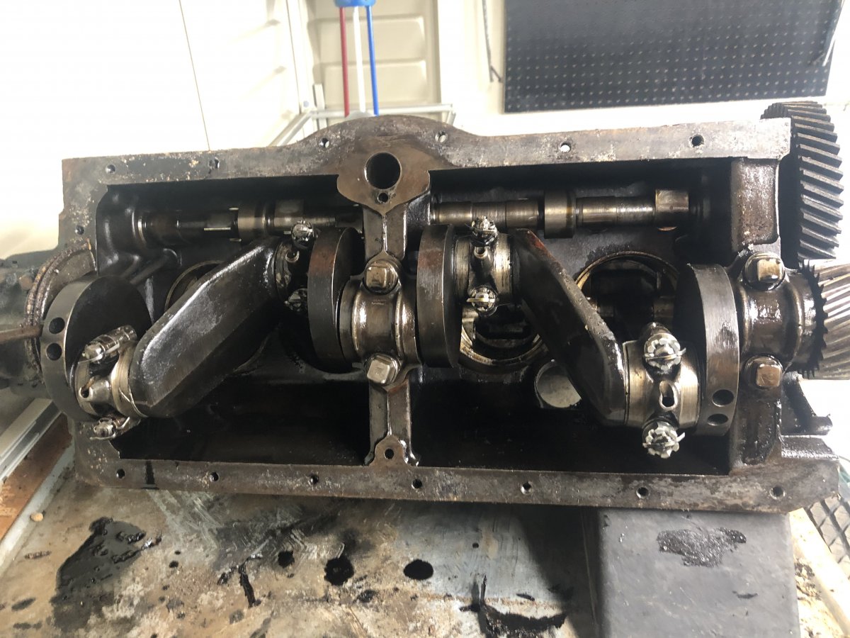

  25. Welp, bottom end is looking good, time to put this back together and throw it in my frame!
    Anyone on the west coast have a 30/31 shift tower?
