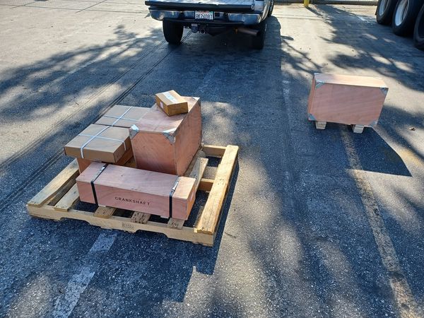

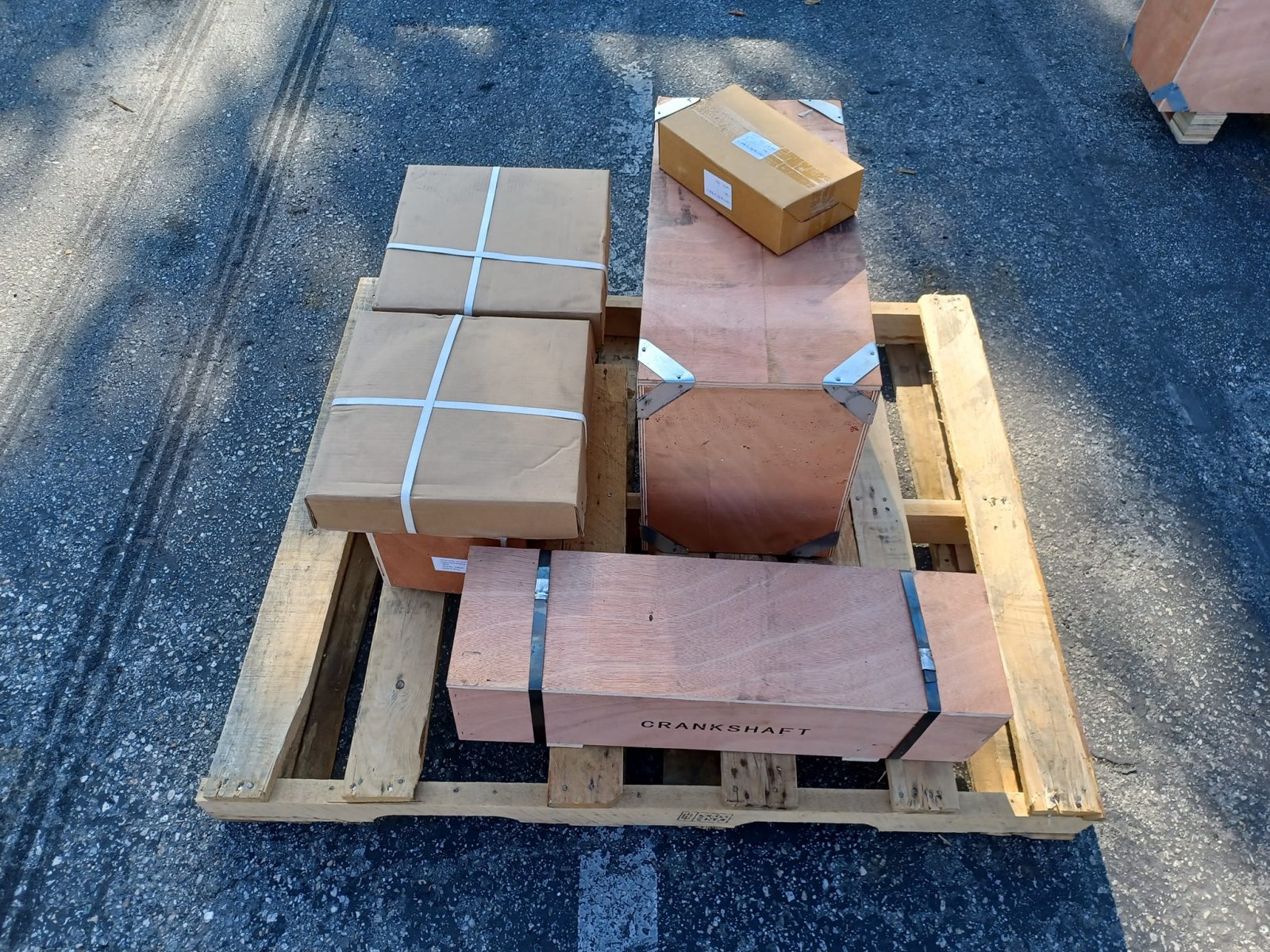

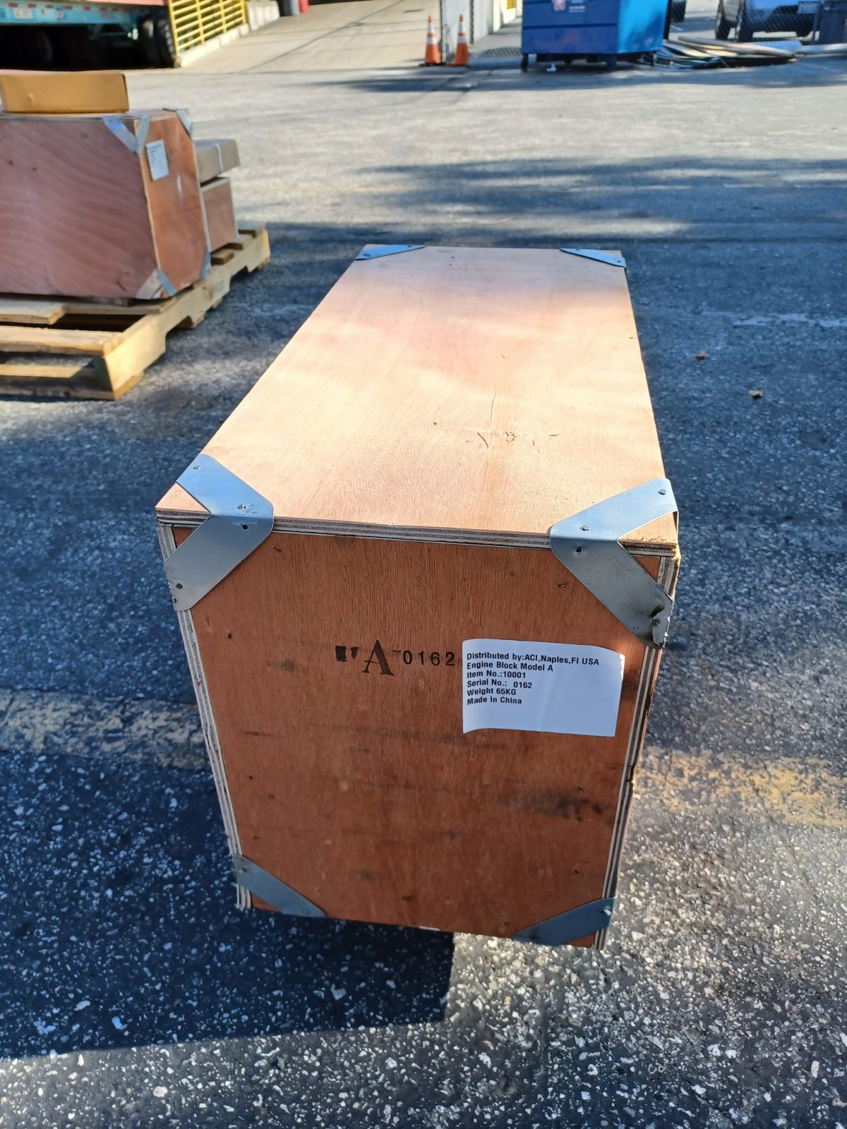

    Got my Burtz block kits yesterday.

    a much awaited delivery of some prime hot rod material @Crazydaddyo
    Enjoy the fruits of your patience.

    I got a shipping notification.
    I ran off all the help in September and closed the business so had to make alternative shipping arrangements.
    I won't see the stuff until I get back in March.
    Looks like a pretty packaging job for sure.
    Interested in seeing what's inside and how it goes together...let us know

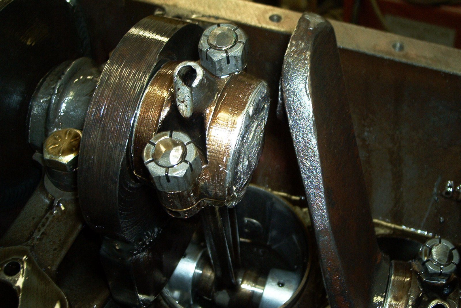

    Watch out for that early 28 crankshaft, it might ruin your day sometime.

    Eeeewwww!!! Never a good thing!
    I wonder... a common reason for T and A crank failure at the journal radius is a regrind with undersized corner radius...?

    Could be rod bearing failure, seeing as it appears babbit melted and came out of the dipper, rod seized on the crank?
    But I could be wrong. rod bearing failure I experienced resulted in rod bearing completely wiped out and rotating ***embly surviving during the short time that the motor ran as I stopped as soon as I heard the knocking.

    Why do you think it’s early 28 crank ? Motor number comes back as mid 29 and the guy claimed it was all original parts when rebuild

    Crank webs have the characteristic “beaver tail” or diamond shape. Later production had rectangular webs

    Thanks Kevin so somebody must have just went in there parts bin and pieced a motor together
    My plan was to get things running with this and build another motor from parts I have around.
  23. The fillet radius is a possibility, but if you think about it, on a .040 under crank you only have .020 potential radius to grind in. Even if you had .060 radius on the wheel, you still leave a stress riser.
    On some of the cranks we have built, the fillet is .125 and that causes other clearance issues.
    That picture shows a welded on counterweight, I would bet it broke just due to the crank being too small and over revved. Also the break is not on #4, that is where most will break trying to transmit all the power to flywheel end.

    The fillet radii of that crankshaft may have been a contributing factor, but there were other forces at work also. The week before it broke I had run my roadster pickup at the Northwood, IA F.A.S.T. hill climb, so there may be some small truth to the statement about over-revving. I freely admit to revving it as far as it would go in 1/10th mile (smiley-face). But also I had been noticing, mostly while cruising at 55+ mph a tendency for the engine to feel like it was surging or fighting with itself. After I also broke the successor to the pictured crankshaft a year later, again a week or so after the F.A.S.T. meet, I finally learned about symptoms of too much spark advance with high compression heads, and now believe that was the primary reason for the breakage. I had my distributor set up for 32 degrees of total advance and in retrospect think that my skinny Model A crankshafts were being twisted to the point of failure. The replacement crank that subsequently broke was 0.020 under on both rods and mains and had been carefully prepped and ground, and had been magnafluxed and straightened after counterweights were welded on. I was really disappointed with the longevity of that crank because I had expended quite a bit of effort to find a good core and it was prepped pretty carefully.
    Fast forward (no pun intended) the next step involved a Burlington crankshaft, McEachern steel main caps, Skokie forged rods. inserts and pressure oil to the mains. Still taking the abuse nine years later. Most importantly the distributor now has a stop at 24 degrees of advance and there has been no sign of the surge or fighting itself that was apparent before the advance was limited. I hope this explanation helps someone else starting out to avoid my experience.
    For 4bangerbob, I just finished a mild build for the 30 Coupe in my avatar. The rods from the picture in the post with the broken crank are now at work in that motor. What may have looked like melted babbit is where the stub of the broken crank dinged up the thrust face on the side of the rod. A lot of time went into weight-matching those rods, so I thought I might as well try to use them. They have also gone down the track in Northwood in 2020.

  26. Thanks for the explanation and you are exactly correct, timing can just destroy a motor, a**** other equipment.
    I broke a couple driveshafts out of the engine dyno learning that. The combustion chamber shape directly contributes to the efficiency and correspondingly the timing required is a good indictor.

    Agree 100% on chamber design; I am running a repro Winfield with the crow's foot chamber. Seems to do a good job creating turbulence and combustion efficiency.

    I follow your logic, and it makes sense... but only if you start with a perfectly sharp corner. The factory grind is somewhere between .062” and .125” radius, and a regrind of any undersize can easily reproduce an equivalent corner radius without a stress riser
    Over revving, detonation, imbalance, and harmonics couldn’t have helped the situation either...:eek:
